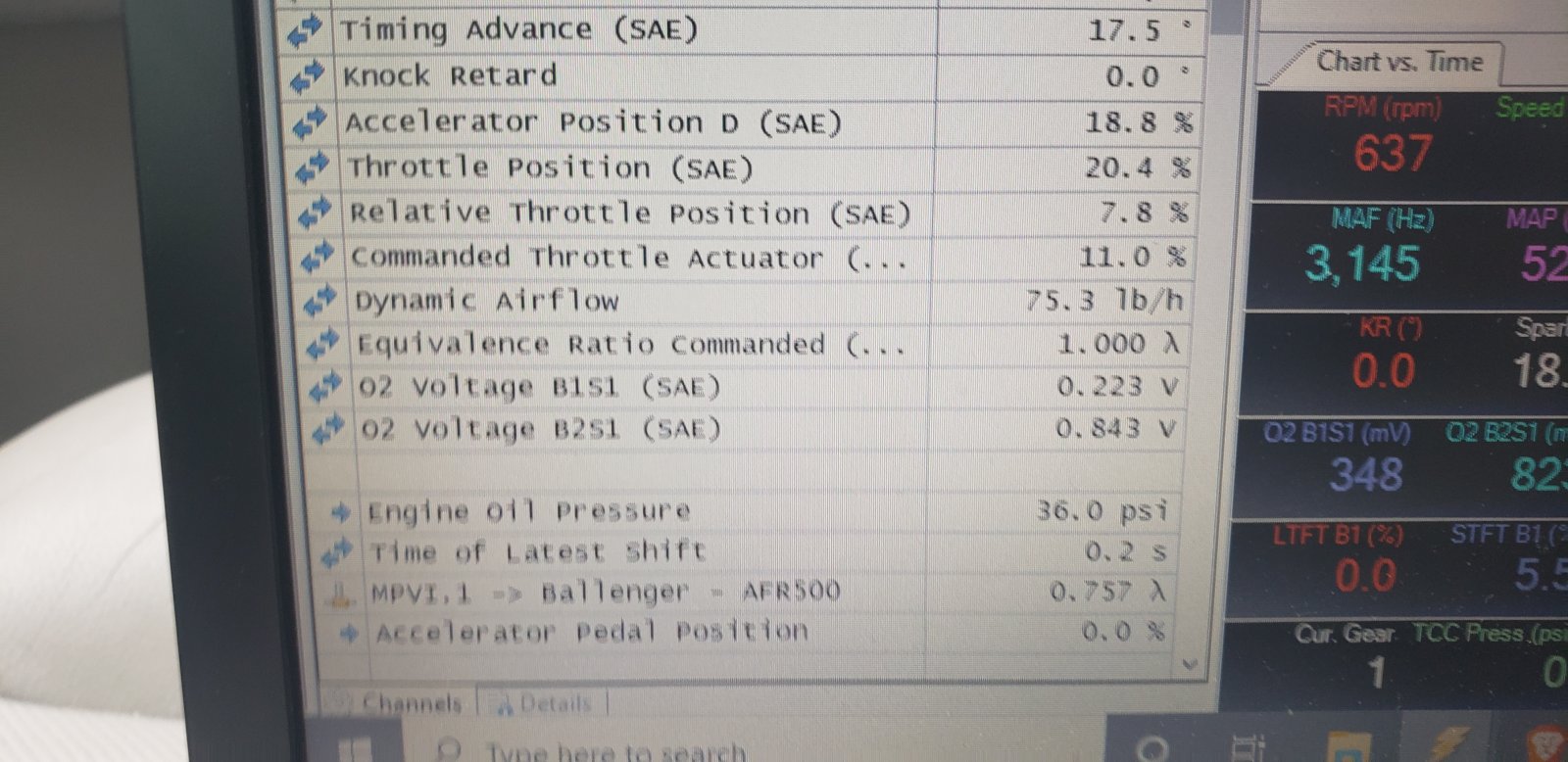

I completed the job today. Took me 15 hrs.
The engine is quiet. Oil PSI is up 15 psi fully warm. I am happy but also really pissed. Will report back on cold start tomorrow. But even the fresh start just now was quieter.

Hot oil psi was 21 with the johnsons. Means the lifter body is smaller than factory and bleeding oil pressure like crazy. I am not happy, at all.
I have done some research and Johnson recommends measuring each lifter bore before using their lifters. What casual person upgrading their cam would do this? It's a shame because you can see the craftsmanship over the Morel's is night and day difference. The Morels are not even in the same ballpark quality wise. Johnson lifters have forged body, strong snap ring instead of the thin wire on stock/Morels, etc. But it doesn't matter if it's going to drop your oil pressure by 15 psi.
I hope they work with me here, lot of money and time spent on this. I am crossing my fingers for the cold start tomorrow to be fixed!
