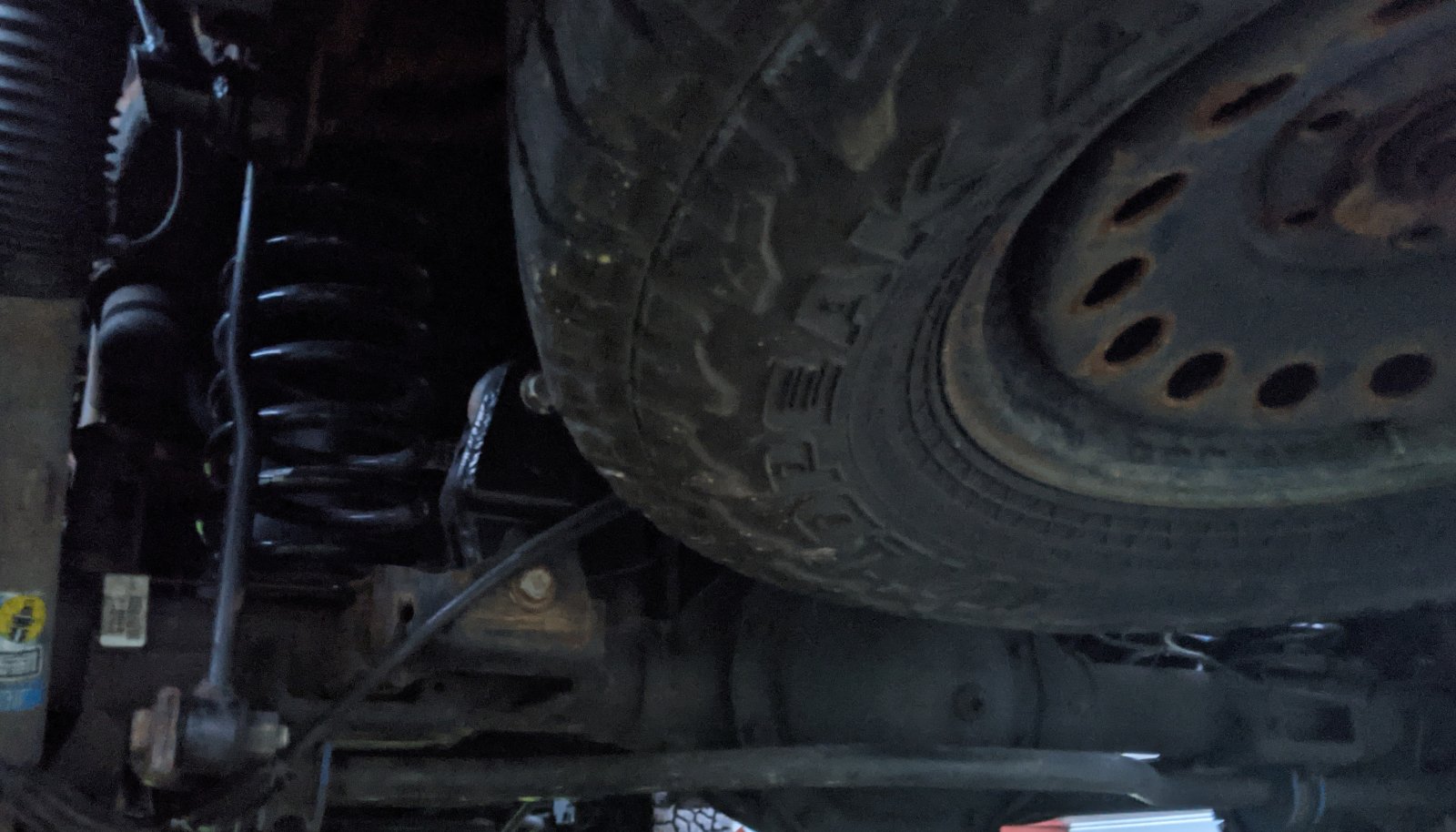

What's your panhard bar situation?
Factory bar with the lifts brackets. Fabtech brackets are a lot more beefy and bigger than the RC was but it didn't change this problem. Tried to get a quick pic of the bracket. The angles of everything are good.

Ok, so basically stock panhard bar and control arms out back? The panhard bar and lower control arms are stamped and can flex. You might be a good candidate for adjustable, solid, pieces.
45,013
Factory bar with the lifts brackets. Fabtech brackets are a lot more beefy and bigger than the RC was but it didn't change this problem. Tried to get a quick pic of the bracket. The angles of everything are good.View attachment 348857
As the others have mentioned, and as you should already know, things are gonna get hairier the taller you go due to the raised center of gravity, etc. But, it sounds like you're describing a lateral "wallowing". At that height, you have to minimize any movement other than straight up or down. This is the purpose of the sway bar and its end links and the panhard bar.
I see the axle side panhard bracket to raise the mounting position there. But is there a frame side bracket to lower that end? You want the panhard to be as parallel with the axle as possible. The more of an angle it's at, the more it can initiate a lateral oscillation when the rear end cycles up sharply, as when hitting a bump/dip. This would be worse if you hit a bump/dip on the driver side.
Also, the factory bar is stamped steel and flexes. This could be helping the situation by absorbing some of the shock rather than transferring it to the frame. But it could also be making it worse from the reduced control.
I'd get a solid panhard, like the Spohn or whatever other(s) there may be. I'd also make brackets to have the bar sit as parallel as possible.
Them extra long sway bar links look kinda spindly and could be flexing, reducing the effectiveness of the sway bar. I'd get some extra beefy links and poly bushings. A firmer aftermarket sway bar would be a nice upgrade, too.

As the others have mentioned, and as you should already know, things are gonna get hairier the taller you go do to the raised center of gravity, etc. But, it sounds like you're describing a lateral "wallowing". At that height, you have to minimize any movement other than straight up or down. This is the purpose of the sway bar and its end links and the panhard bar.
There's no lower bracket it just sits in the factory location. I have another set of end links that look a little beefier but are about an inch shorter so wasn't sure if longer meant better lol. But ill definitely check out the Spohn stuff. How hard is it to align the new panhard bar once installed? Also yeah its kind of a wallow but often also will snap me from right to left. Hard to describe.
You mean the other end of the panhard is hooked into the stock mount on the frame? I'm picturing the panhard being at a considerable angle.
As for the end links, you want the two rearward pointing legs of the sway bar to be parallel with the ground. So, however long the links need to be to achieve this is what they should be. However, if you have some links that are beefier, that one inch isn't gonna make any perceivable difference and you'd get more out of reducing the flex than anything.
The adjustable panhard just bolts in. With the stock one removed, the body should self-center over the axle (vehicle resting on the ground at ride height). Adjust the length of the bar so that you can insert the bolts and install it. Simple as that.
We can't guarantee any of these will fix your problem. We're just listing off the things we see that can contribute to instability. Address these things and you should at least see some decent improvement.

Do you have any pictures of where the rear track bar mounts to the axle? the bracket that re-locates that mount needs to be 1000% solid. If it can move, it will make the truck very unstable.
I'm planning on having mine welded into place soon as the bolts keep getting loose. I've got a 5" RC (it was originally a 7.5" but i lowered it to 5")
