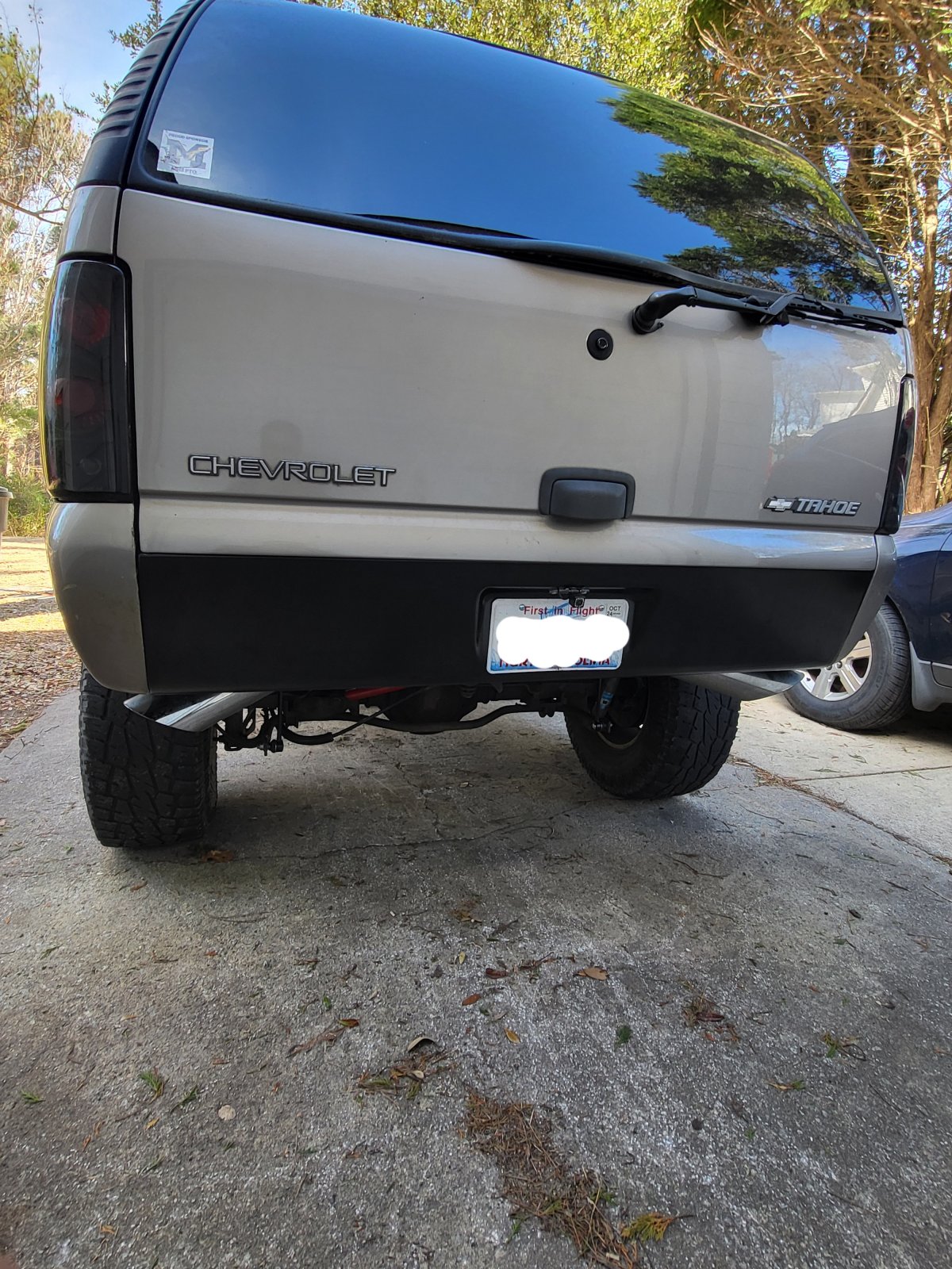

I have a 03 tahoe that I'm getting ready to install a 6 inch lift on...the problem I'm having is where can I find extended sway bar links for the rear? And I just installed a roll pan there is no way to install a hitch now is there?

Is the license plate mounted in the center of the roll pan? If so, you can use a flip down plate holder from 93 caprice or such.

Any pics of the roll pan?

You need a hideaway hitch that’ll go behind the license plate
For the rear links look for Jeep JK rear sway bar links they bolt up no issues I got a 6” lift set for my Tahoes rear
