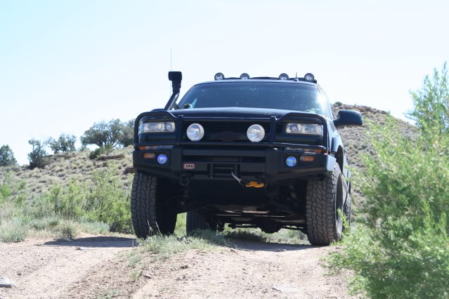

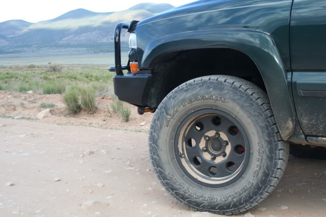

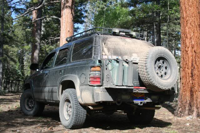

I think we need some pics... I love those beefy bumpers. lol
Ask and Ye Shall Receive.....:)
