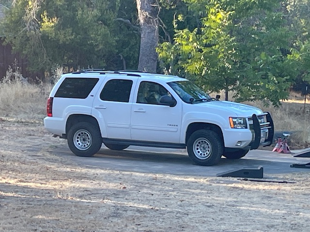

Hi, I don't have the PPV wheels, but I have 2018 sierra steelies, and they fit fine with the rough country 2" lift.
mikez71
Mar 9, 2023
3,339
4,140
17", this pic is with 1.5" level.
