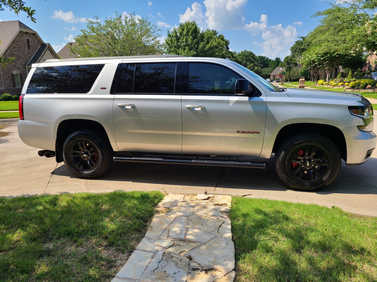

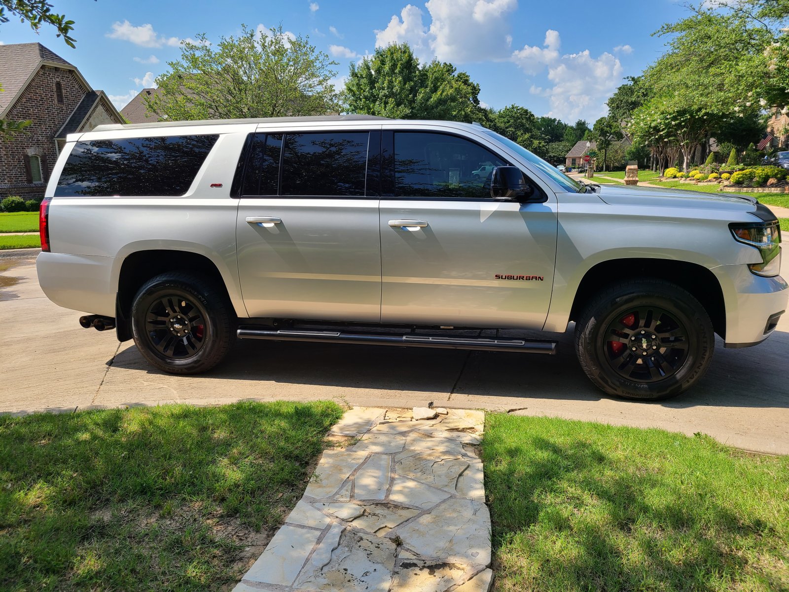

Be aware that the wheel wells are cut offset - if you make it perfectly level it will look front high. Also, the ride quality goes downhill quickly when you go over 2" level, which is why 2" is the sweet spot for levels. I was pretty happy with the 1.5" motofab on my burb with .75" dynapro rear spacers as well.
