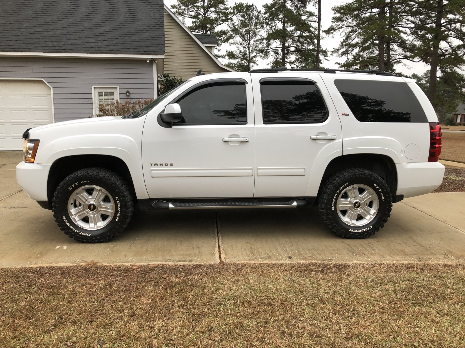

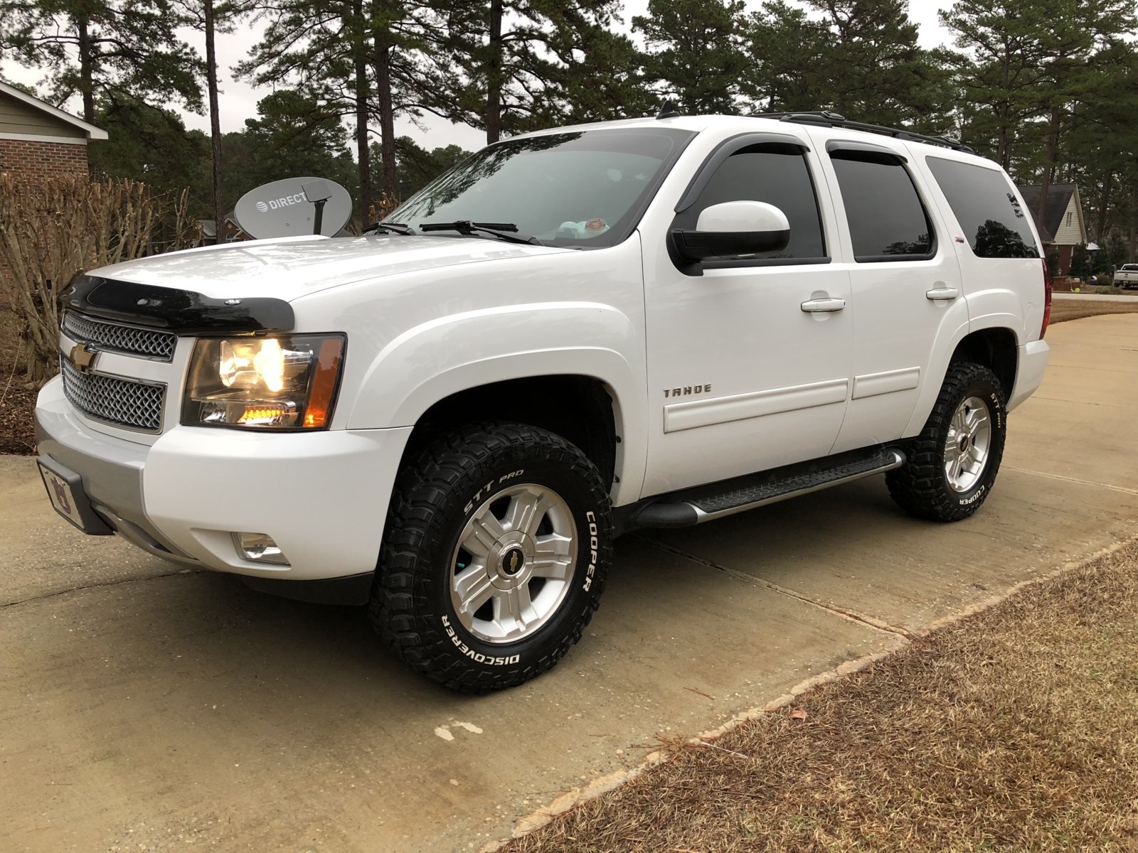

Hi, I just joined the forum. However, i have been browsing on here before joining and im glad i did. It has helped me out tremendously!
I just installed the CCM 2.5" front and 1" rear on my 2013 Z71 Tahoe and love it! I'm running 285/65r18 Cooper STT Pro's on stock wheels and it has a mean looking stance now. The tires do scrub a little in the front though. Not bad, just when turned about half way on the black molded plastic piece behind the front tires in front of the step bars. With minimal cutting it can be eliminated. Also rubs a little in front of the front tires on the plastic fender-well. Also minimal
I would recommend the level kit. To irun 35's you need a at 6" of lift. I for one, don't particularly like all the space in between the top of the tire and the top of the fender-well with a lift like that. Just my thoughts.

Good looking truck, nice stance. Would look better black tho.....lol.....;)

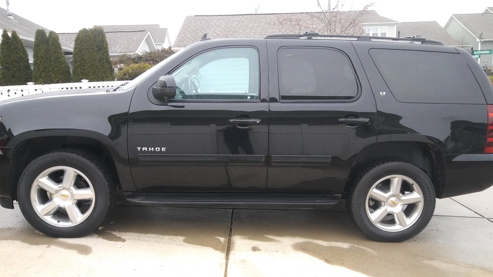

Looks great man! I like the white, Im prob going to wrap my burban either flat charcoal or just charcoal at some point. I did just a 2in front level kit with 285/70/17 and 17x9 +0 offset. I love these tires, they ride sooo smooth I cant believe it.. my last M/Ts were super loud and chunky on the road.

That looks good buddy

Thanks man! Yes go with Charcoal, and black wheels. I love the tires, i had some on my previous truck and was able to get 70,000 miles out of them, which i think is pretty good for a mt.

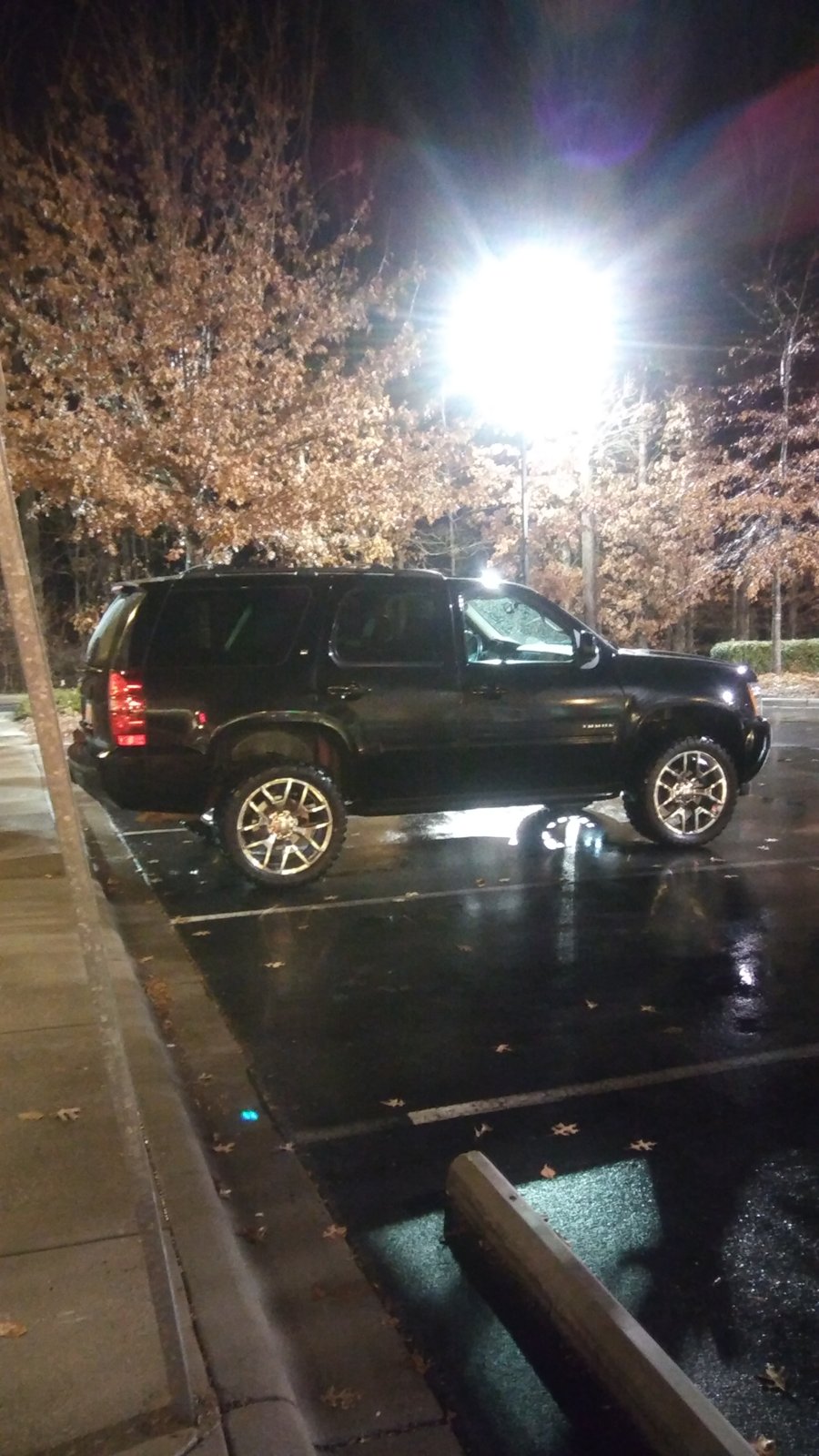

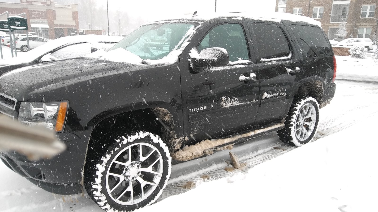

I was actually in the same dilemma, i ordered the TGC 2.5 leveling kit haven't installed it but now want to go with a 6 inch lift instead so i can fit 35s been eyeing the BDS 6 inch suspension lift.

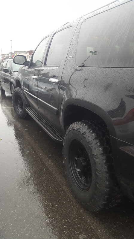

I am disappointed with my 3.5 inch lift, wish I went with 7 inch .
