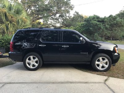

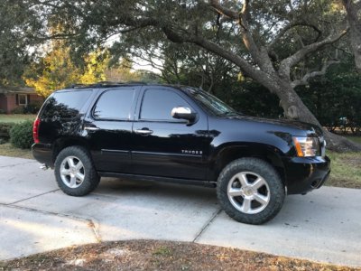

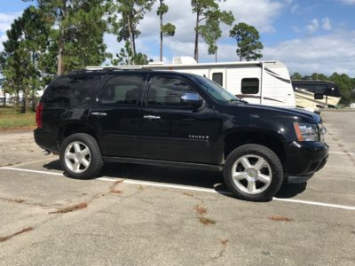

I added a CCM 2.5"/1" leveling kit on a stock '07 Tahoe LTZ and was able to fit Toyo M/T 275/65R20s. I initially has minor rubbing which was eliminated with minor trimming. If I had to do it over again, I'd go 275/60R20.
The pictures are in order: 1. stock; 2. after leveling kit install; 3. with new tires
View attachment 188808 View attachment 188809 View attachment 188810
Those are some big tires for a level
Looks good tho
