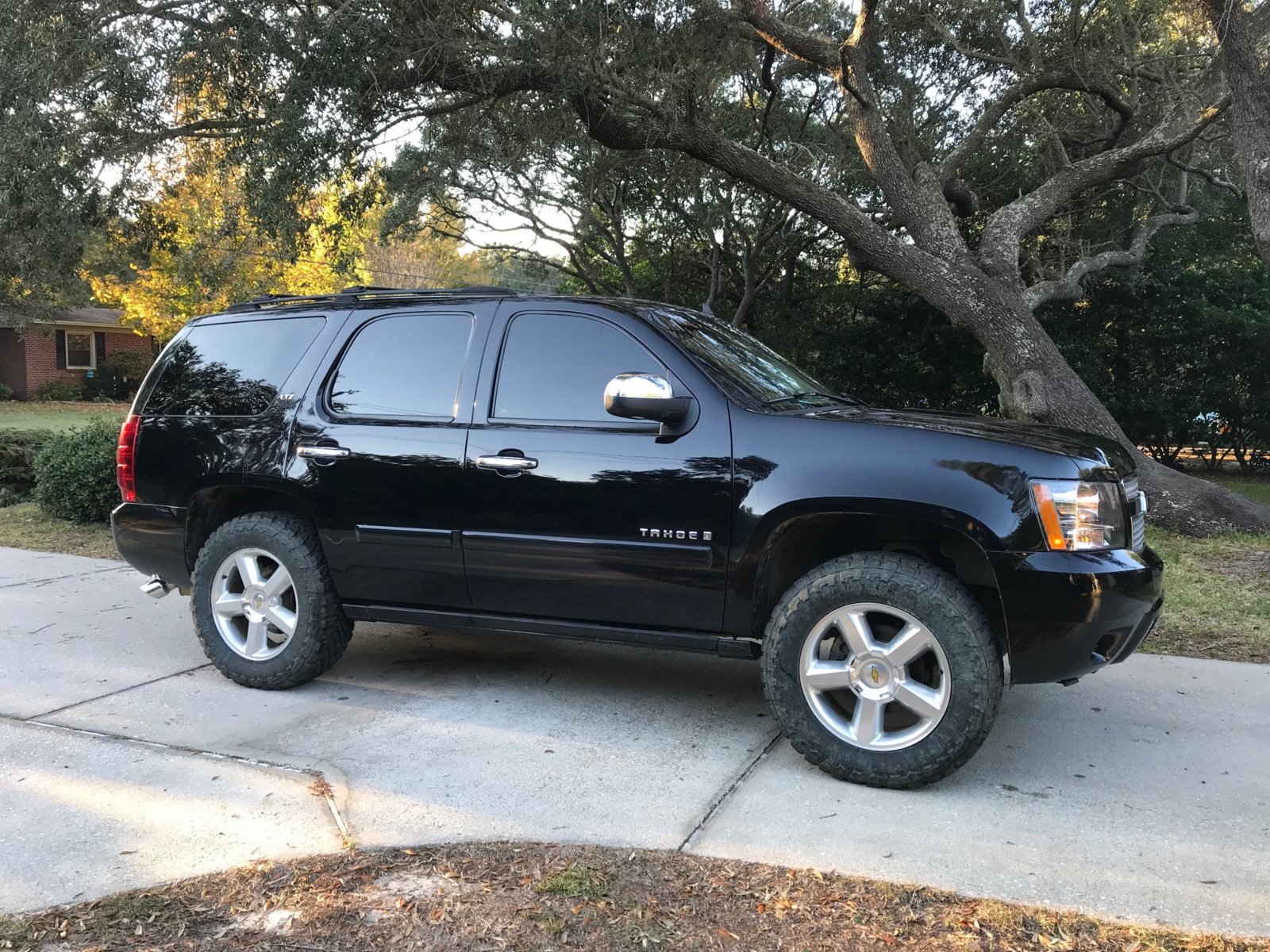

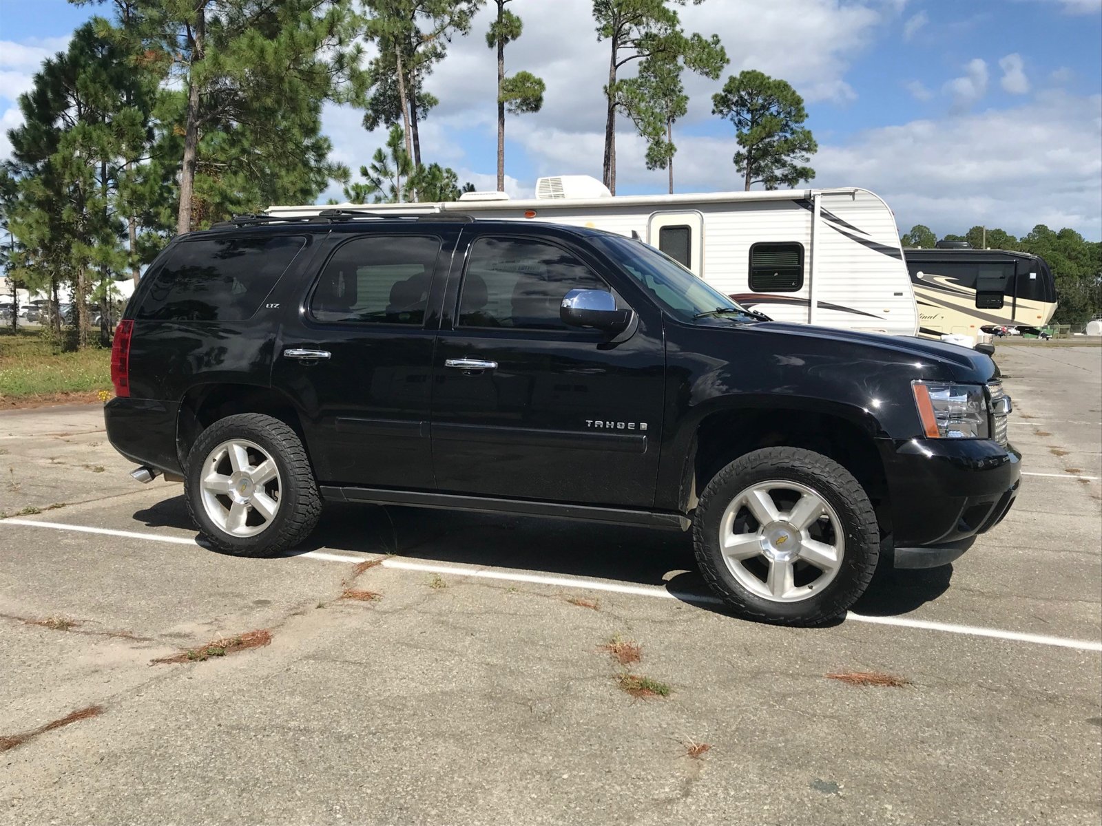

    LTZ has a nice suspension for a great ride, I'd just level it and run the stock size rubber on the 17s. Found this on the net, looks nice. I think those are 20s from a later model GMC.

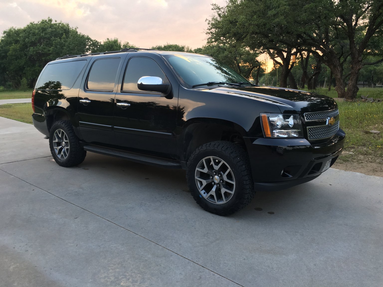

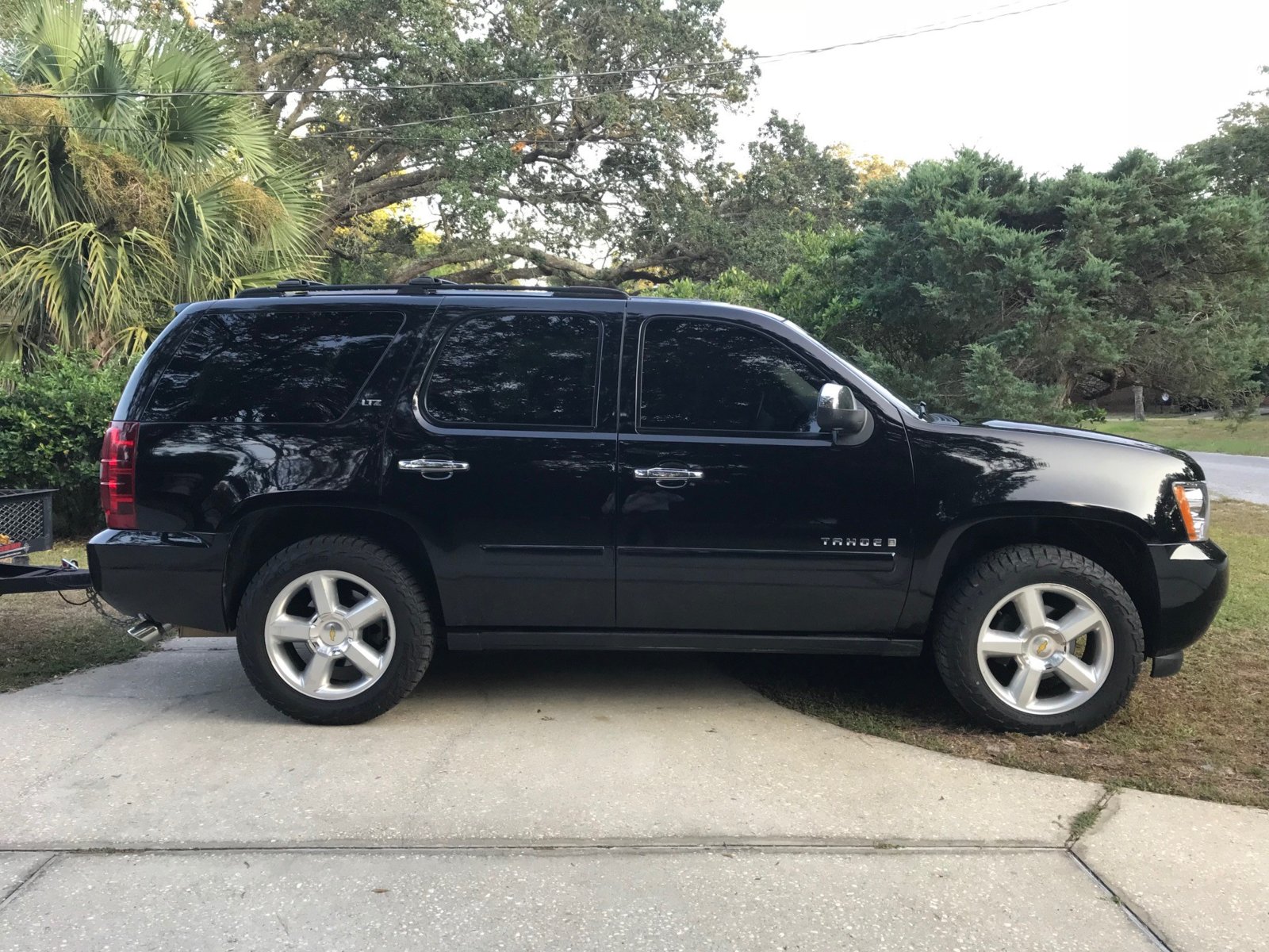

    I was on a CCM 2.5"/1" Kit and had to trim to clear 285/65r18's on my stock offset rims. Not saying you can"t completely, just going to have some trimming and a Cali Fender Mod on your hands.
    33's honestly do not look bad and will make your transmission and gearing much happier :)
    My Suburban with said lift and 33's along with my Escalade also on 33's.

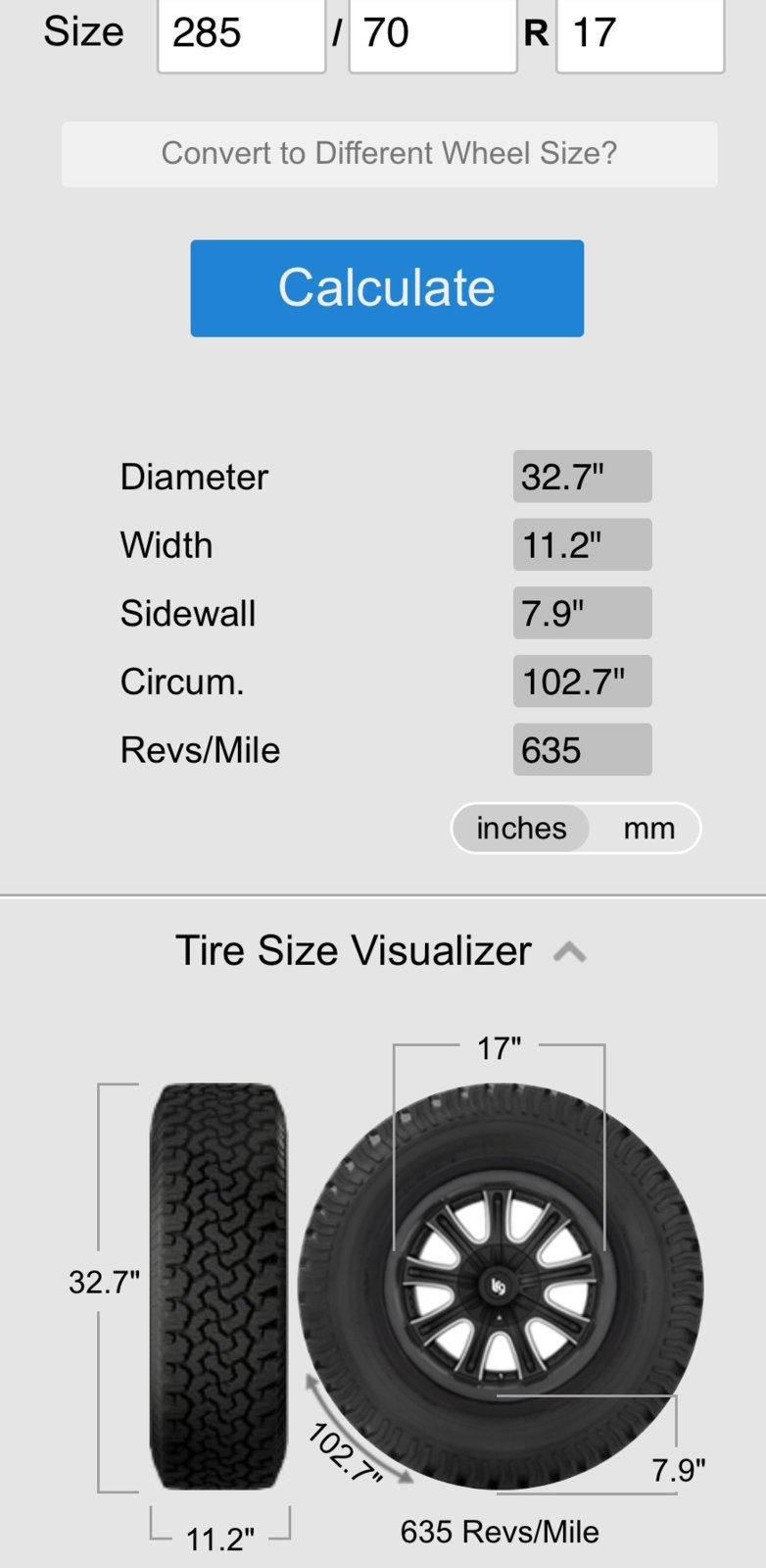

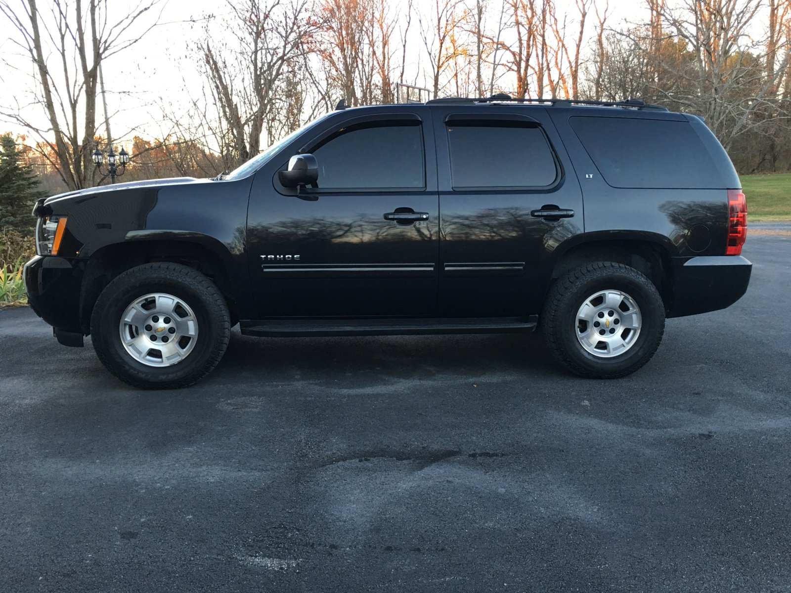

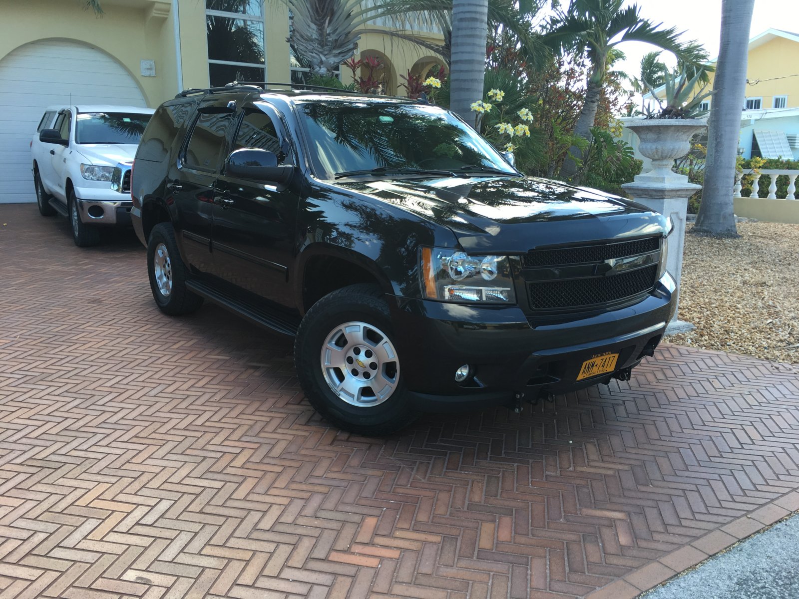

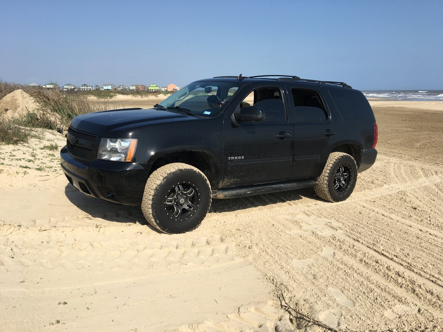

    50261151-61CE-45D0-B1F1-3AA62A343DD6.jpeg 34CFAE9B-3214-4658-8225-04BDE0C983A4.jpeg D556476F-35CE-4F9E-9AA1-C1905BABCC98.jpeg Rough contry 2” level front only, stick rims, no trimming 285/70/17 almost a 33
