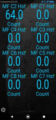

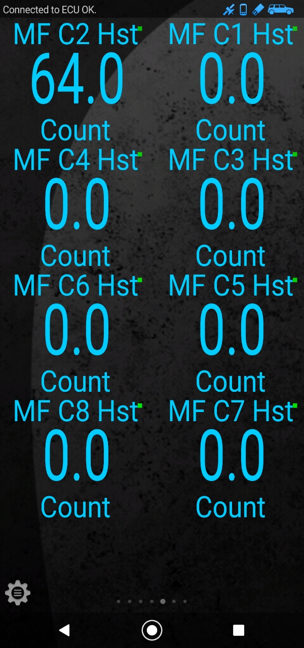

I am now getting a misfire code that I never had before. It throws a flashing engine light, and starts shifting hard into 3 and/or 4. Sometimes the light will clear itself, sometimes it wont. When I first experienced this, I was getting a P0306. Cylinder 6 misfire. I replaced the coil pack, no change. Mechanic said to try replacing the plug wire, so I swapped it with cylinder 2. While I get the same behavior, I am getting a different code. P0300 which is saying generic/multiple cylinder misfire.

Well the code changed from p0306 to p0300 when I moved the plug wire up from 6 to 2........to me, it doesnt seem that the wires should be bad this soon after installing them, but changing the criteria did change the resulting code. Why it didnt give me a p0302, I dont know, but I'm still researching here.

Got a set of ngks to pick up tomorrow morning. Definitely looks like a good likelihood that the wire is the culprit. That questionable wire that was on 6, is on 2 now and no other cylinders are reporting misfires.
