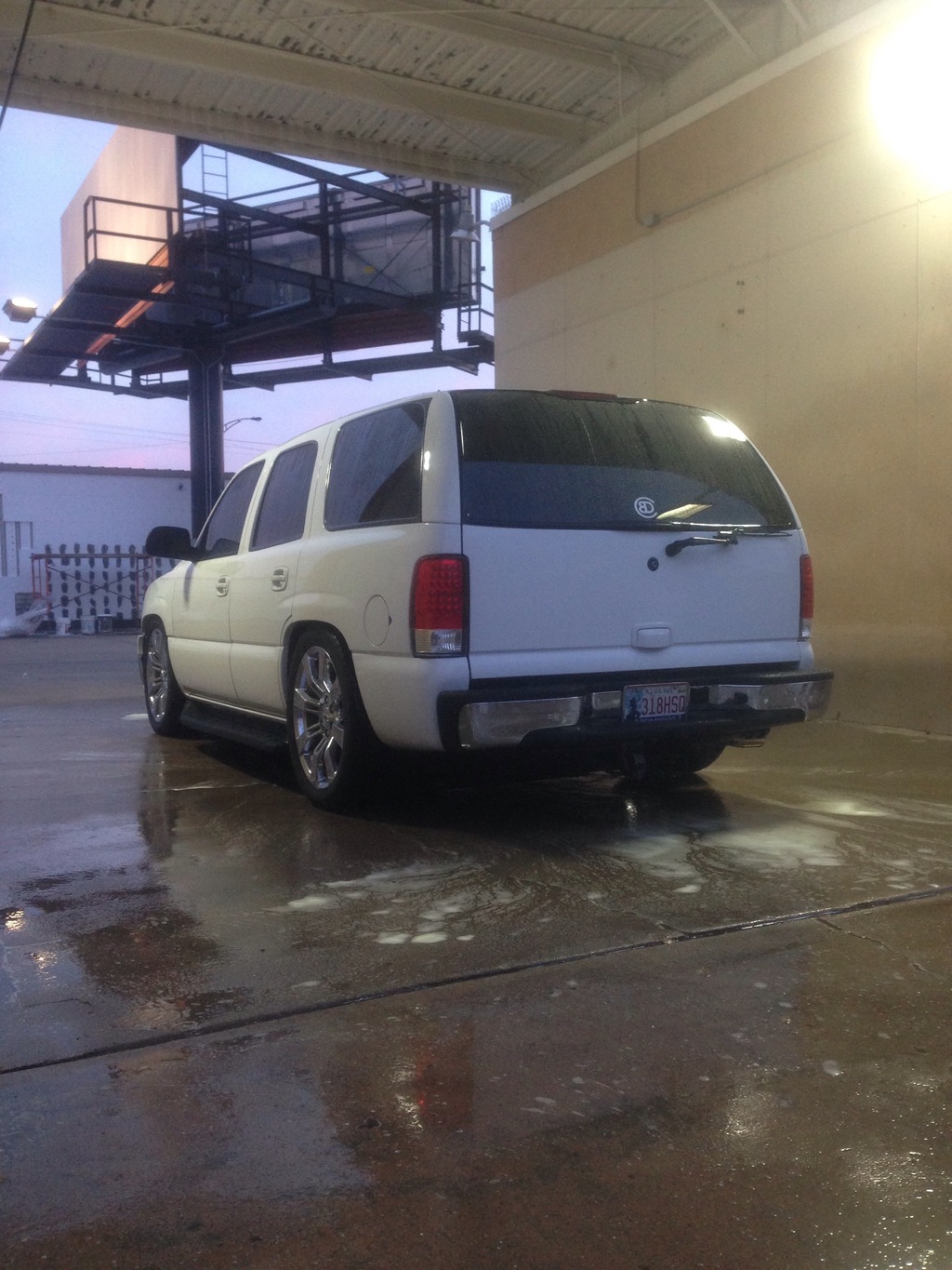

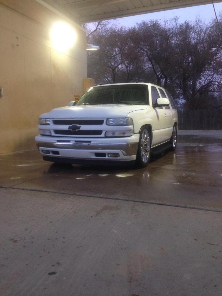

I Had his 6" rear coils with a half coil cut. This is my Old 04 with a 5/7 drop. I went mcgaughys on all the other parts (plus a belltech camber kit) because I think they are just as good quality especially their spindles. Saved me a lot of money are rode great.
His rear coils are great tho, plus they are the only 6" ones out there that I know of

Mine weren't the escalade ones they were completely smooth and they were the oem ones that I filled in and smoothed out. This way saved me money and I knew they would fit properly unlike some of the stories I heard about the street scene ones.

Man that looks good. I'm thinking about dropping the ass of my Burb a little more.

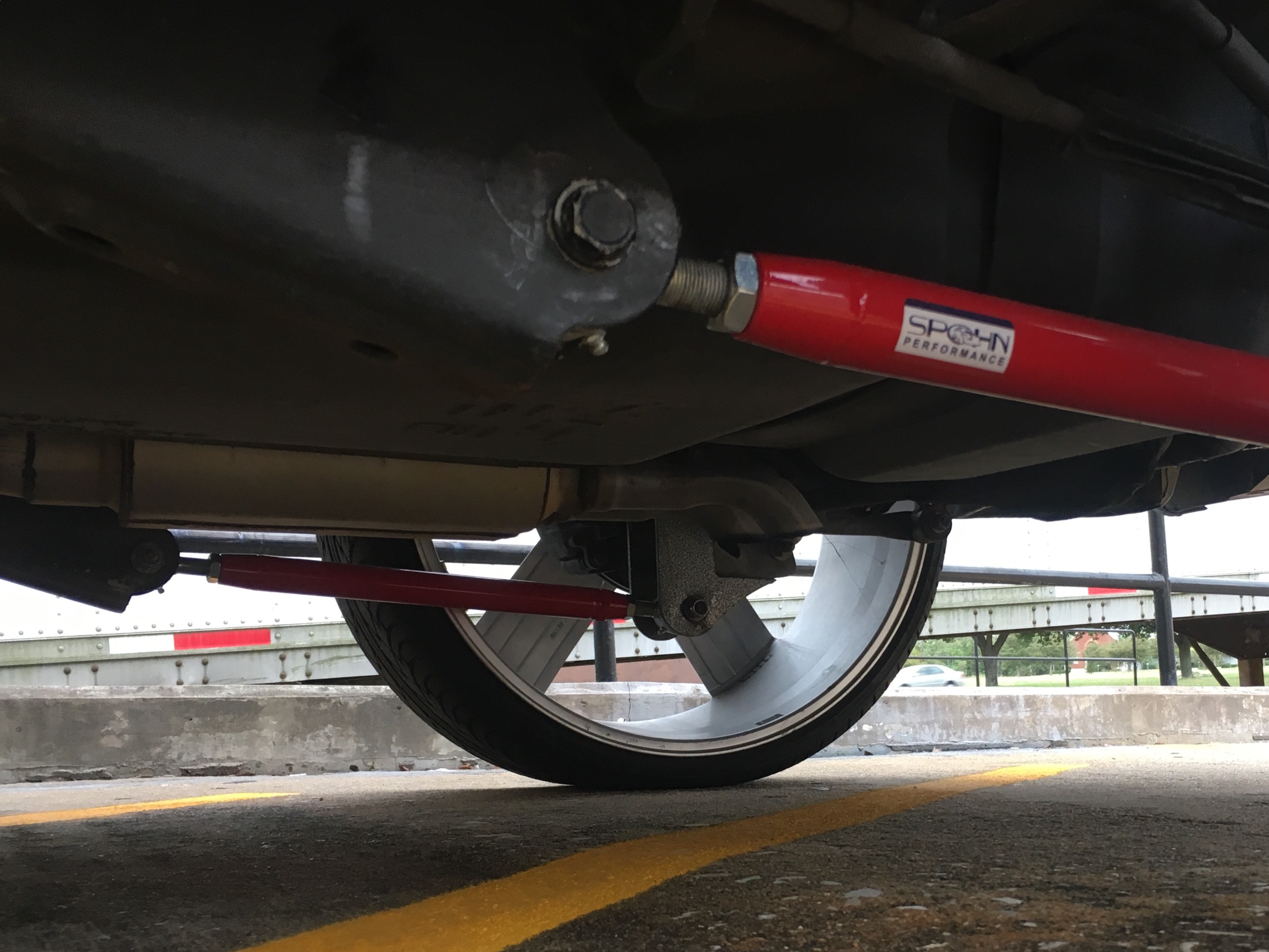

cool. Did you do uppers too? is pinion sticking down a lot?
Migo713
Mar 14, 2013
37
19
Houston
No I just did the lowers to move the wheel back a bit and clear it from rubbing on upper control arm bolt and bracket
