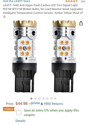

Has anyone had any luck with a Bulb brand that works?
I’ve tried LASFIT’s CANBUS free bulbs..Check Lamp popped up. So tonight I spliced in Resistors and the warning popped up again..

I used these Turn Signal Bulbs. No error and they’re bright. Still no luck with Brake light and reverse bulbs..

I may try those turn signal bulbs, those and the brake don’t look terrible. The old halogen reverse light is so ugly and dull. Somebody has to make a canbus that works with GM. I would think that the 19-21 Silverado would be similar?
