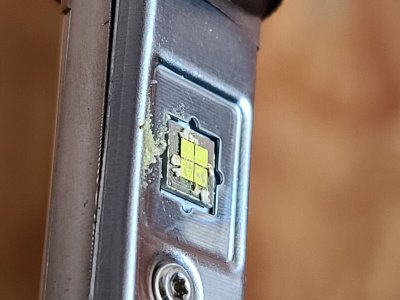

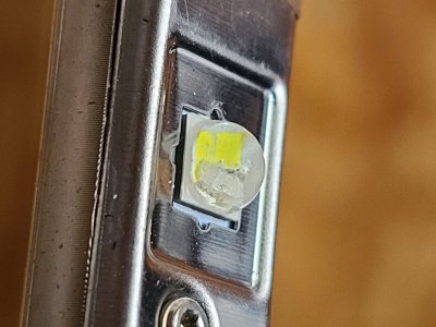

Update on the Hikari's. I had one low beam fail. The model I had aren't available any longer, I guess for a reason. The better part, the price of LED's has come way down. Instead of following up with the "2 year warranty", which I've seen mixed feedback on how it worked.....I just bought a brand with much better reviews. I will follow-up with how they are as well.
https://www.amazon.com/dp/B079KB7QX3/ref=cm_sw_r_other_apa_i_Bux7EbCS96JQ1
When I pulled The silicon lens was completely gone from one side of the light. I'm not sure what caused that, but there looks to be some damage to the substrate also. No apparent heat damage though.

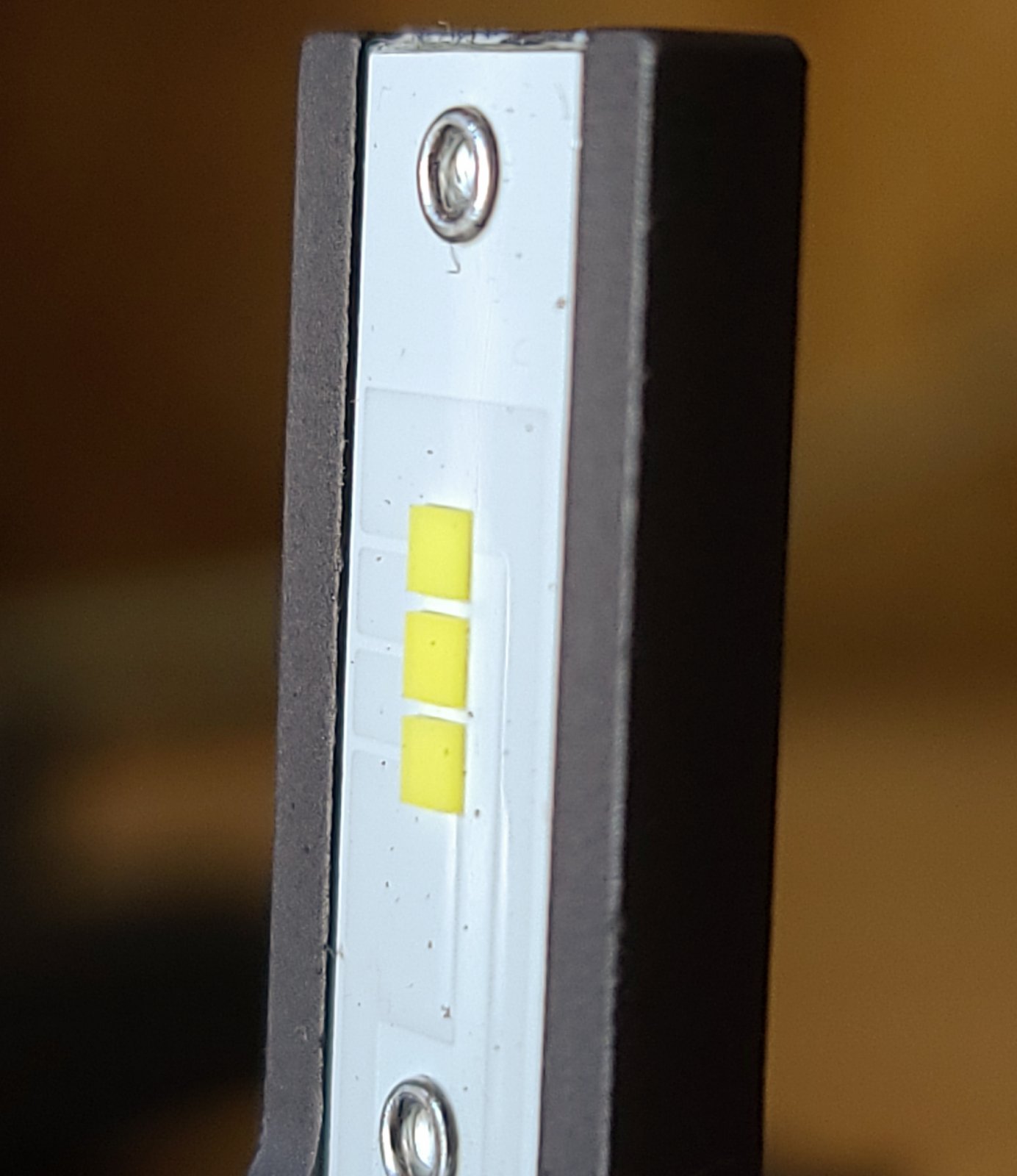

My new LED's came in today.
These are much better quality in construction. Less surface metal equals less retained heat. Also the emoled layout is much better constructed.
These will fit without having to clearance the bulkhead! I took a pic to show it.
Old on the left, new on the right.
The old style had this eye over the LED's, and is what failed on the other headlight.
The new lights
The top left corner is where I previously clearances the bulkhead when I did the HID retrofit. Plenty of room for air to circulate behind the fan and heatsink.
And the brand, just noting.
