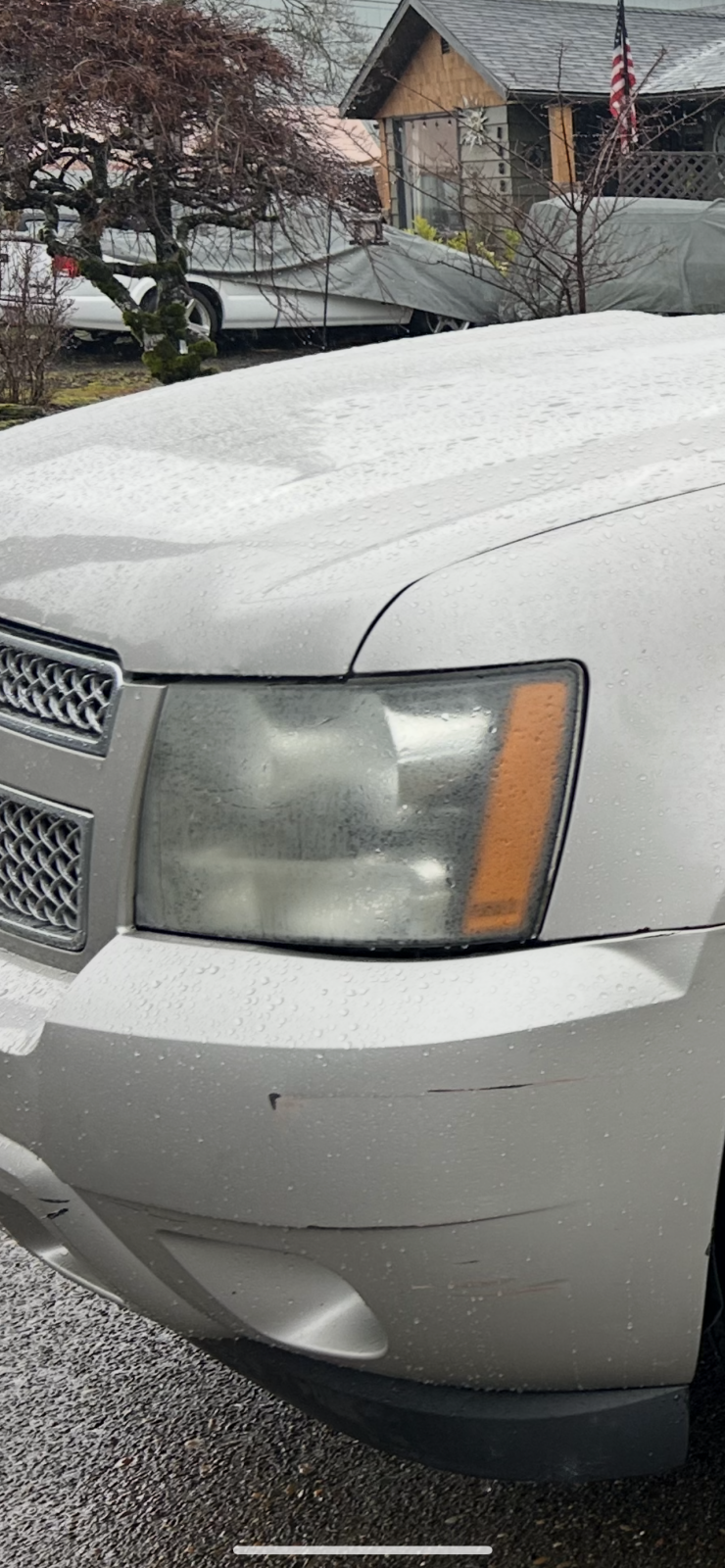

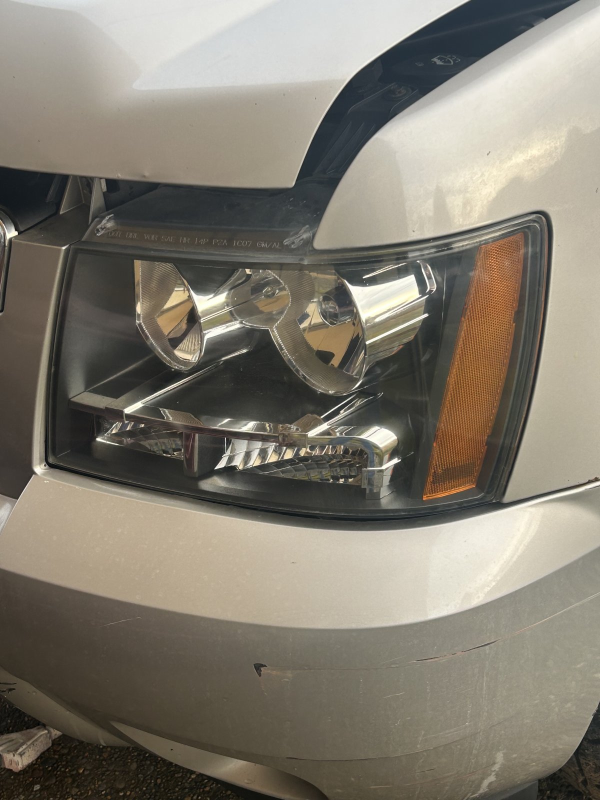

You said you had them polished, so are they just hazy? I just used the Cerakote Headlight Restoration kit on the 08 Tahoe I just bought ; the headlights were terribly hazy and they look like new now. It costs about $25 and only takes an hour or less. Super easy.

WOW! Nice job. I tried that on my headlights, and it didn't do crap. After seeing yours, I'm going to assume user error for me.

Did you follow the instructions- first the oxidation removal towelettes until they’re all used up, then wet sand with 2000 and 3000 grit, and then make sure they’re 100% dry and then wipe on the clear coat?
Edit: the only way I see it failing if you did was if there’s stuff on the inside. Obviously you can’t fix that if they did.
