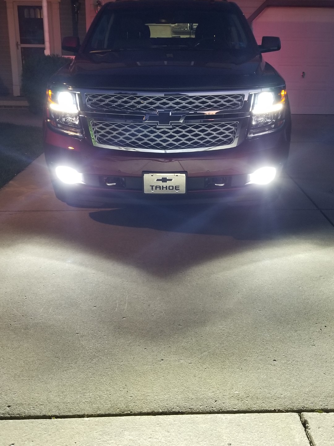

I just purchased some H11 LED bulbs and replaced the halogen bulbs in my 2018 Tahoe projectors. Although the light output is decent and cutoff/beam pattern is good, I'm running in to an interesting issue that I wanted to see if anyone here had experience with.
These LED lights interfere with the back-up camera. The image becomes shaky and grainy when the lights are on and returns to normal when they are off. No other interference with radio or otherwise.
I've tried ferrite coils on the wires and even tin foiled the dust caps to attempt to diminish the interference, but with no luck.
Is anyone running LED headlight bulbs that don't cause interference--or have you experienced this issue?
