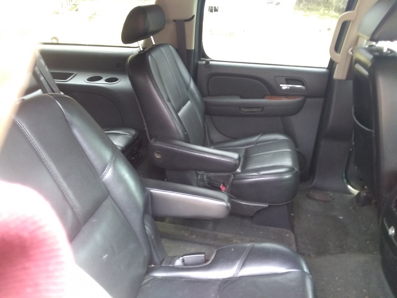

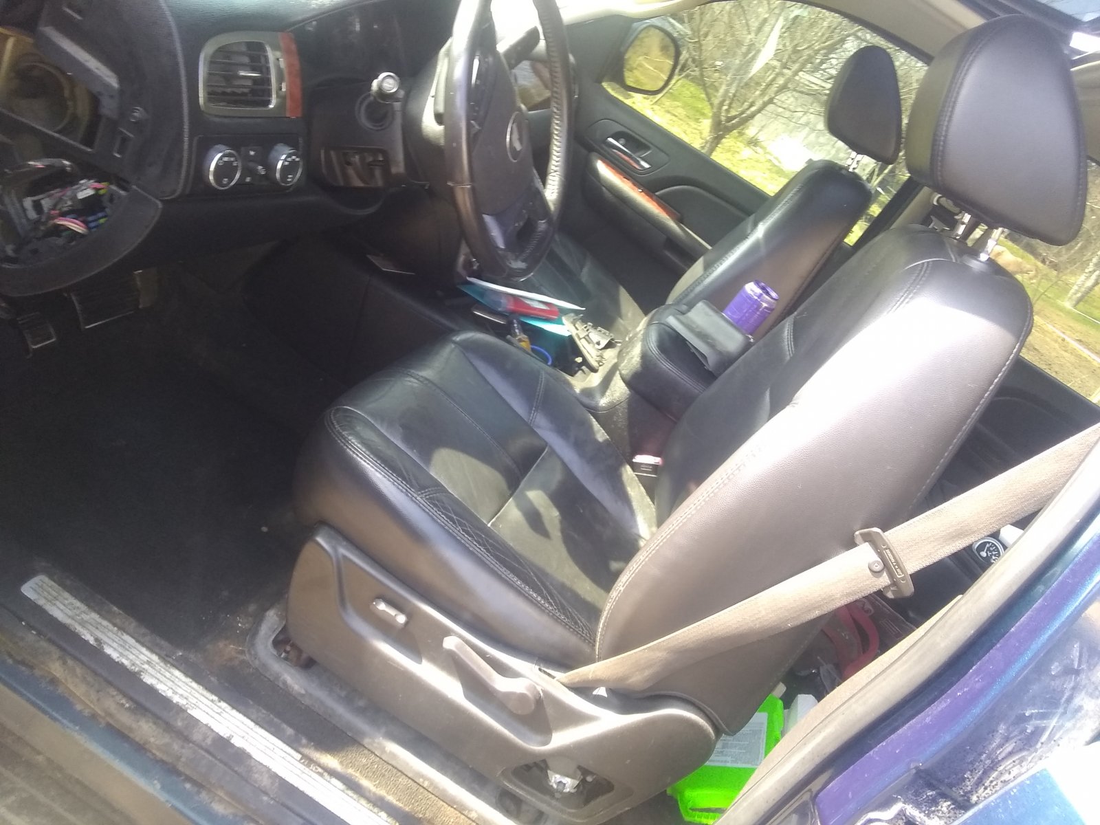

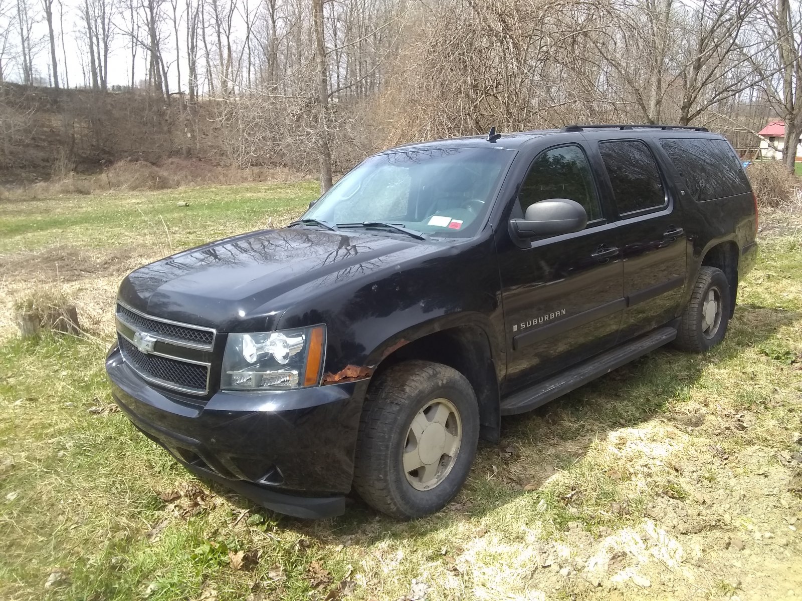

I just got a parts burb. 07 same as mine. The parts one is a LT with nice leather seats. Fronts I'm sure will be a straight forward swap. Middle is buckets mine has bench middle any tips on that? Will they bolt right up or will I have to drill holes or anything? Third row should clip in place of old third row right? Haven't had chance to get a close look at it all yet. Cracked block and some rust. I bought it mostly for a spare transmission. Wife wants the leather interior I gotta agree it's alot nicer than our cloth interior. And yes those are 90s 16 inch rims they unbolted calipers to put them on it lol

Easy peasy, no drilling, just transfer everything over. You've got a ton of good used parts there too.
That's good news :) and yea lots of parts other than different seats and our blue one having power adjustable pedals this one is optioned mostly the same as our blue burb so most electronics inside should work which is good because the blue one is throwing alot of body codes I want to fix also.

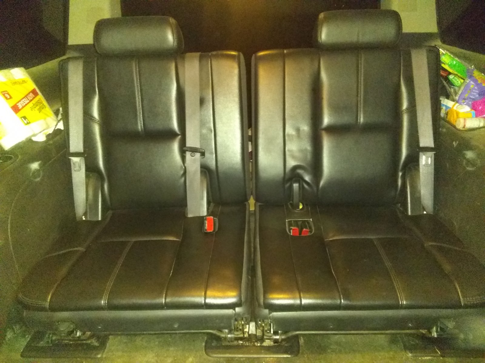

Question regarding 2nd row bench to bucket swap: How does the carpet look between the buckets? Does it have a seam, or less faded, or holes for bolts? I just bought buckets to do the same swap, but wonder, will I need to replace the carpet too?
87carl
87carl
Feb 21, 2016
328
169
Normal carpet no bolt holes or anything at first could see marks from where bracket sat on it but those disappeared after a while.

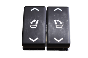

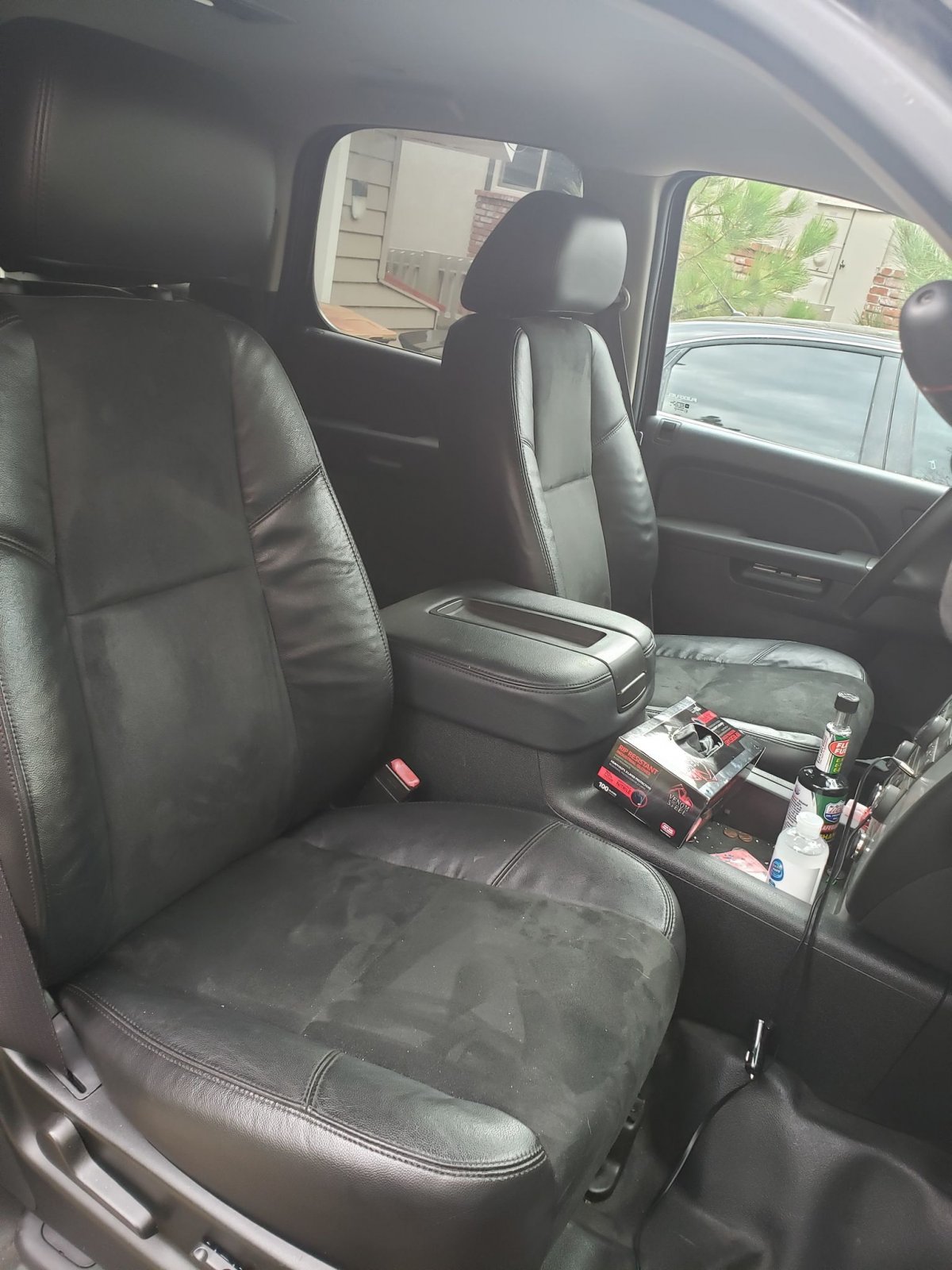

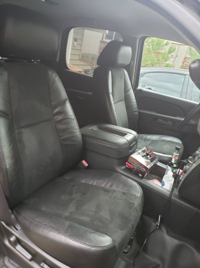

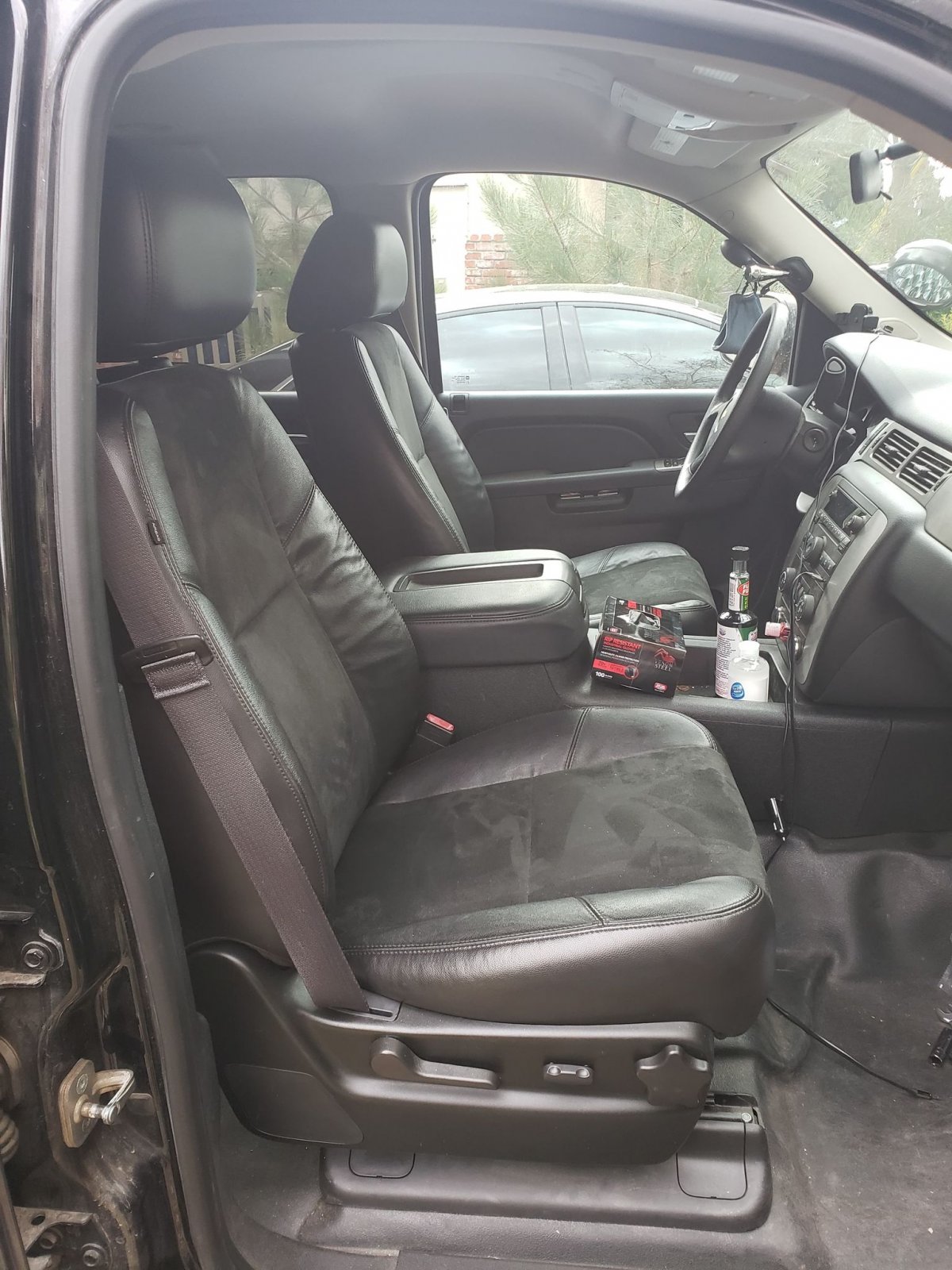

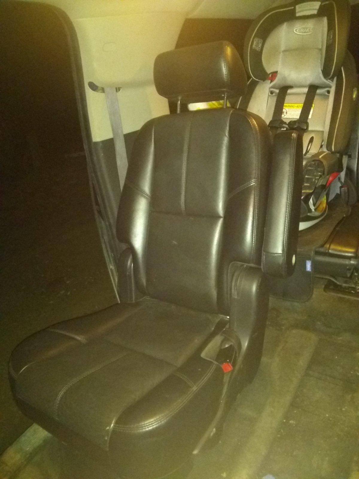

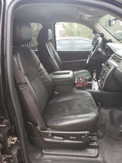

I just picked up a set of bucket seats to swap out my bench. The set I grabbed are manual but do have the heated option. I also grabbed the harness from the donor car. My question is, do these cars come prewired for all different trim levels? Would my harness have the plug for the heated bench middle row under the carpet? 2013 Yukon XL SLT in question
Shackman7878
Oct 17, 2020
142
184
San Bernardino

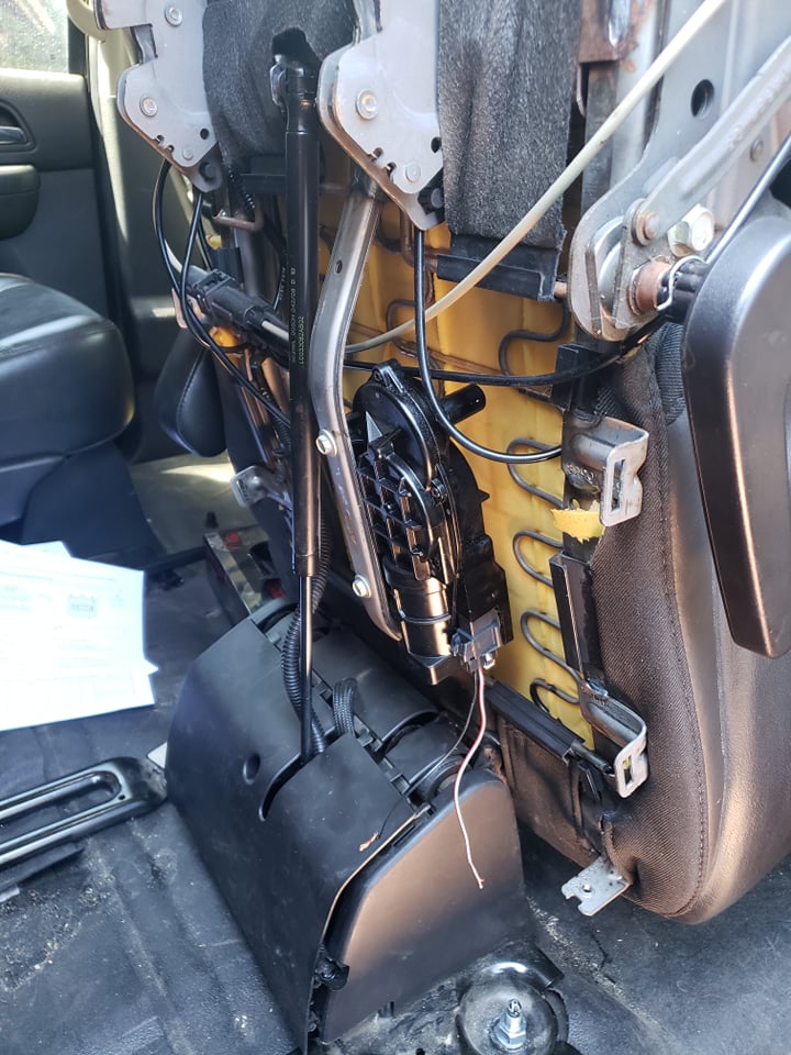

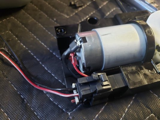

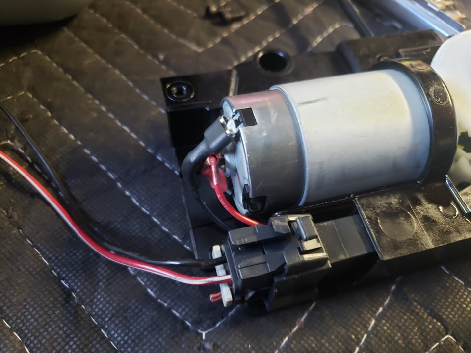

Only issue you might run into (maybe not this project but someone doing this like I did) is the connectors 6 8 and 12 way seats all have different connectors. Also there is 2 different airbag connectors see photos (spent extra day swapping airbags in the seats). Dose the current running suburban have airbags in the seats?
As for the bolts holding the front seats down I hammered on a standard socket got them off went to a local hardware store and bought grade 8.8 nuts/bolts hate those horrible torx hardware.

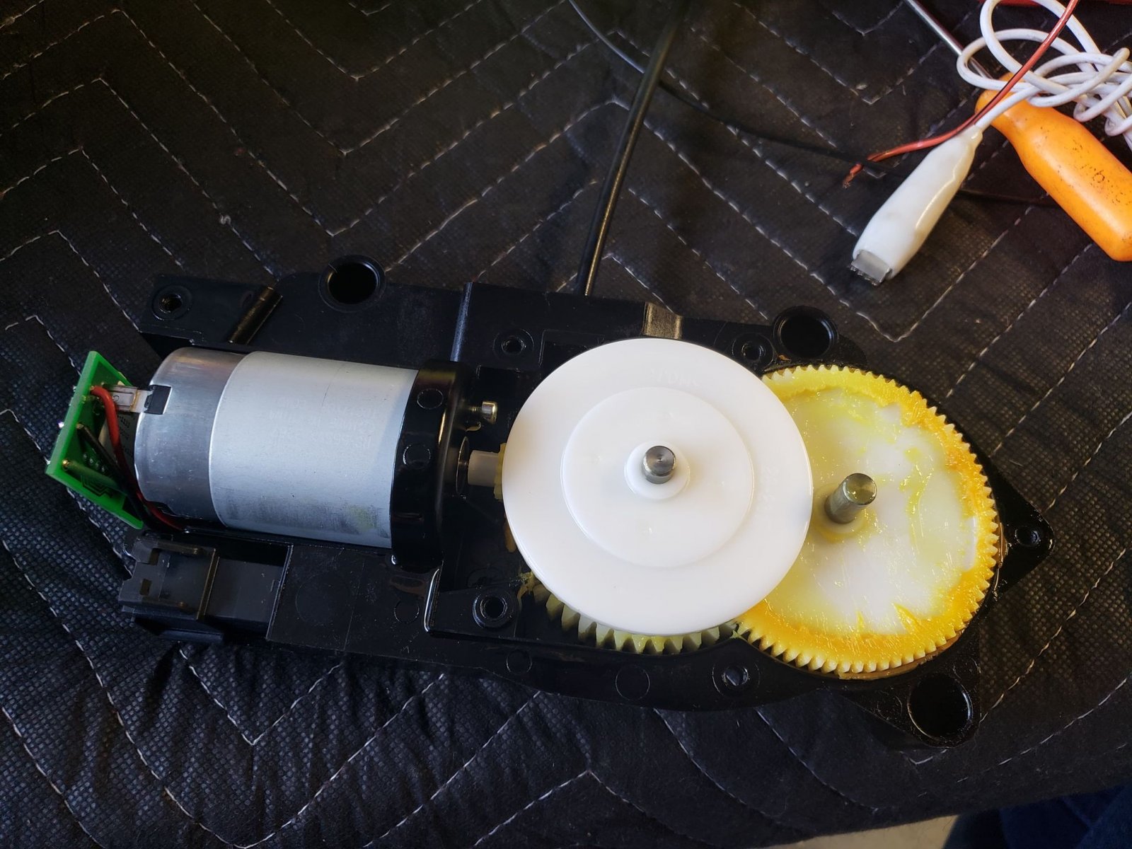

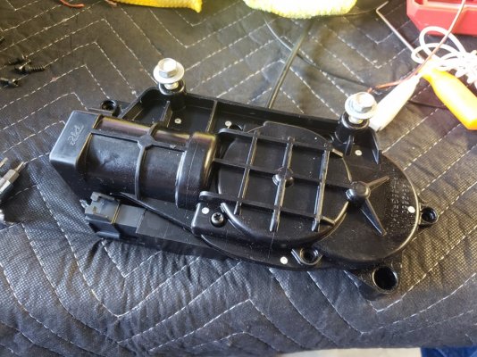

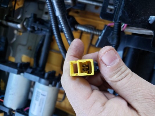

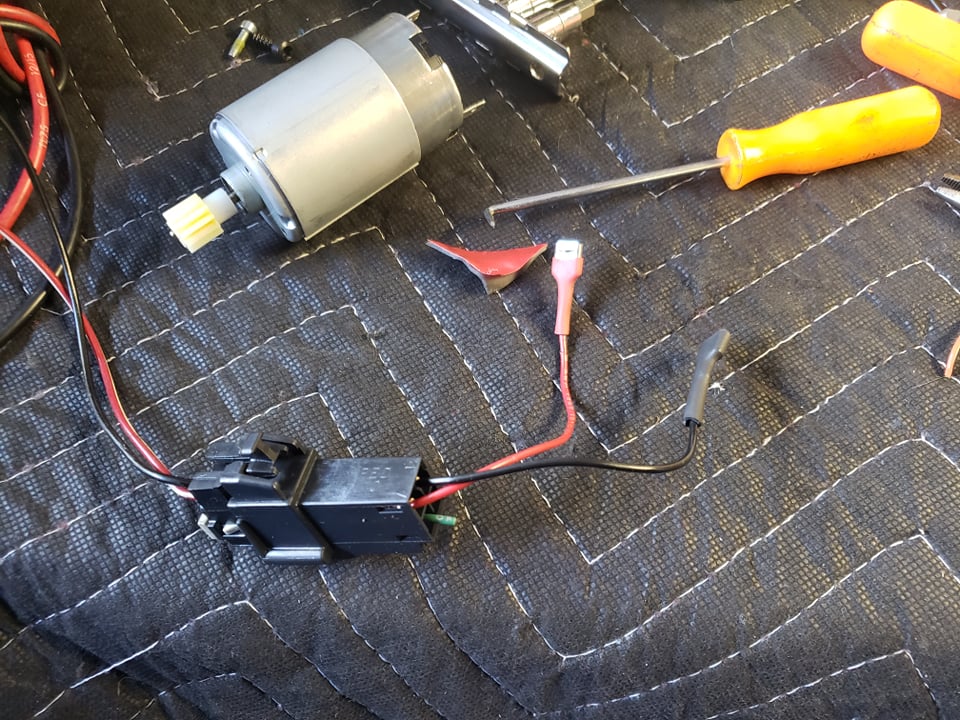

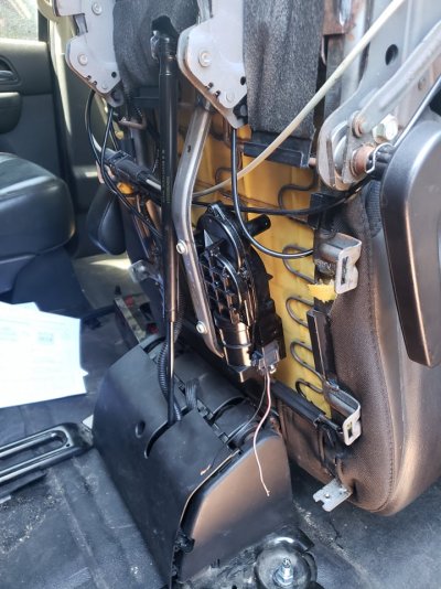

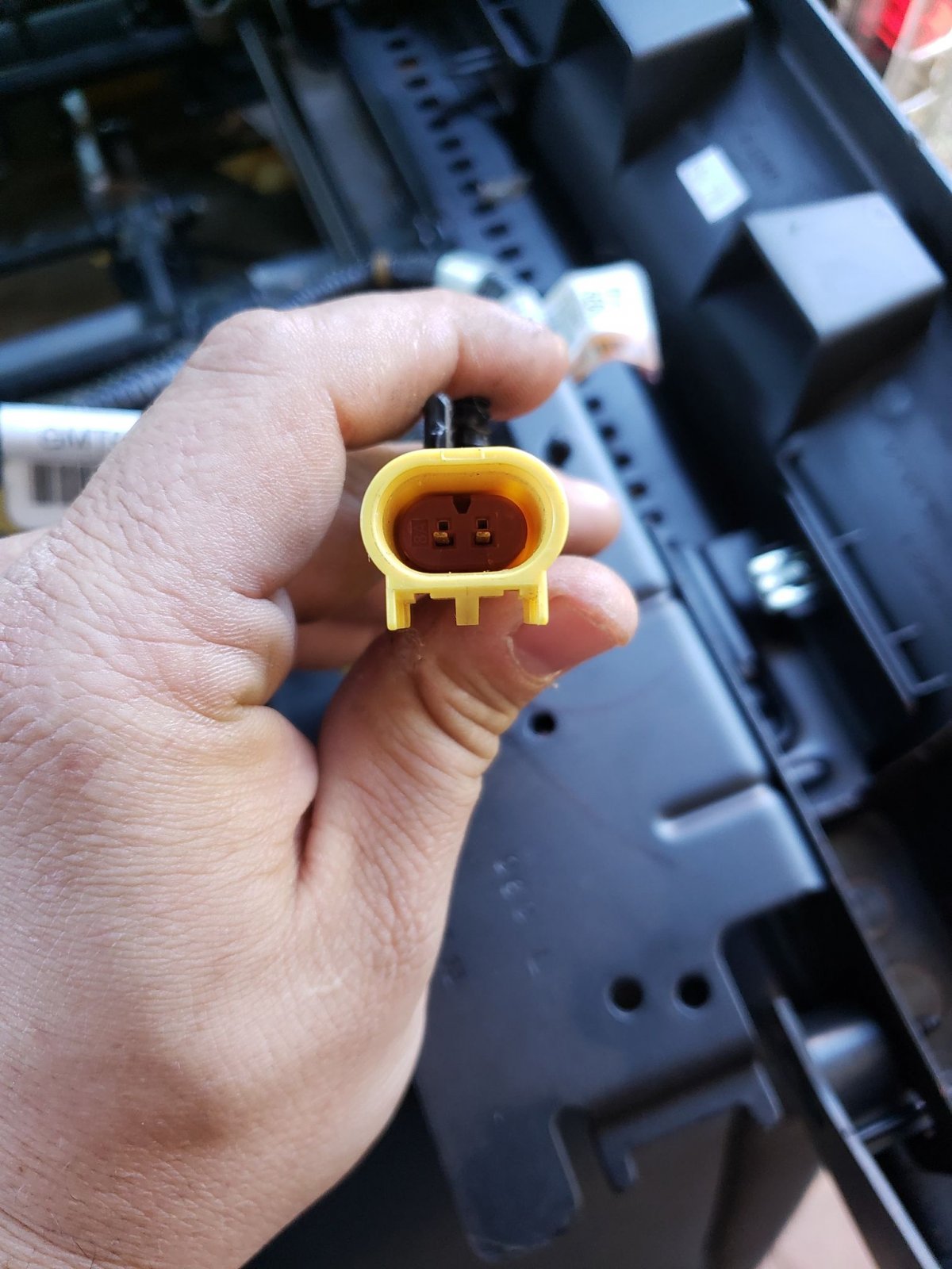

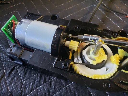

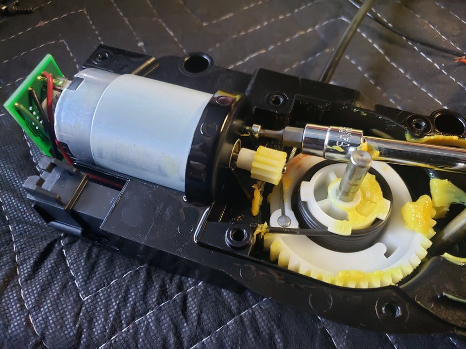

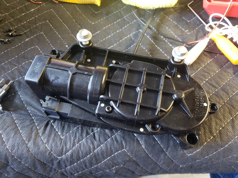

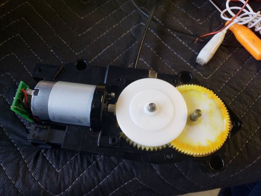

I took the heating element out. On the power folding seat option but removed the circuit board and wired direct to the motor for be careful there is no stop and you can strip the plastic gears also learned the hard way write Top on top of the motor they are directional. Have to dig out the wiring diagrams but it is looking for multiple sensors and low reference sensors.

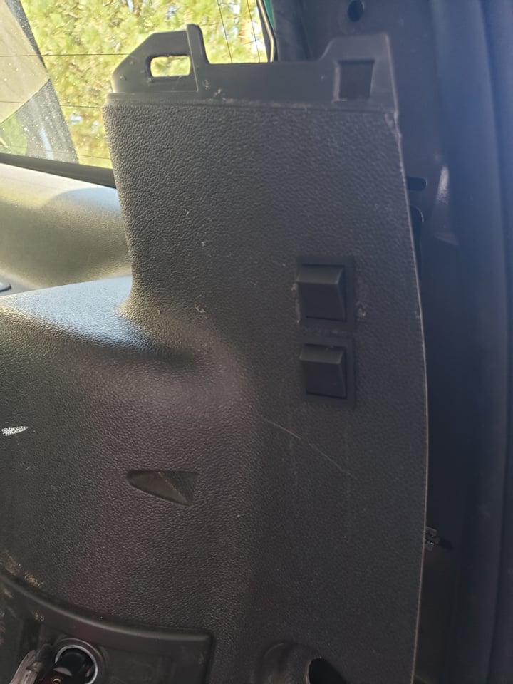

More photos - Back in the seat and wired switches to the back. trying to figure out how to upload a video
Link to google drive
Thanks @Shackman7878 appreciate the pictures and guidance. I don't believe my seats are power folding because they've got the manual flip up lever. I believe that are only heated. Donor car had a heated seat switch on the rear console and a power harness. I'm just curious to know if all models have the harness prewired to make this plug and play or if I'll have to wire up the plug to the harness

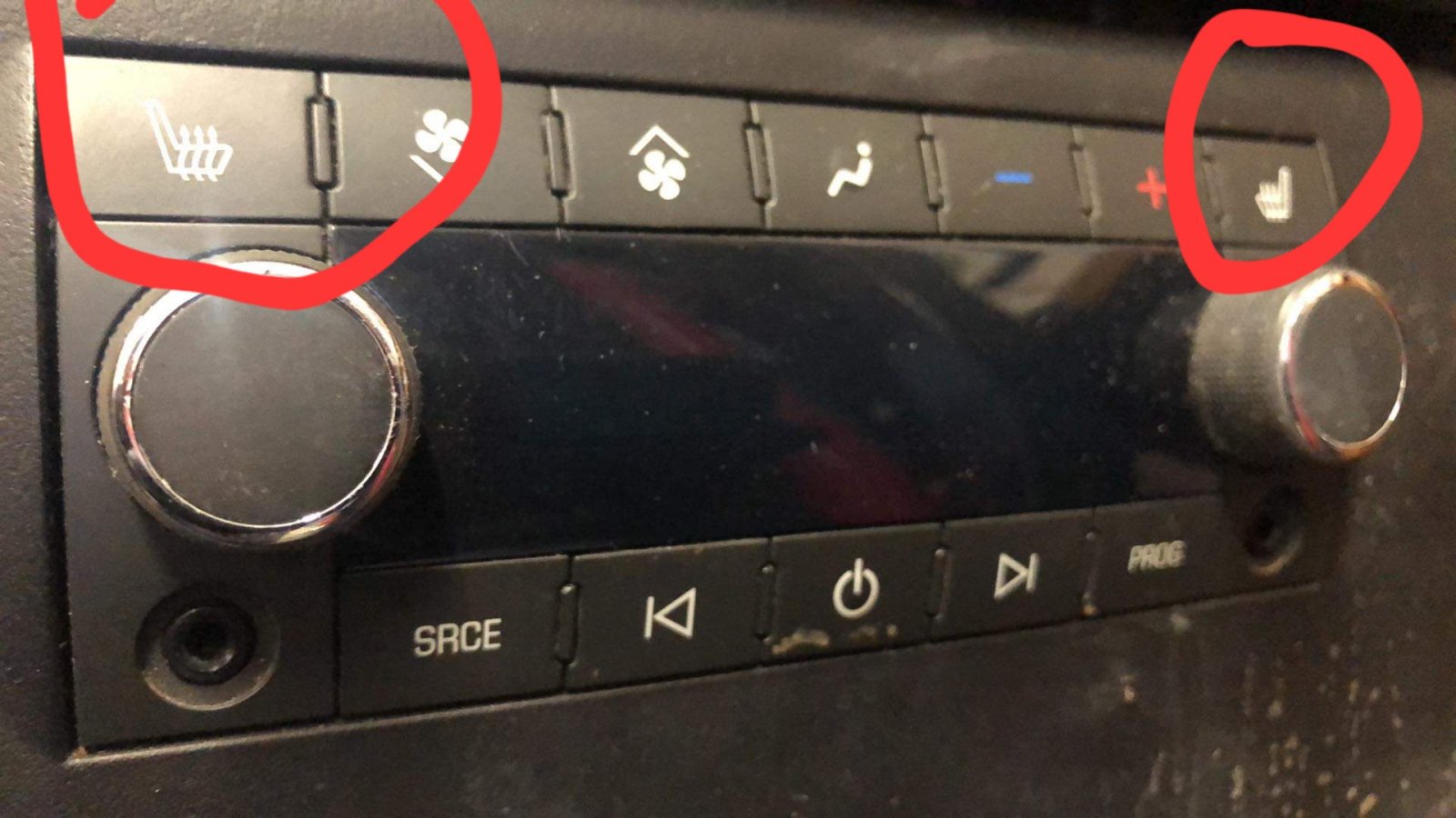

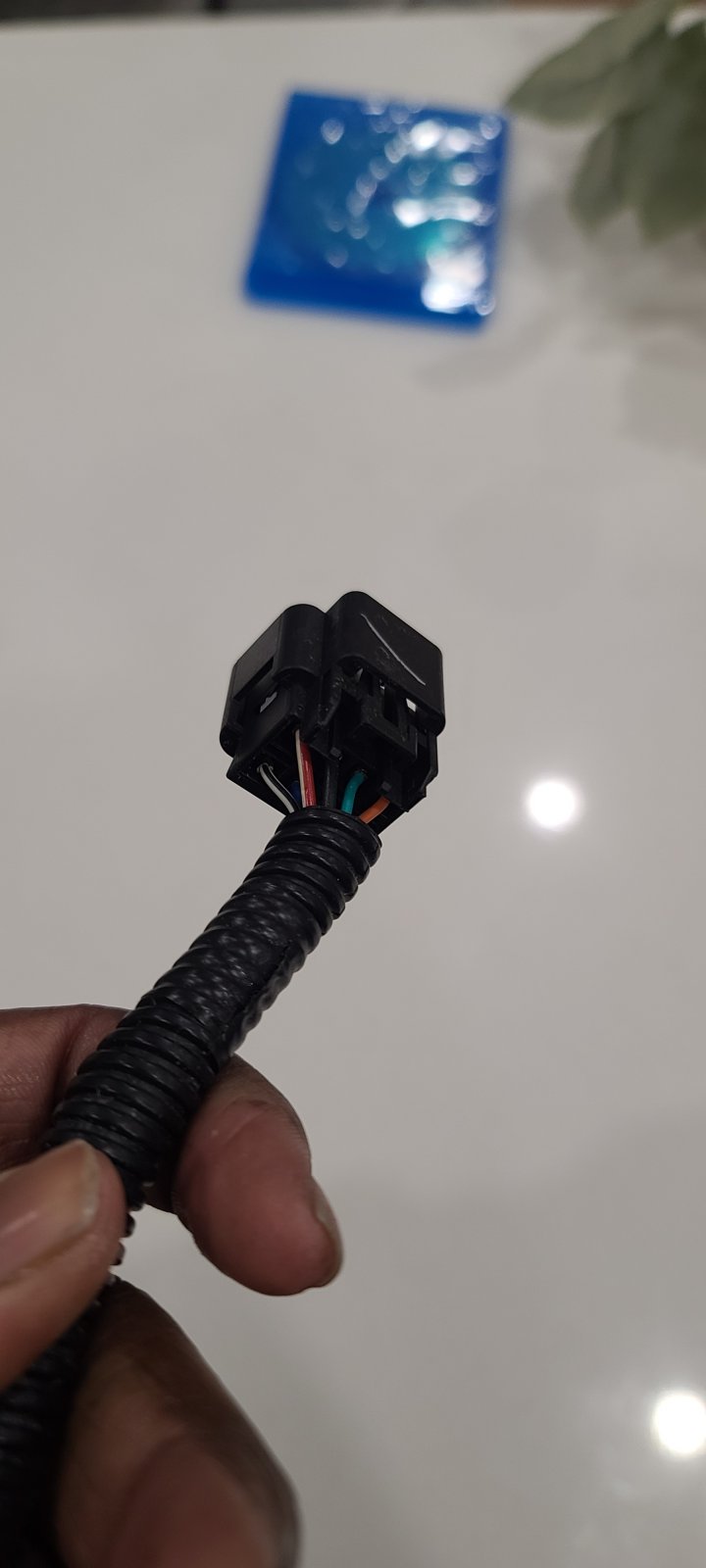

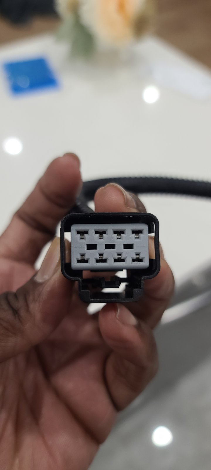

Can you post a photo of the connector I might be able to look it up and get a Pin out diagram. Also check the C pillar and the back hatch area for the photo switch

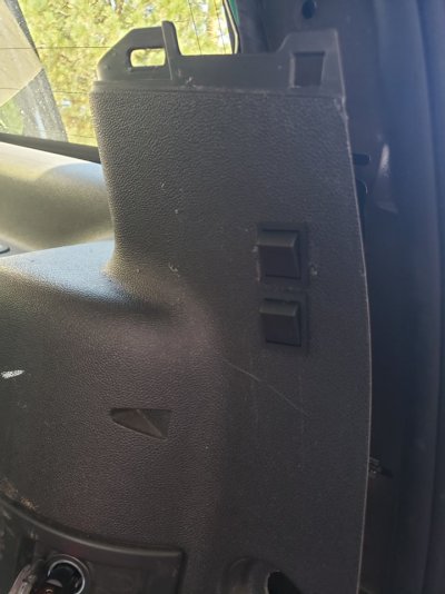

I'll send a picture once I get out of work. I don't have those switches anywhere and the donor car didn't either. The only switch for seats was mounted on the rear climate control console for heat.

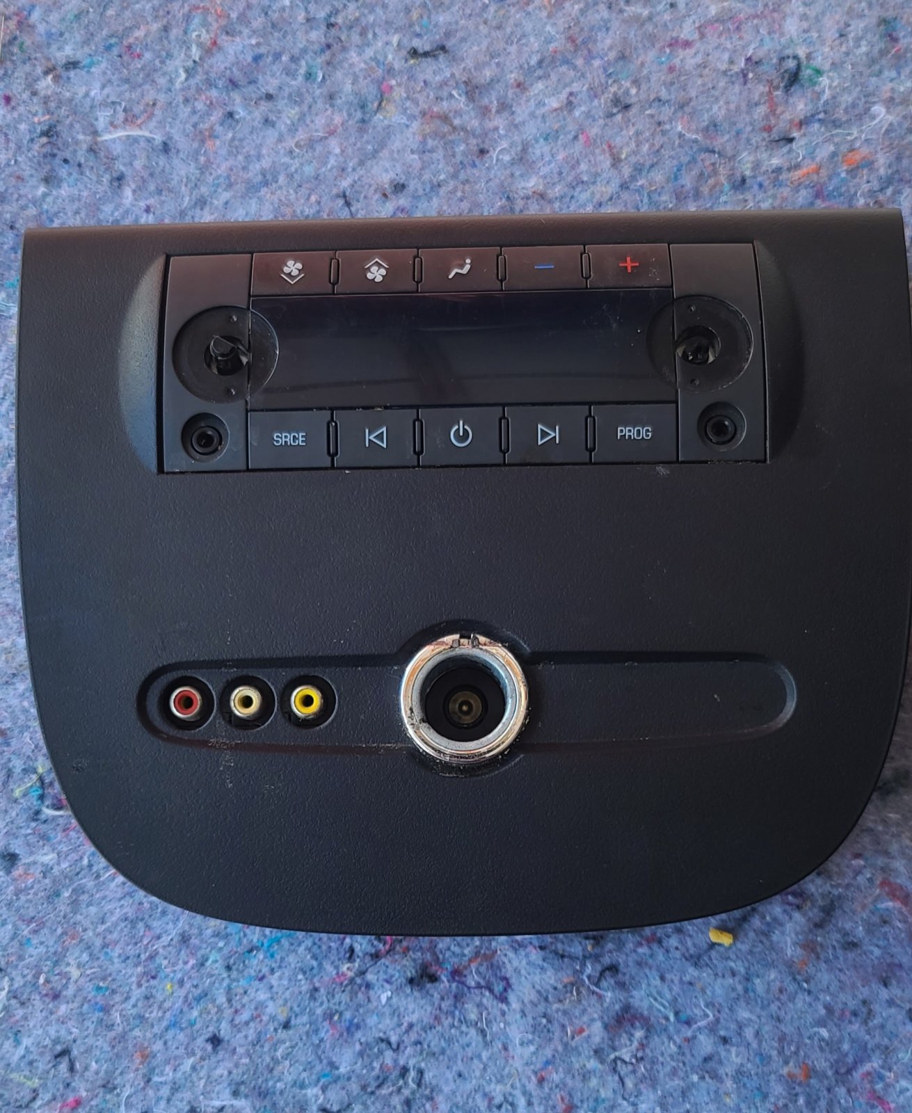

I've also attached a picture of my original console controls which didn't have the heated seat buttons and they plugged in without issue
5StarG3neral
Jul 4, 2021
26
13

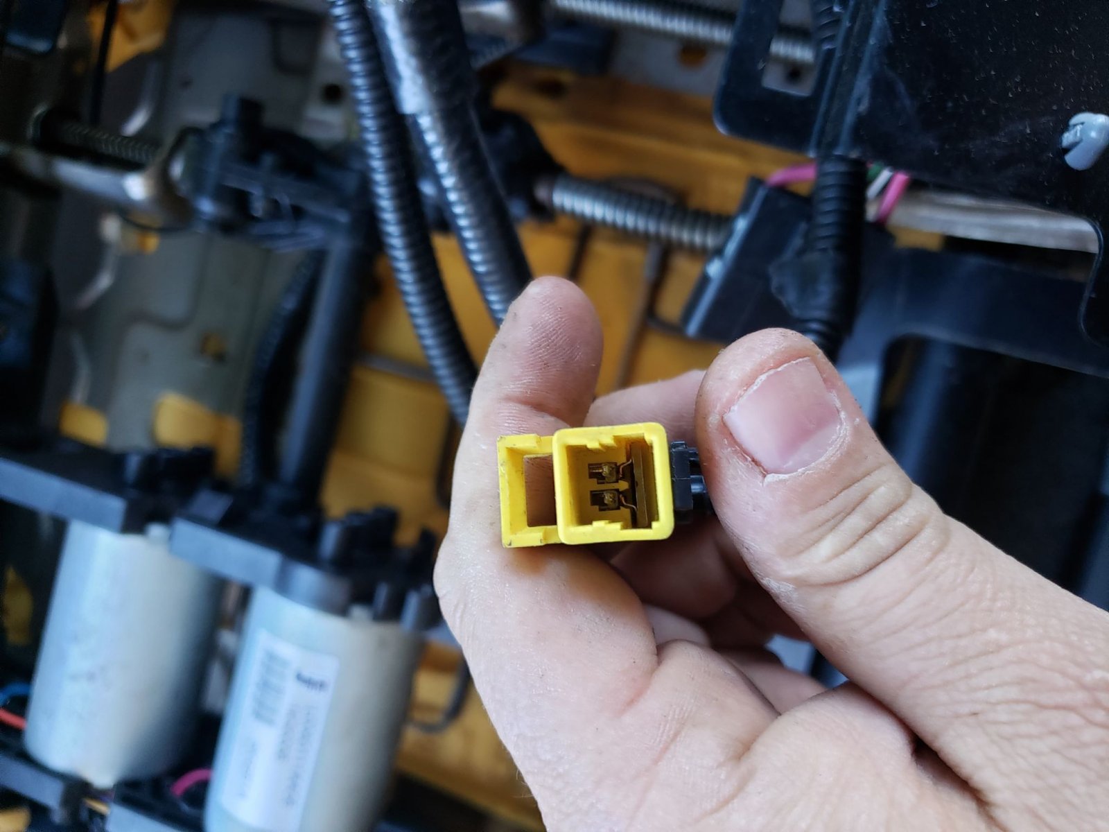

@Shackman7878 here are some pictures of the connector from the donor car harness. I haven't gotten a chance to look under my carpet to see if it's prewired or not

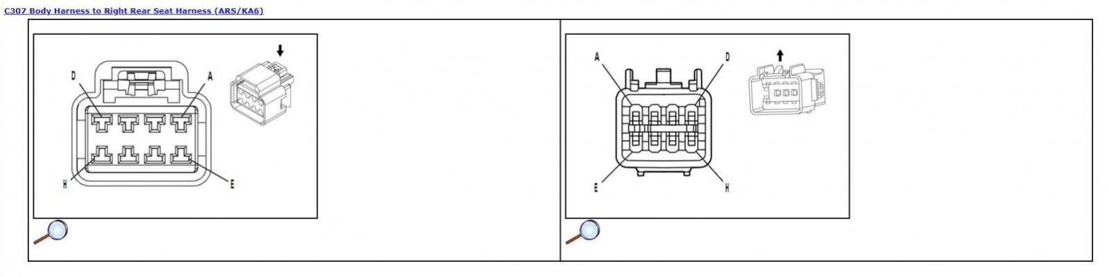

Shackman7878
Oct 17, 2020
142
184
San Bernardino
C307 Body Harness to Right Rear Seat Harness (ARS/KA6)
Connector Part Information
  • OEM: 15326924
  • Service: 15306174
  • Description: 8-Way F GT 280 Series (BK)
  • OEM: 15332150
  • Service: 88986250
  • Description: 8-Way M GT 280 Series (BK)
Terminal Part Information
  • Terminal/Tray: 12191812/19
  • Core/Insulation Crimp: Pins: A–B, F–G: C/A
  • Core/Insulation Crimp: Pins: D–E, H: E/C
  • Release Tool/Test Probe: 15315247/J-35616-2A (GY)
  • Terminal: See Terminal Repair Kit
  • Core/Insulation Crimp: See Terminal Repair Kit
  • Release Tool/Test Probe: See Terminal Repair Kit

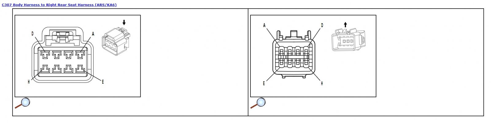

5StarG3neral
Jul 4, 2021
26
13
Connector Part Information​
  • OEM: 15326924
  • Service: 15306174
  • OEM: 15332150
  • Service: 88986250
Terminal Part Information​

C308 Body Harness to Left Rear Seat Harness (ARS/KA6)
Pin​
Wire Color​
Circuit No.​
Function​
Pin​
Wire Color​
Circuit No.​
Function​
A​
RD/WH​
4840​
Battery Positive Voltage​
A​
RD/WH​
4840​
B​
BK​
1150​
Ground​
B​
BK​
1150​
Ground​
C​
D-GN​
5060​
Low Speed GMLAN Serial Data​
C​
D-GN​
5060​
D​
OG​
2300​
Right Rear Heated Seat Sensor Signal (KA6)​
D​
OG​
2300​
E​
WH/BK​
2301​
Right Rear Heated Seat Sensor Low Reference (KA6)​
E​
WH/BK​
2301​
F​
D-BU​
2455​
Right Rear Passenger Heated Seat Cushion Element Supply Voltage (KA6)​
F​
D-BU​
2455​
G​
BN​
2297​
Right Rear Heated Seat Cushion Element Low Reference (KA6)​
G​
BN​
2297​
H​
PU​
6811​
Left Rear Seat Fold Tumble Signal (ARS)​
H​
PU​
6811​
Thanks @Shackman7878! I'll likely get into it this weekend
