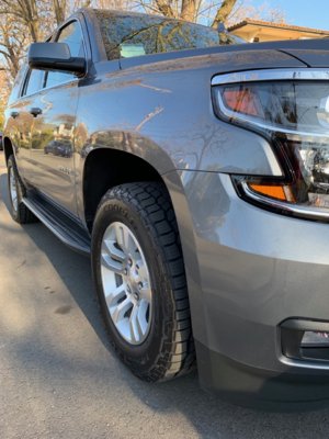

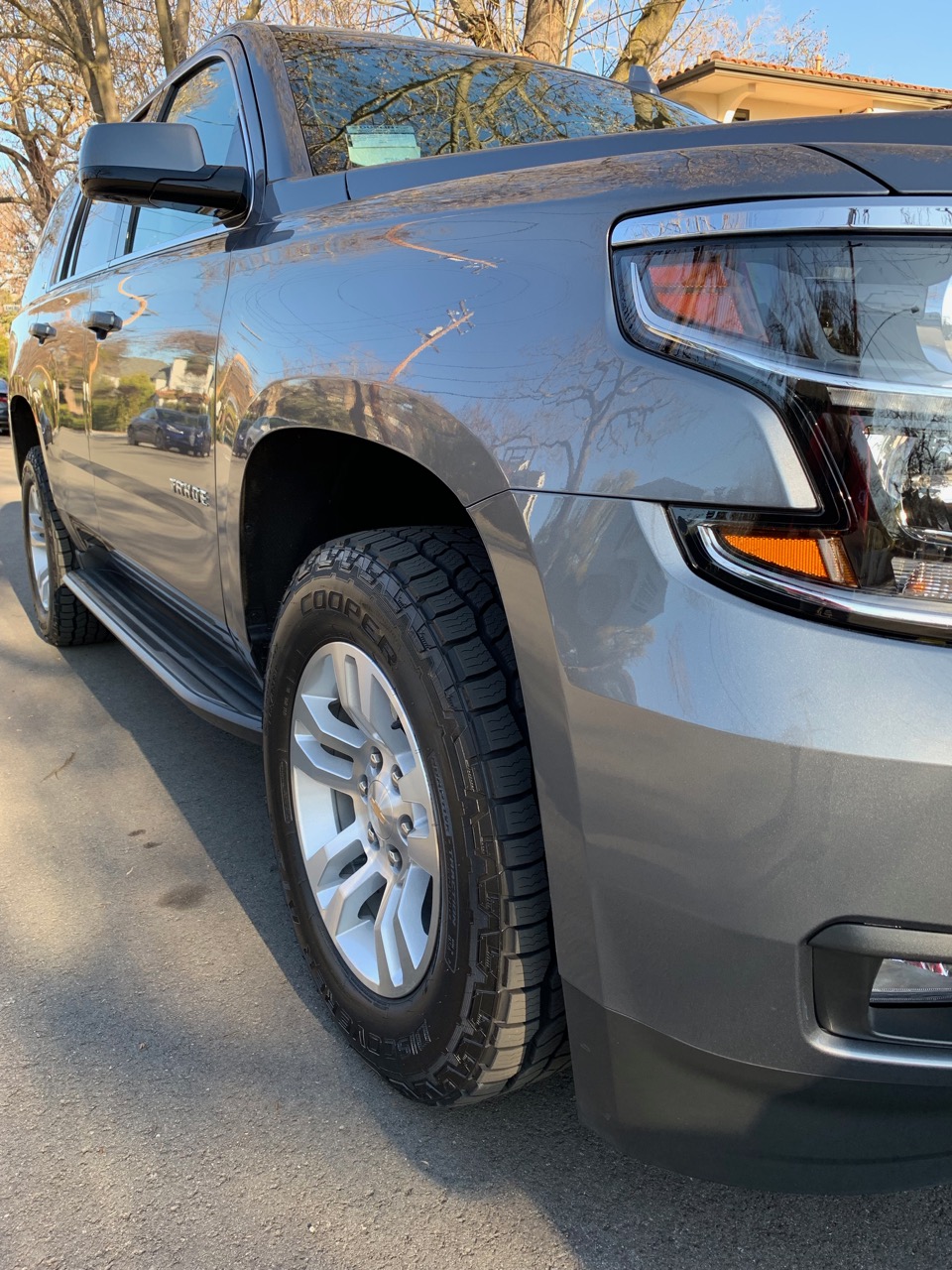

I just got the AT3 4S 265/65/R18's put on today! They are plenty big and they ride so much smoother than the OEM tires. Will test out in the rain and mud this weekend, and snow soon!

First update: tried the AT3 4S on very slick rainy roads today that are about 20% grade in some spots. Fantastic traction both in acceleration and braking. The AT3 4S seems to have none of the wet traction issues that many AT tires have.

I'm glad I went with the 265/65R18 on the AT3 4S. The tire profile and aggressive tread makes them look larger than the same size in a road tire. I almost went with the 70's but I think it may have rubbed a bit at the steering extremes. Probably good to stay around 32" in diameter without doing a level on the stock front end, with a 2" level you could probably go bigger.
