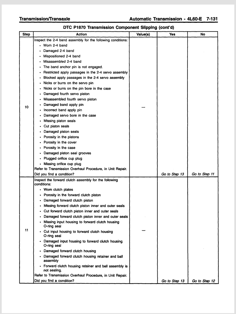

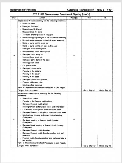

The P1870 is set when excessive torque converter clutch slippage is detected. If you have a tech2 or similar scanner, GM does have the diagnostic procedures for it.
Images below are from a 1998 manual, unsure if there were any significant changes for 1999 but maybe it will help. Another source (alldatadiy.com which has the same info/diagrams as the GM manual) notes that a faulty “Transmission Fluid Pressure (TFP) manual valve position switch” may trip the same code.
It probably wouldn’t hurt to drop the pan and see how it looks in there.
