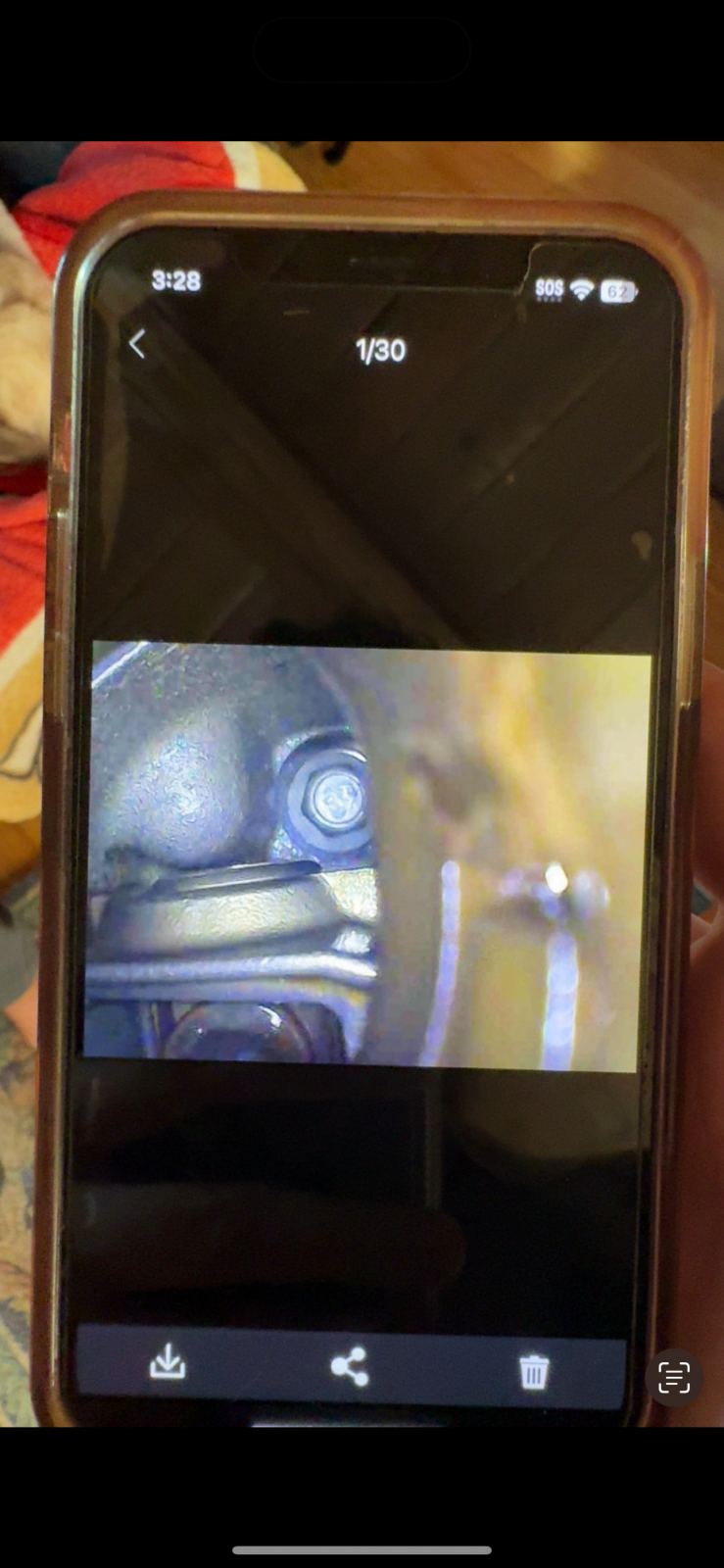

I’m the 3rd owner from what I can tell on the carfax. No clue how it was driven other than the fact that the engine (from looking at it through the oil filler with a camera) was very clean. I will attach a picture below. I drive pretty moderately. Apologies for not including more, just been a wild day.

"Just the P0157". I Googled "P0157 Chevy" This is what comes back.
P0157 stands for “Oxygen Sensor Circuit Low Voltage (Bank 2, Sensor 2).” This code is triggered when the powertrain control module (PCM) detects a problem with the downstream oxygen sensor. A damaged oxygen sensor, exhaust leaks, and a lean running condition are possible reasons why this trouble code is set.
