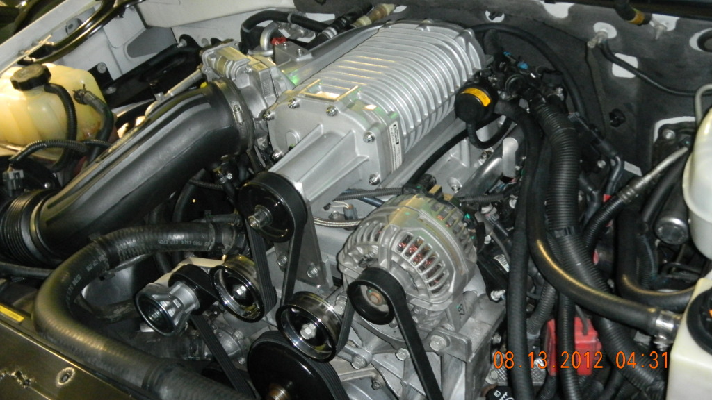

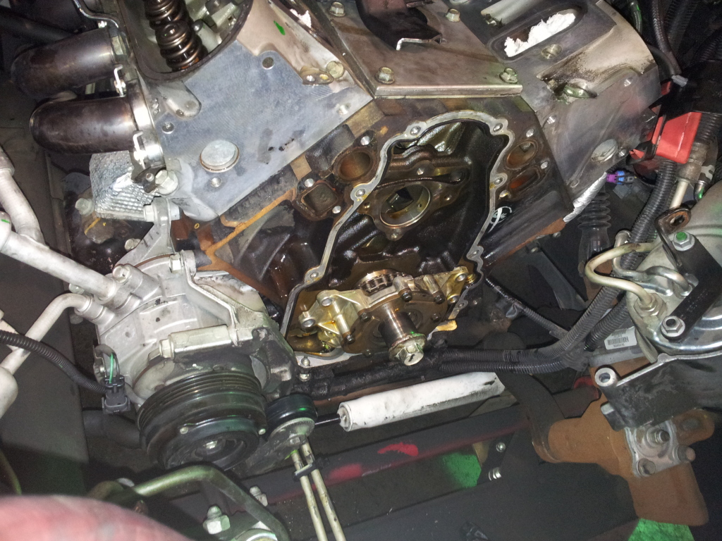

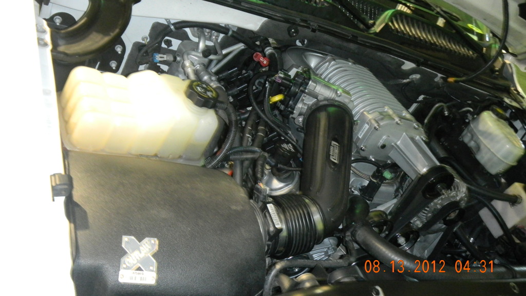

hey everyone finally got all the stuff installed and man she pulls pretty hard, happy with the out come here are a couple of pictures of the tear down
Getting ready for the CAM/pushrods and valve springs swap

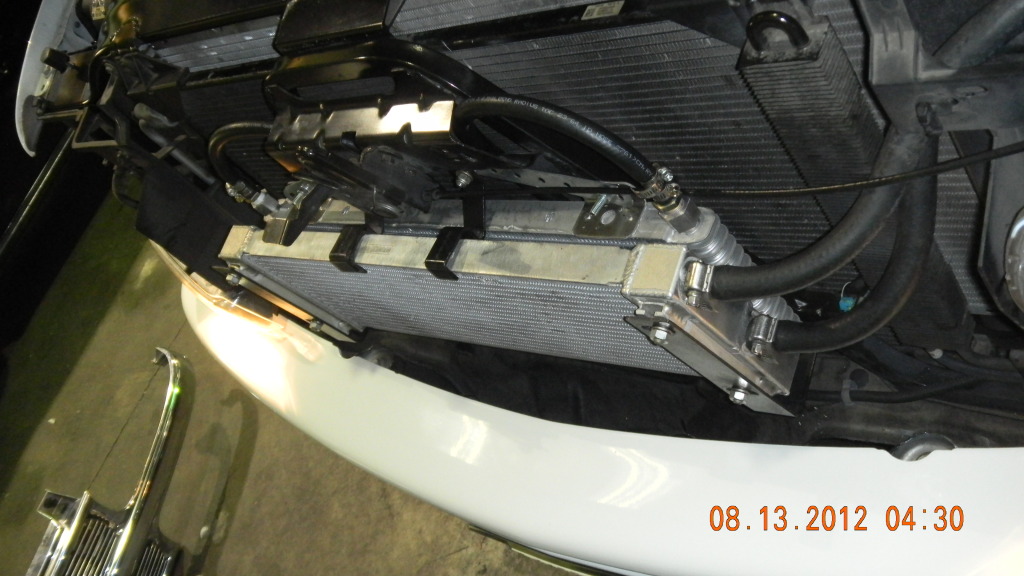

also got the tru-cool and Inter-cooler installed

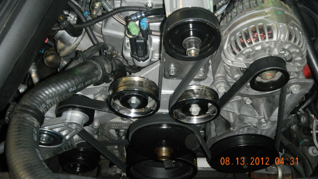

im on a 3.1 pulley it's only boosting about 6-7 pounds, injectors are at 60% duty so i have plenty of more room what im worried about is the stock flex fuel pump even though magnuson told me i'll be allright if anything i'll get a kenny bell boost a pump...

Make sure to watch your IAT's as you pulley down.

wow man that look original! nice work!
That was my goal to make it seem like it came factory that way, i think i did a good job i still have to do a little cleaning up on the wires.. etc..

I was running 11psi on my 04 with the Radix on a 2.9" pulley. I never replaced the pump (was FF as well). Never had an issue with her, and she would get up and go. Enjoy your new found horses!!
