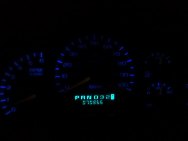

Here is mine in blue, ****** phone pic but what i got at moment

so from what ive read, it takes 6 or 8 194s and white will still make it look blue .. and it is pretty easy nothing to solder in . just plug n play pretty much?

This is what I've noticed. The factory bulbs are halogen and have a slightly yellow look to them. If you look closely at your cluster, it's not actually just pure white, it has a greenish tint to it. So yellowish factory bulbs + blue film = light greenish cluster. I painted over the factory bulb with blue paint and the cluster turn totally green. It was king of cool, but didn't match up with the rest of my dash.
