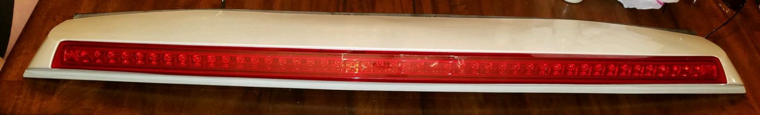

I sprayed the spoiler for the Esky 3rd today with the 3 stage white diamond tricoat and I am letting it cure up over night and will get it installed amd wired tomorrow.
The only "problem" that i have had with this mod is that I am getting power backfeeding through to the front parking lights when I step on tge brake pedal. I assume it must be one of the LED bulbs allowing the power from the brake side of the bulb to cross over to the parking light because I didn't cut or splice into any parking light wires for my mod. I will investigate this further tomorrow. I know it is the parking light side of the front lights because the turn signal still makes the front bulbs get brighter even when the brake pedal is depressed.
Anyway... Here is a pic of the spoiler after I painted it.
I know... Nothing we all haven't seen before... Lol

May not be something that we haven't seen but still awesome and one of my favorites, first thing i did to my nnbs. You'll have regular people with escalades thinking theirs is brokin lol
