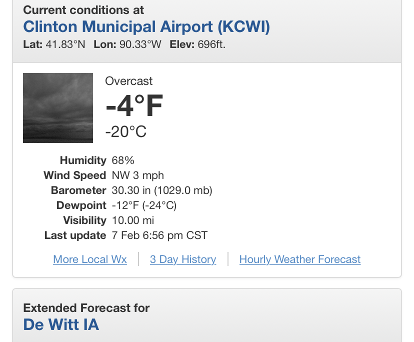

I gotta chuckle at this. I’m looking at -4*F temps and James is worrying about the AC being cool enough.:rolleyes:
