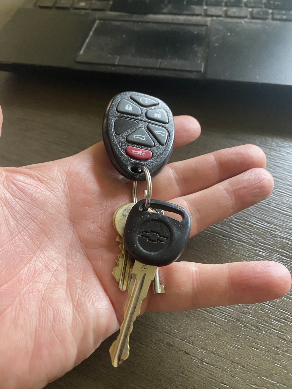

The key with the plastic has the chip to turn of the anti theft system.
I get the manual with mine which told me you must use the remote to unlock to keep the alarm from going off.
The standard PPV fob doesn’t have the start, hatch or glass buttons like this one. I still have that but wanted to be able pop the glass. Also an I’ll fated attempt to get remote start.
Press the door lock button twice then try the remote start
