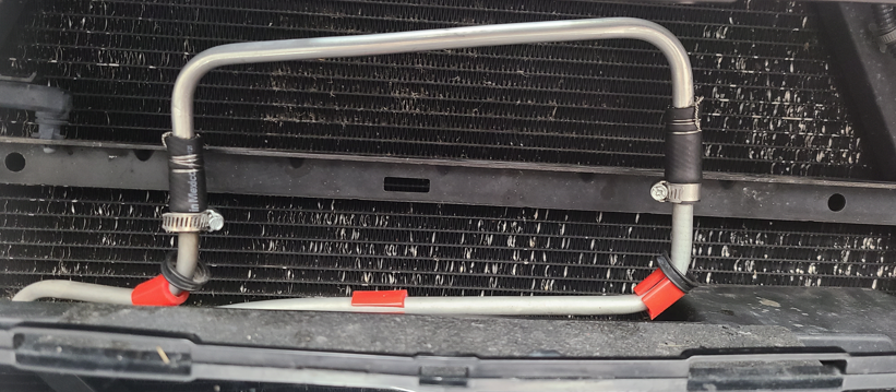

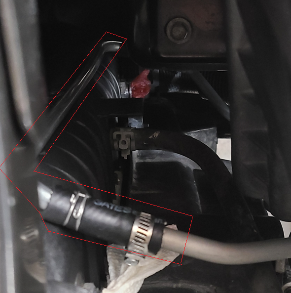

As for the radiator.
I do recall the transmission side feeling like it was pretty restrictive when i did a flushing before reinstalling.
I did a forward and reverse flushing for good measure.
Noticed a slight pressure build up and slow release, but didn't think anything of it since i didn't have an issue that i knew of before hand.
I'm now thinking that it might be failing internally, or when i ran the engine for a sec at first startup, and didn't have enough transmission fluid in.
Since it was so fresh, i tried my best to not turn it off until i had a chance to get some good oil flowing.
Possible something ended up in the lines, and slowly got worse as i drove while breaking in the engine.
This is all speculation until i prove it.
At the time i was more concerned about the engine oil cooling side, since i know that got metal in there.
It's always that one part i knew i should replace, but didn't because of $$
(and i wanted to spend $500 on an upgraded radiator vs a stock one)

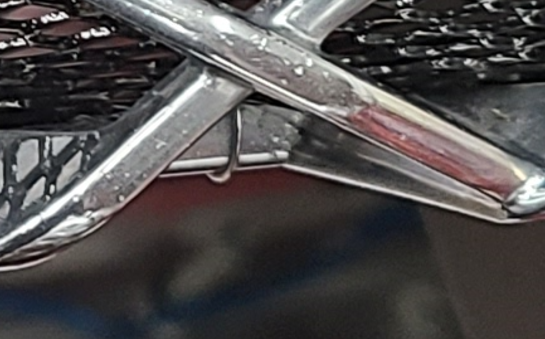

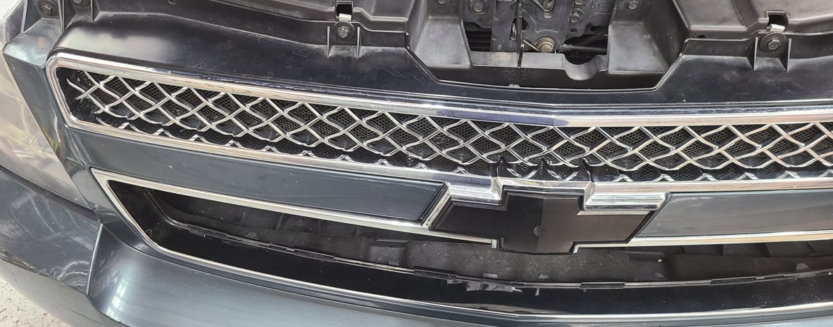

While i had my grille inserts removed, i thought it could use a screen.
I'm sure this will probably cause more problems than it solves, but it's worth a shot... :jester:
Lower,
I used this stuff.
This stuff worked pretty good, but i did find it a little brittle.
Tended to try and break on me if i bent too quickly, or too much of an edge.
Then some fine stainless steel "safety" wire to make sure that crap stays in place.
Lots of holes in my hands!
That safety wire is just fine enough to crawl under your skin if you're not paying attention.

And for the grille screen retainer.
For the most part i was able to push the screen out in order to lock it in place.
But for the wire retainer part, this is what i did.
The trick is to not crack the screen through.
a little trial and error for me.
I ended up picking a thicker place in the screen for the wire, since thinner ends broke through way to easily.
One thing i was unsure of, how much space for the wire would i have when the grille inserts are reinstalled.
Answer = plenty of space.
:cool:
I went back through the lower insert to brace it a little better.
The top screen also helps to block access to the hood release, as i found out earlier how easy it can be opened from the outside of the truck.
Now of course you can still just jab a screw driver through the screen, but it will leave a very obvious mark. ;)

and a little image of my trans cooler bypasses.
Front "tow package" bypass
Main radiator bypass.
I couldn't find all of my hose clamps, so i ended up using my "ClampTite" tool
That tool uses wire to create pretty little one time use clamps.
So far i have been very impressed by this tool.
But for most things, i prefer a reusable clamp that's easier to deal with vs having to locate my special little tool.
That said, it's great if i don't want to go to the store to buy hose clamps. :beer:
And it should seal a little bit better than a hose clamp, since there is no raised part that could possibly leak (where it might require a second hose clamp otherwise).
IIRC it was either a youtube video, or something on velocity channel that showed me the handiness of it.
Pretty much you can wrap the wire as many times as you want around the hose.
I bought the cheaper "aluminum" bodied one
I wish it had a little case, i keep this tool in a Ziploc bag so i can keep the instructions with the tool.
But It works fine with just a single wrap.
My tool, pen for size reference.
(Found on ebay for about $25, took some hunting before i found one with a price tag i liked)
