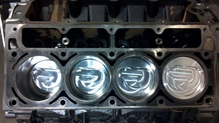

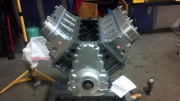

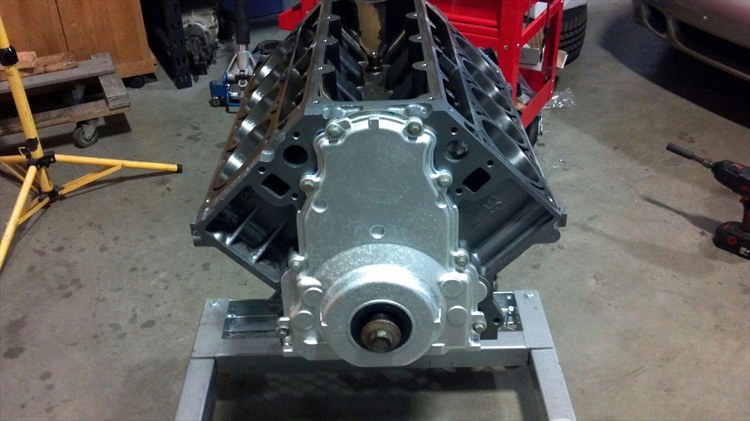

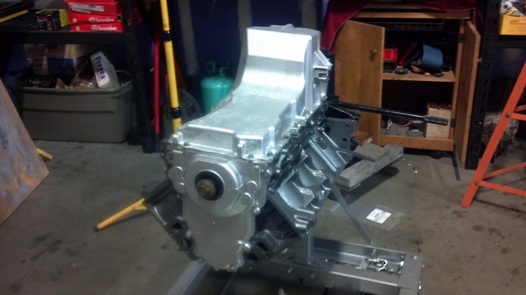

motor build pics
attachment.php
attachment.php
attachment.php
attachment.php
attachment.php

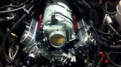

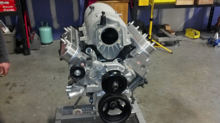

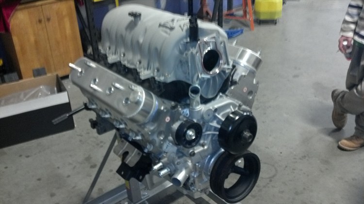

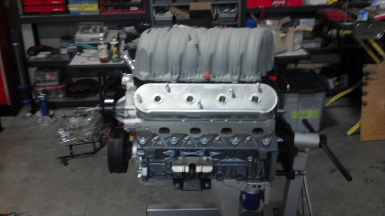

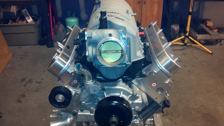

more pics
attachment.php
attachment.php
attachment.php
attachment.php
