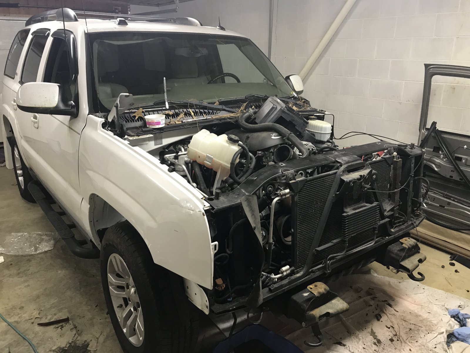

Was able to get in a few days of work on the Tahoe.
traced the brake fluid leak to on of the rear lines. They’re both pretty rusted and bad, so I’m going to replace them, but the front ones and the ones headed to the master cylinder have almost no corrosion on them. So I’ll cut the back lines out and make some new ones. Braided stainless lines will have to wait just a little bit.
got the leveling kit and the body lift finished. And the fender flares back on. Have to modify the bumper bracket just a bit to make it fit, but did a test fit today based on position, and the HD bumper now clears the body, grill, and lights with aplomb!

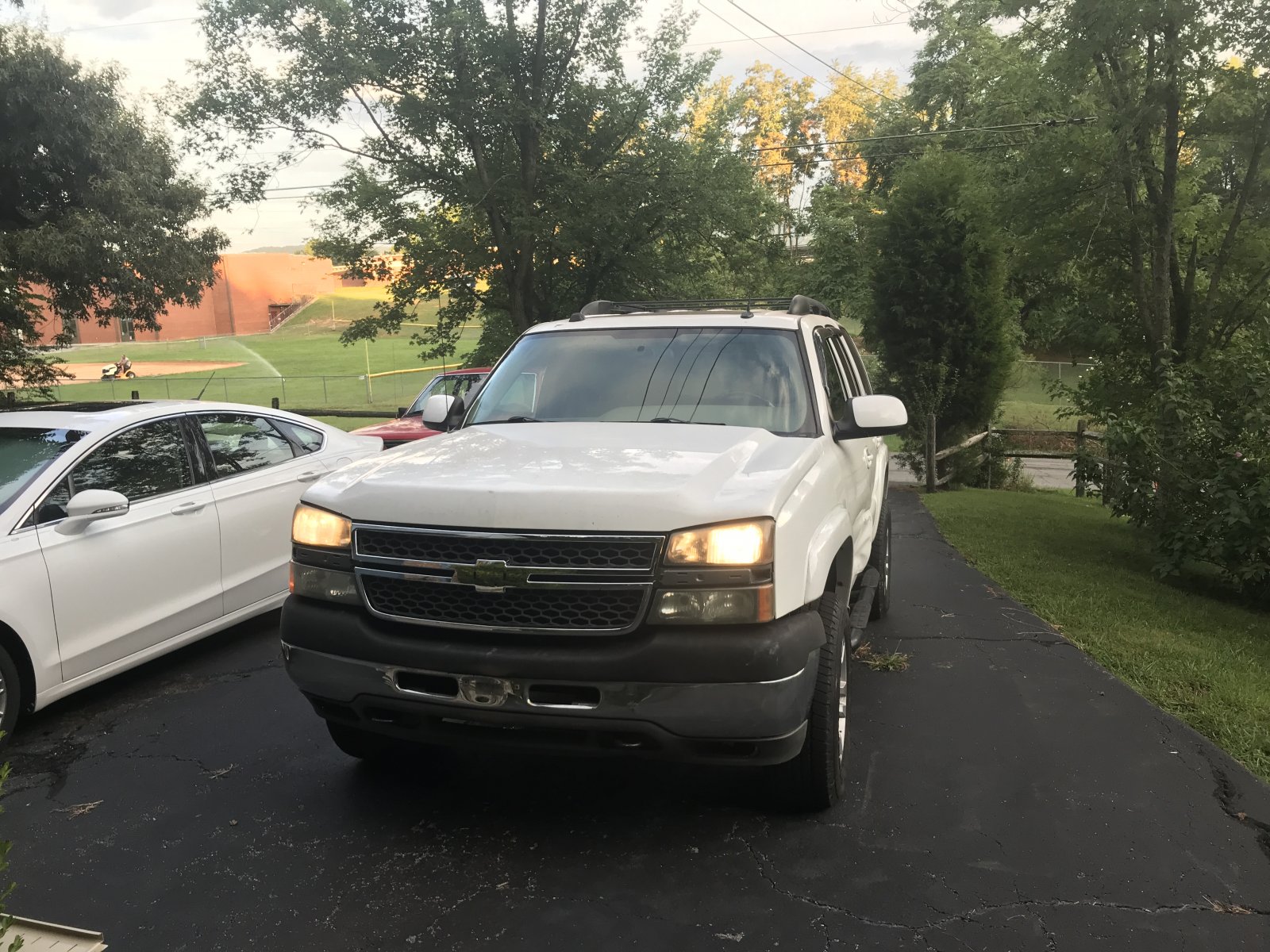

Got the bumper light connectors on the drivers side replaced with new ones with a bit of solder and tape. Was gonna work on polishing headlights, and then got distracted by paint.
painting over chrome sucks, and this won’t actually be the last time I do this job, because I’m not happy with the way it turned out, yet. But it is done for now, and until I figure out the permanent bumper situation, I’ll just ride with it, then paint all the new parts together. It was dark before I got it back on though, but here’s and idea of what it’ll look like
