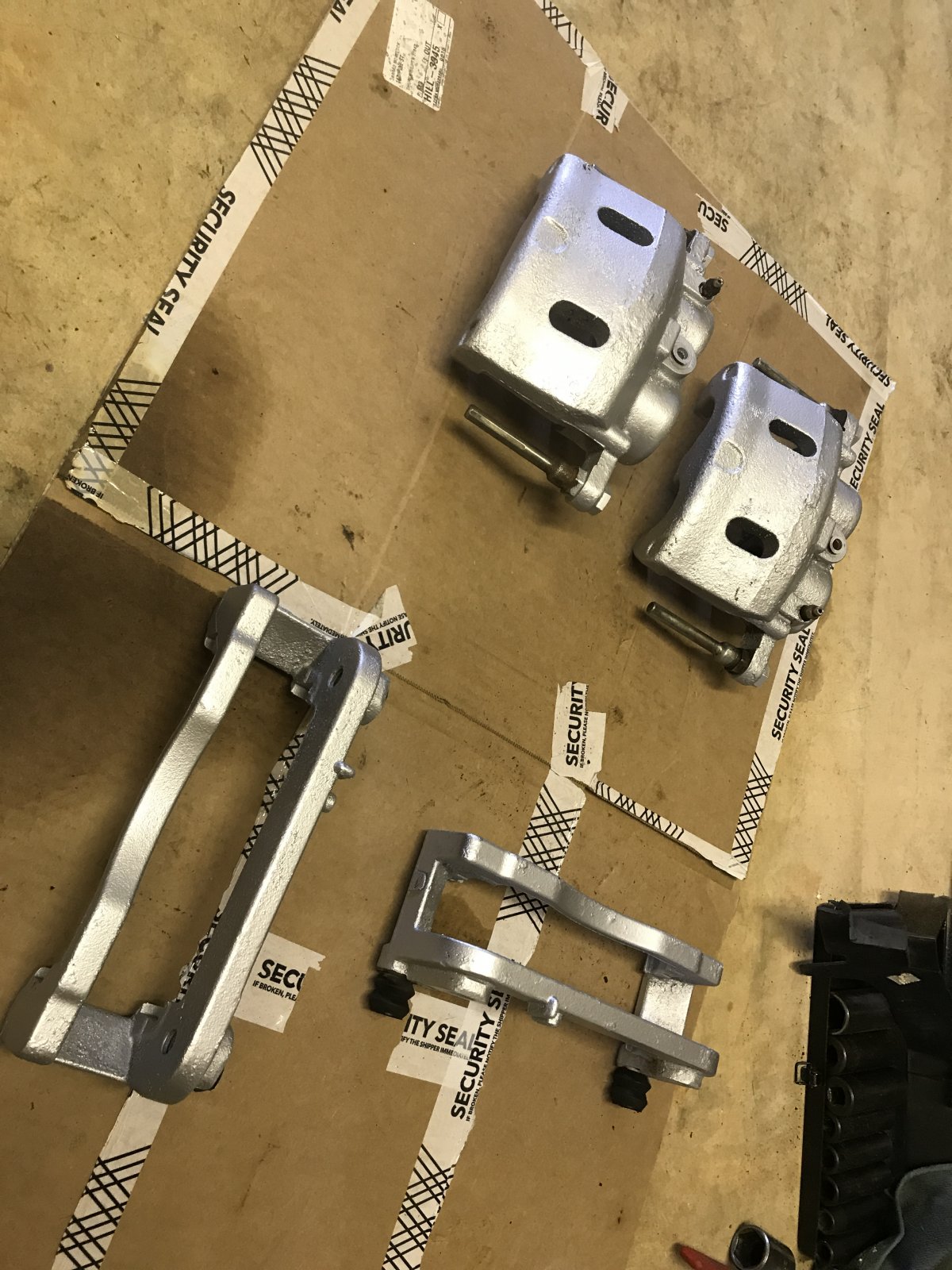

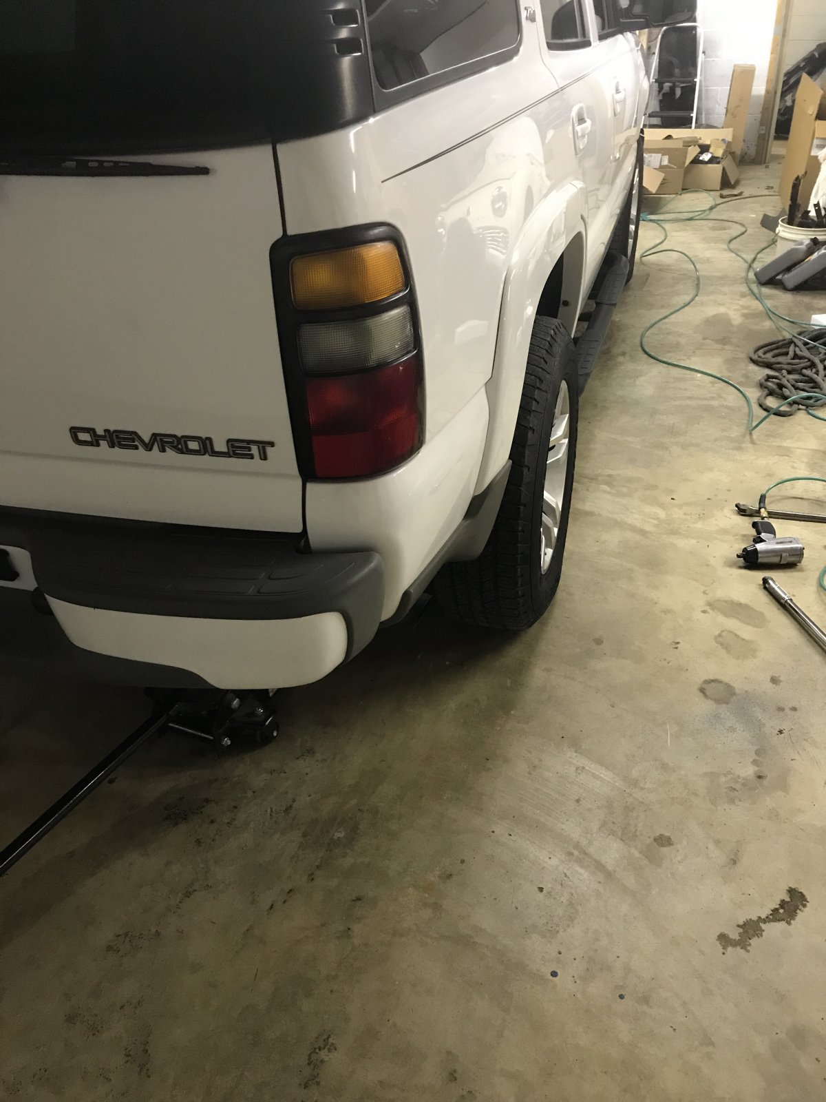

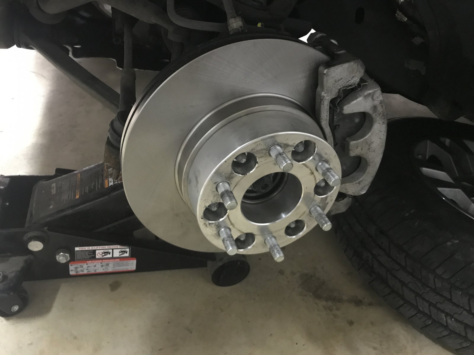

anyways, got a few things done. Installed the rear wheel spacers View attachment 252139View attachment 252140 peeled the stickers off the rear window, and took the pin striping off the sides.
prepped the calipers and painted them for the NNBS brake upgradeView attachment 252141then put all new rotors on the front, and put the new (to me) calipers on.View attachment 252142 Didn’t take anymore pictures, but also put bigger torsion keys on to level the front, and added the wheel spacers to the front as well. Stance is much improved.
