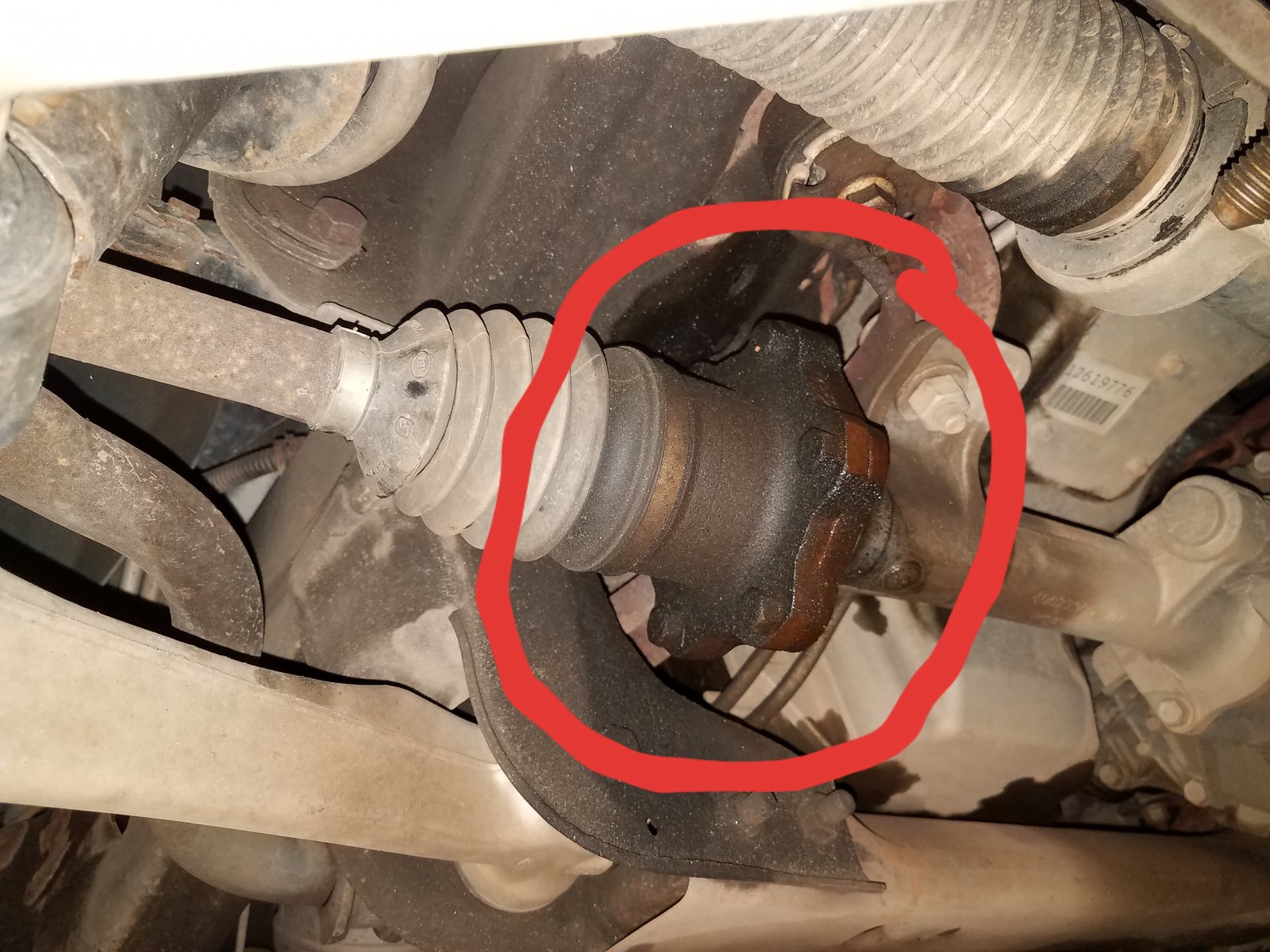

I did, however, find a slight amount of oil seepage on the inboard side of the passenger side halfshaft/cv joint. Other than that, I can't find a single blessed thing wrong.

If I can get a photo to attach to the post, I'll show the oil seepage image.
