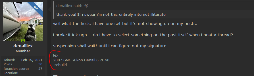

It's showing up:

BADABING BADABOOM! look at me go. moving up in the world. from a TYF newbie to a member with a signature.
albeit - a member who’s still throwing a 10mm around underneath my truck in hopes of continuing to somehow unbreak it. but a member, nonetheless. with a signature.
(i can’t take the credit. it was all @Fless )
