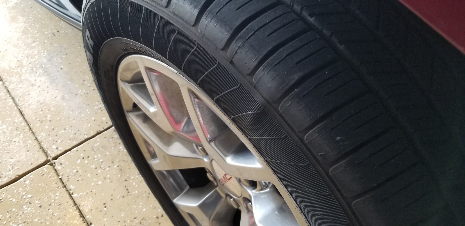

I saw this in the sidewall of the right front tire...Goodyear LS-2, on my 2016 Yukon. Tire has about 20K miles....all 4: are wearing well...but this is the oly tire that looks like this.
Should I take it in or am I being paranoid?

Should I take it in or am I being paranoid?View attachment 223339
Yeah, busted belt. Probably pinched a curb or just wearing out in the Florida heat. 4 years is about it unless you keep it in a garage, regardless of the miles down here.
Def take it in. It's dangerous to drive on, especially on the front end.

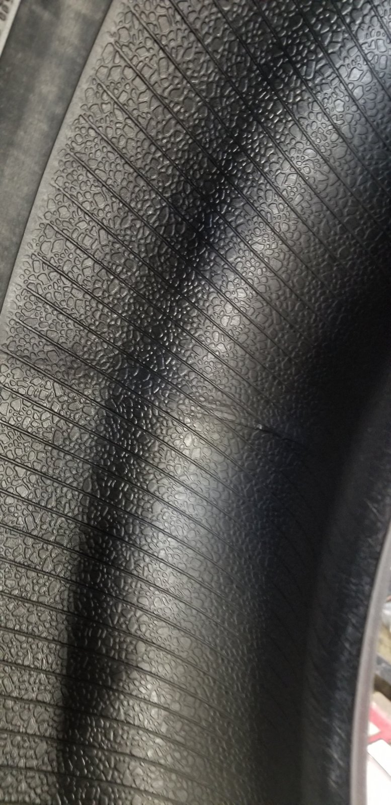

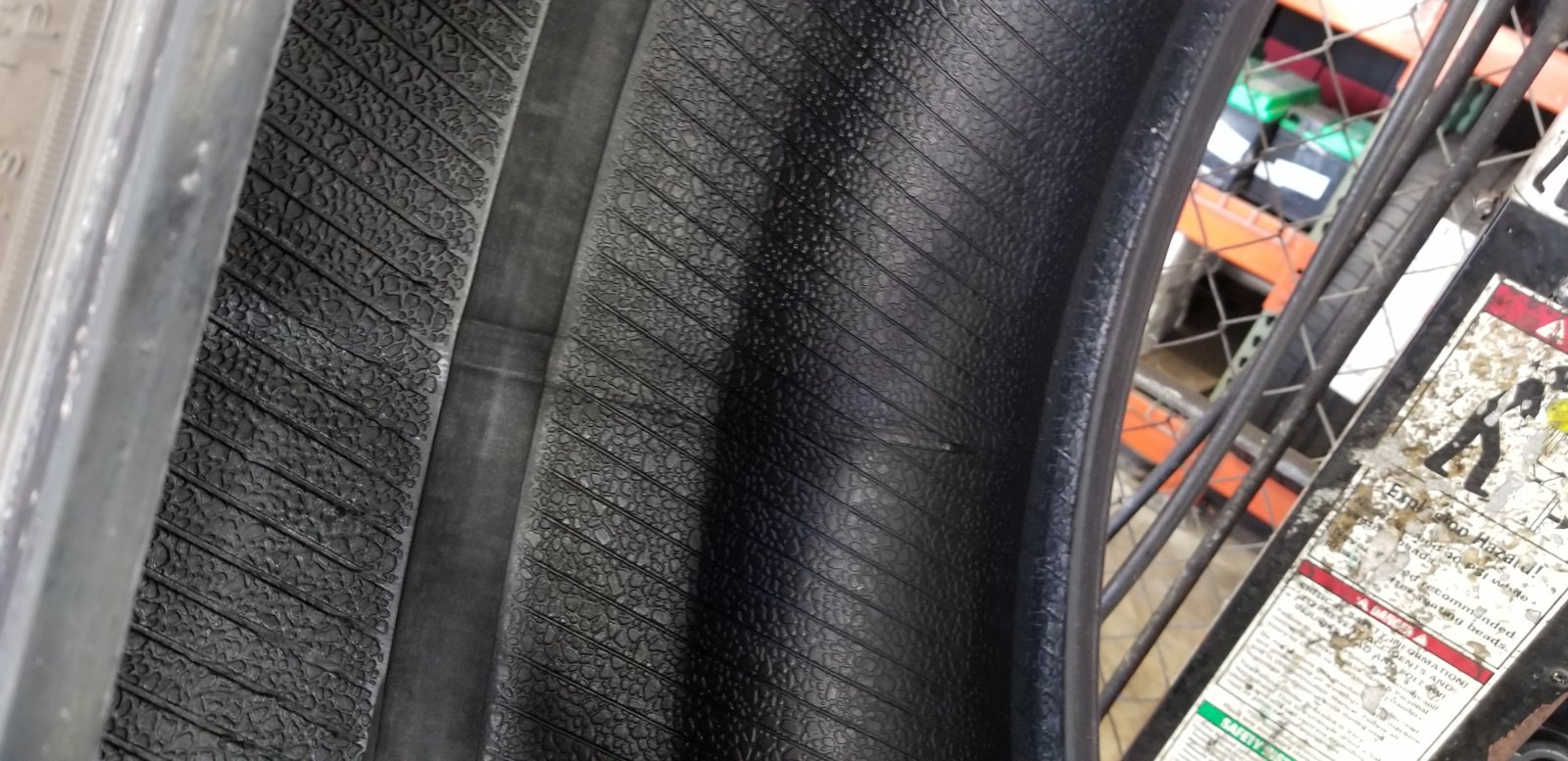

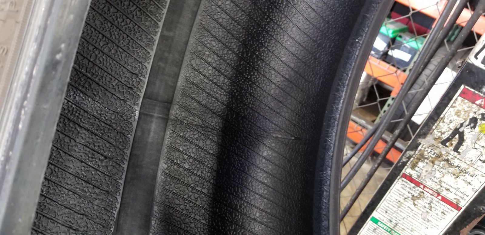

OK...Good Call. Took it in to the Tire Store where I bought the Tires 18 months and 22K miles ago. Here is what it looked like inside. "Widow Maker" !! They gave me 80% credit on the Road Hazard Warranty.
You can actually see where the inner liner was starting to seperate from the carcass !!
View attachment 223521 View attachment 223522
Glad you noticed it before anything bad happened.
