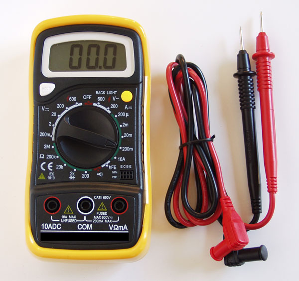

you can go to walmart and get a dmm to test the sub and just return it when you are done if you dont want to keep it, and to test the impedence just turn on the dmm and set it to ohms which is the horseshoe looking symbol and hook the speaker leads to it, we cant really tell you what number to look for unless you find out if the sub has dual 2 ohm or dual 4 ohm voice coils, so ask the seller which voice coils the sub has and how are they wired series or parallel

okay i will... where do i plug the red and black things into on the ddm i have one but dont know where they go ? and where would i put it on the sub...

put the blk lead in the com port and put the red lead in the side with the horseshoe symbol, look at the pic on the first page and the red plug would go on the right, and just touch the red lead to the positive terminal on the sub and black to negative terminal
ok well if they are 4 ohm and there is only one set of wires coming out the box then you should look for about about 2 ohms if the sub is wired in parallel
and if there are 2 sets of wires coming out of the box then each set should measure around 4 ohm
