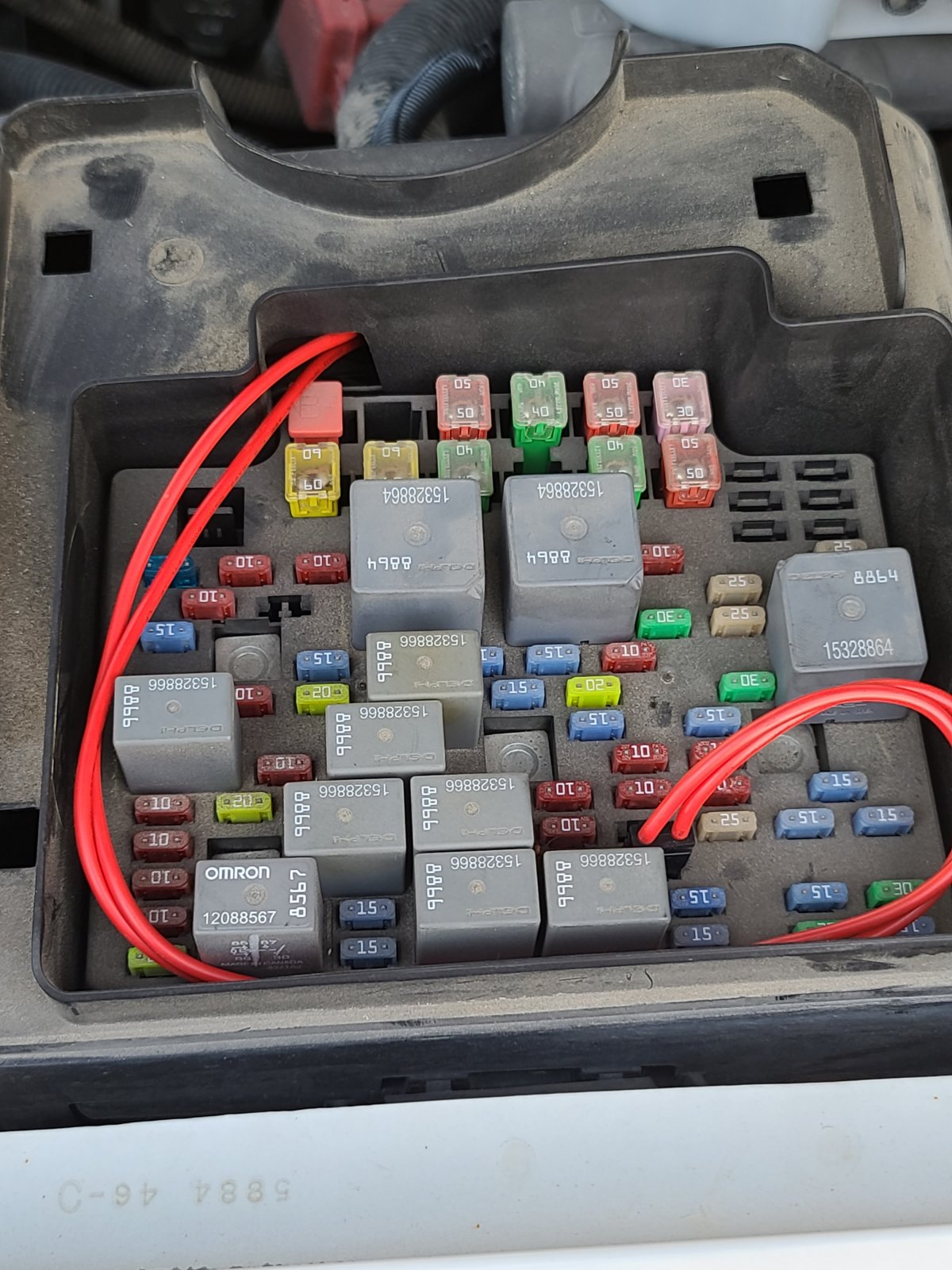

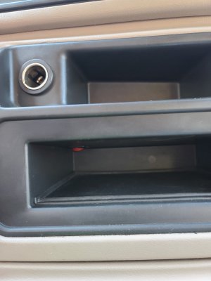

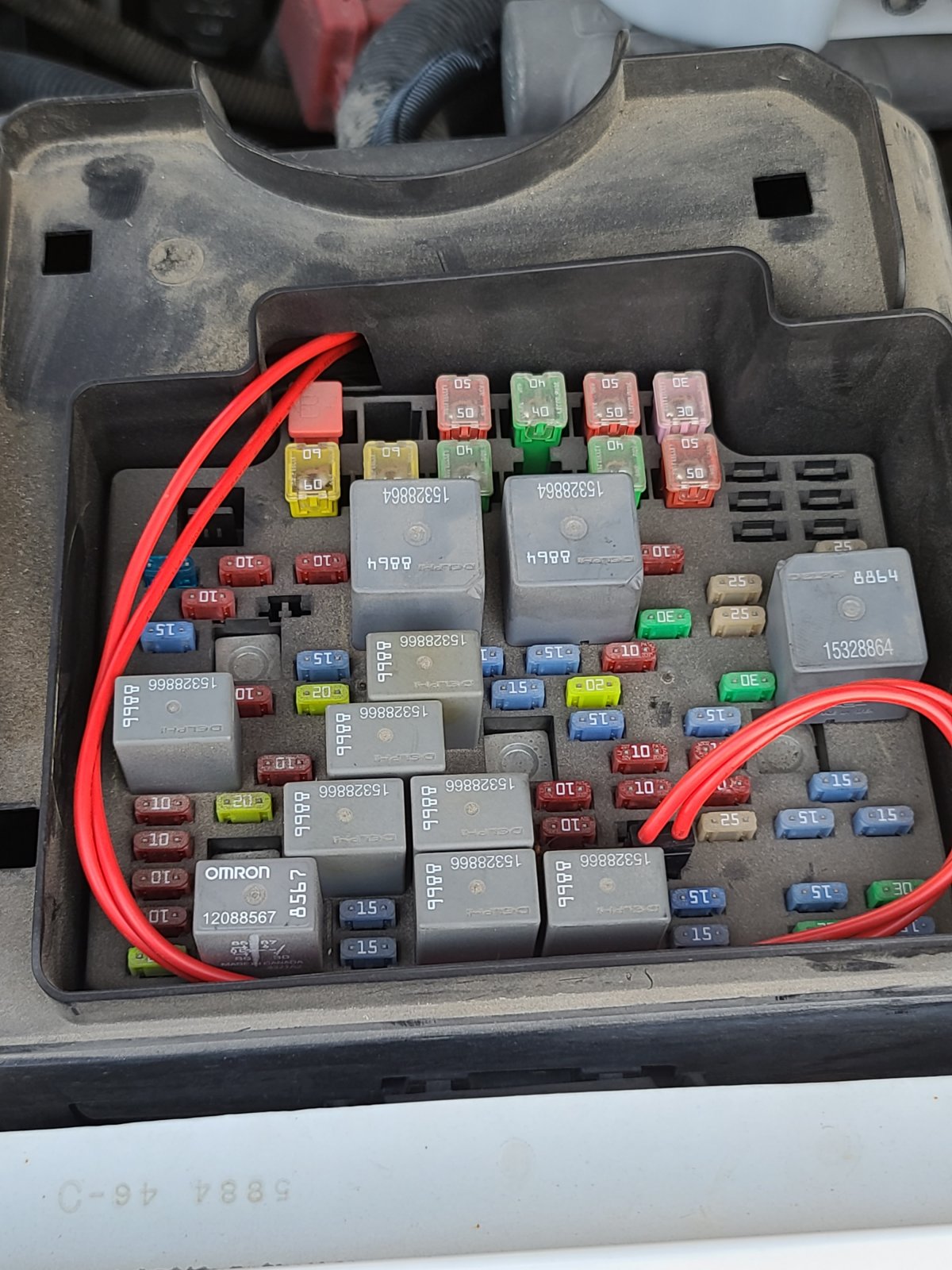

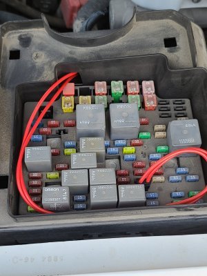

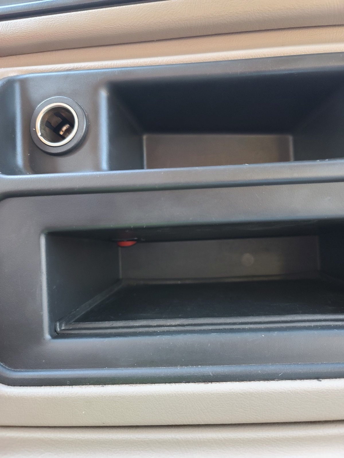

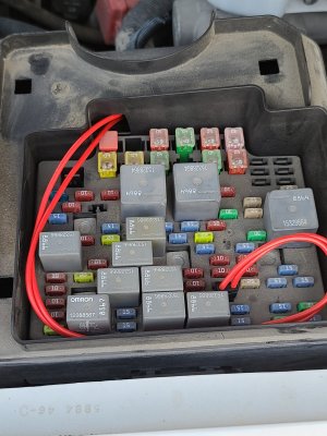

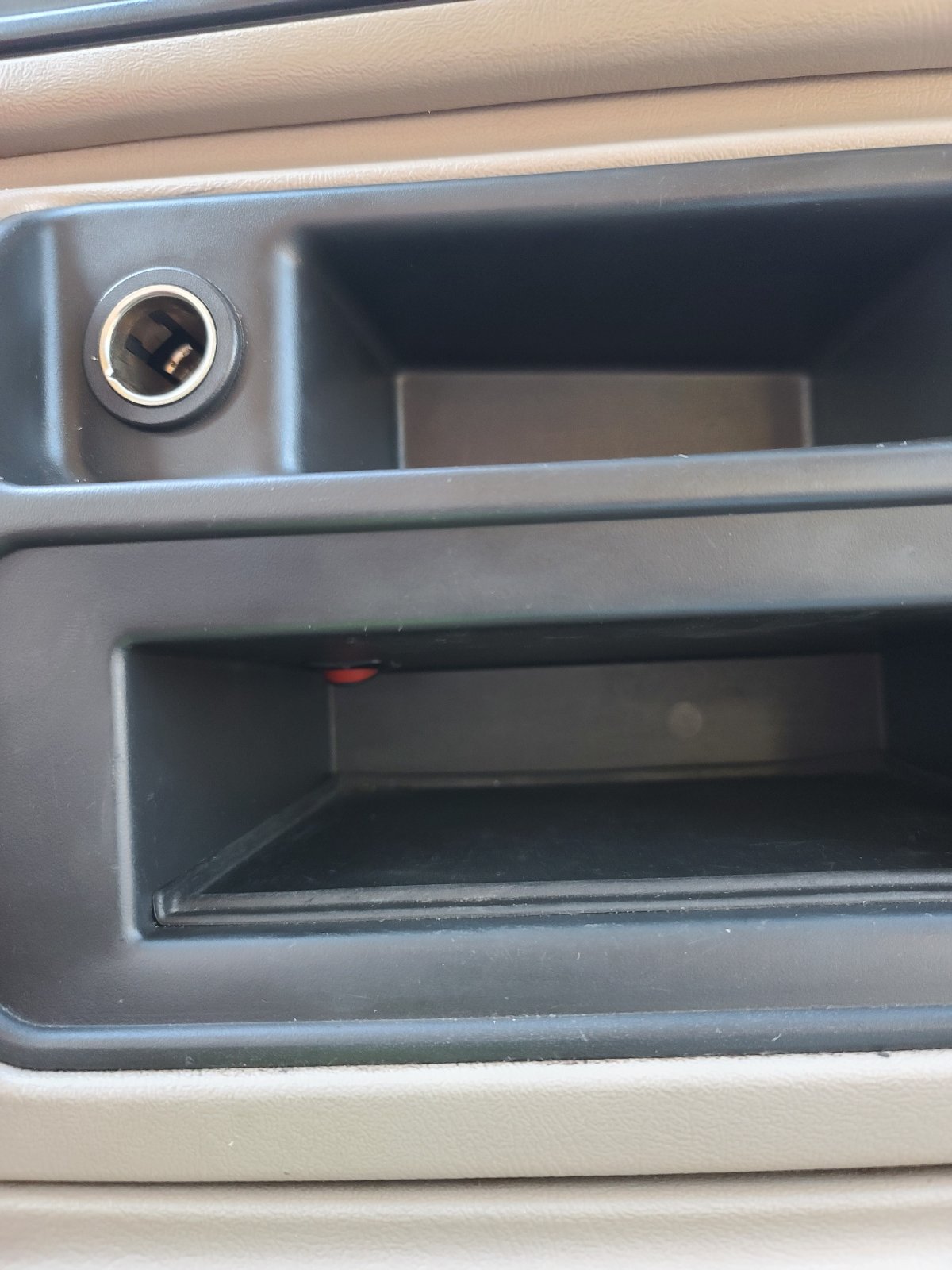

Less than 30 bucks In supplies coming from the crank circuit. Nobody will ever see it Loomed and all. Basically just take the crank fuse out and buy in line fuse holder for it and build a circuit on a switch. Won't crank. Someone wants my junk they can tow it away.
View attachment 276558 View attachment 276559
Thats a good one.....you're a sneeky mofo.
Is that a push button on/off in the cubby hole?
What type of connector is that? the one on the fuse box
Hey could you tell me where you got this fuse/tap wire to install a kill switch?
blueinkd
Nov 21, 2017
646
1,559
It's this one

It's this one
Nice! Thanks!
Did you run the wires into the cabin through the firewall port, then into a rocker switch somewhere near the dash?
If so, how did you extend the wires? Just solder on longer 16gauge wires?
