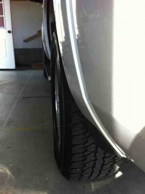

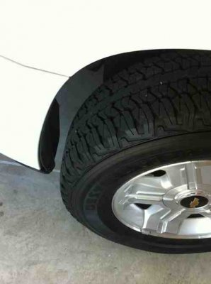

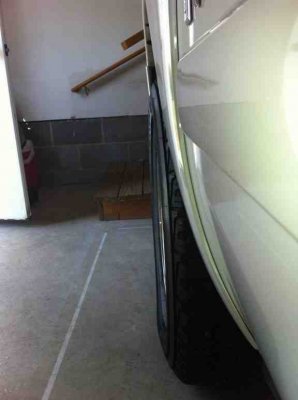

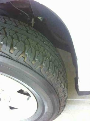

Now that I think about it...Im pretty sure I'm running 275/65/18's. fwiw here are a few pics. I'll verify size shortly.ImageUploadedByTapatalk1367277634.928437.jpg
ImageUploadedByTapatalk1367277655.226142.jpgImageUploadedByTapatalk1367277672.359828.jpg
No lift/stock rims...fender liners were pulled slightly for clearance and I believe they may have trimmed lower valance some. Tire shop used hd zip ties to pull liners and hold in place. I think I'm going to remove zip ties and use a heat gun to manipulate the plastic to clean it up a little.
