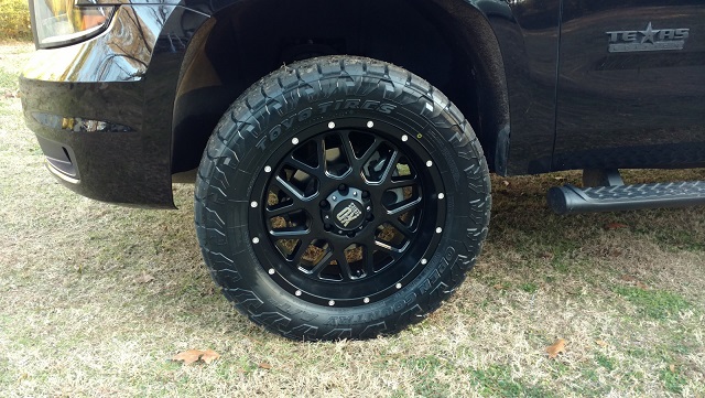

Finally ordered the wheels and tires.
Original Wheels: (Factory wheels)18x8.5 with +24mm offset
Original Tires: Goodyear Duratrac 265/65/18
Replaced them with:
Wheels: XD820 Grenade in Black Satin 20x9 with 0mm offset
Tires: Toyo Open Country A/T III's 295/55/20's
This Tahoe only has a front level block on it (think it's 1.5"), nothing on the rear.
The back sits a little lower, which I hate, it's sitting about 1 inch (haven't measured it yet) lower than the front. I'm planning on pulling the front block out and putting a 3"-4" suspension lift on it.

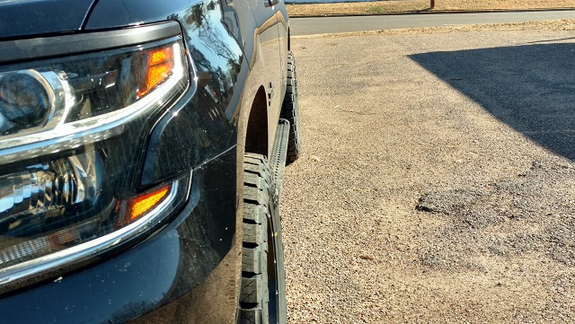

The edge of the tire rubs the inside back wall just a little bit when turning about 1/2 way to full lock. Tires are clear at full turn. Easy fix, when I do it, I will post what I had to do. Most people use a hammer (like a dead blow or rubber hammer) to beat the wall back some, that would work, but that ain't my style.
I am going to cut this little corner off (front corner of bumper skin), even though it doesn't make contact, it's just a little too close for me. In the picture, it looks closer, but it gets about an inch away, during turning.

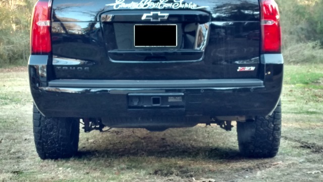

2018 Chevy Tahoe Z71 wheels and tires added with specs Part II
Here are some views of the stagger/poke and how the Tahoe sits now
The exhaust kind of messed up the view of the right side tire, oops...
