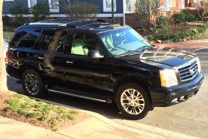

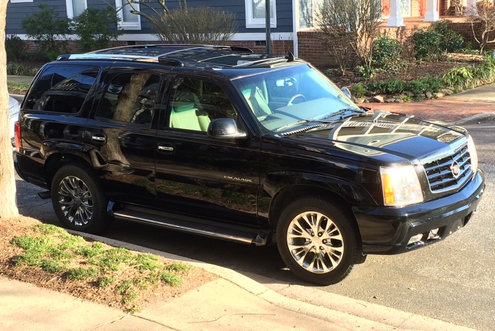

Thanks to this forum I think I bought the best GMT800 tow truck! '06 1-owner Escalade w/ 72,600 miles, black w/ nice 20" chrome wheels, 6.0, 3.73, RWD, looks and drives like new. The only "downside" is that I bought as a double duty truck to replace my '02 Tahoe work truck and also as a better tow truck, but it is just way too nice to use as work truck.
That is a unicorn. Most GMT-800 platforms miles are through the roof.
