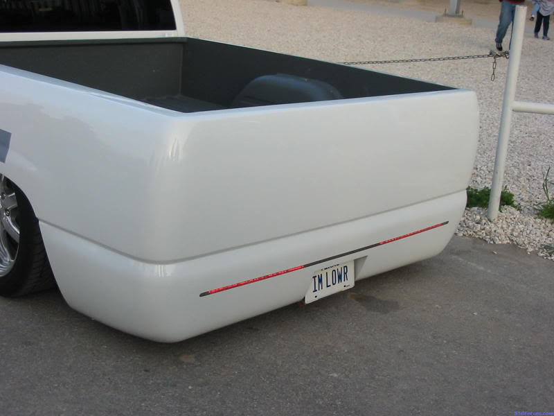

I drove with this setup for six years and did not get harassed(in Texas and Oklahoma). 58 inch wide 5/8 LED bar with 5 sections from one side to the other measuring: 2 inches amber(signal), 18 inches red(brake/stop), 18 inches white(reverse), 18 inches red(brake/stop), 2 inches amber(signal).
Sweet!
Where did you get it, and what kind is it. The only ones I can find around here oly have red lights. Which ever way your turning will flash, but thats about it. Thats kind of the look I want. I want every thing shaved. I was gonna do without reverse lights

Sweet!
I purchased it from HiTech Products... it was about $1100.00, but without the white for reverse it would have been much cheaper. Here is their webiste: http://www.hitechledproducts.com/index.php?cPath=26_34&osCsid=b610137abb5a86f476ebcea31561fd47
