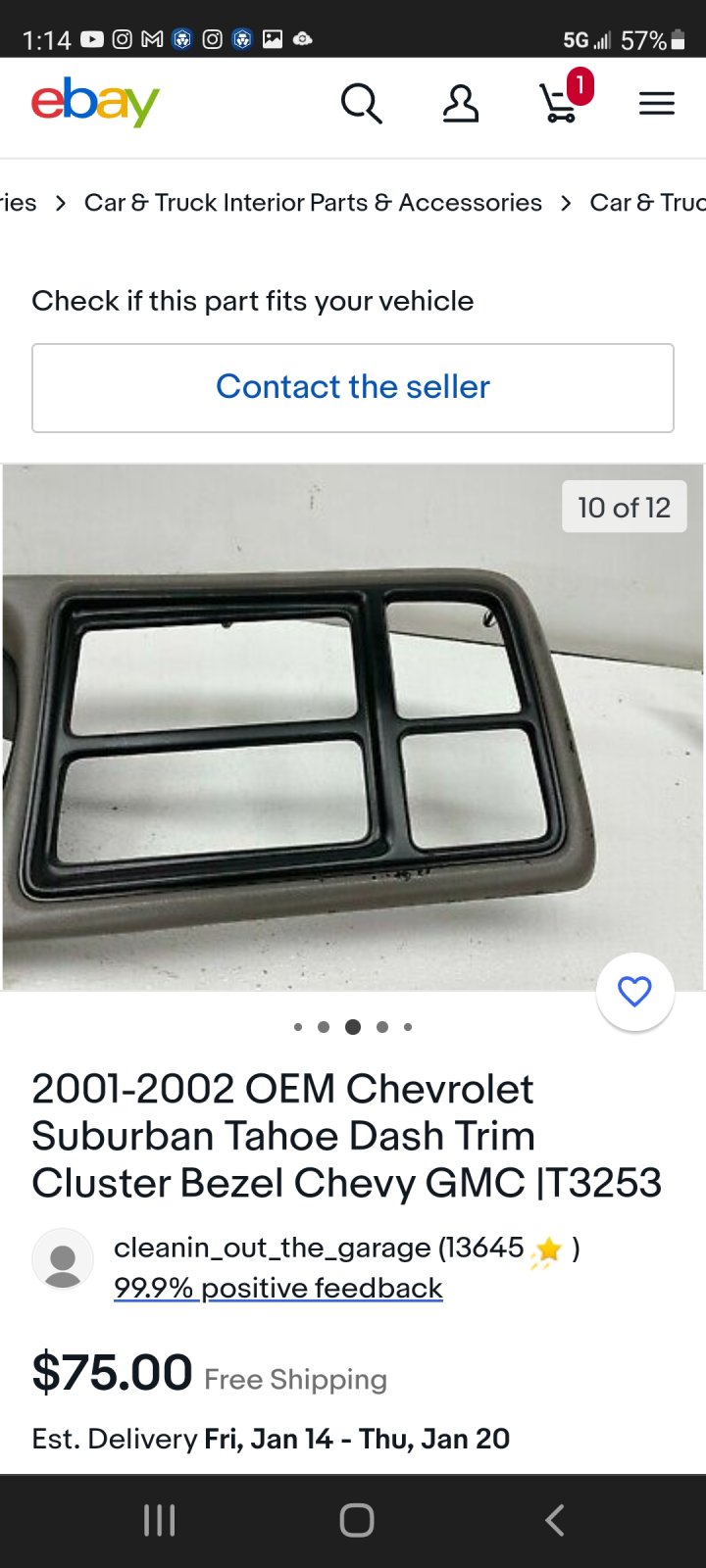

Mine used to look like this
If you look at both pics, notice the plastic lip above the center pocket section. If you use the 2000-03 dash bezel, then more of that lip will be exposed versus an 04-06 bezel. I personally like the 04-06 center console, I feel more can be done with it. In your case tho, with a 12.4 in pad, you'd do best moving both down to the bottom and if at all possible, try and find an 04-05 dash bezel for the extra lower room.
It's hard to tell the difference until you swap from the older to newer. Do you see the slight differences.

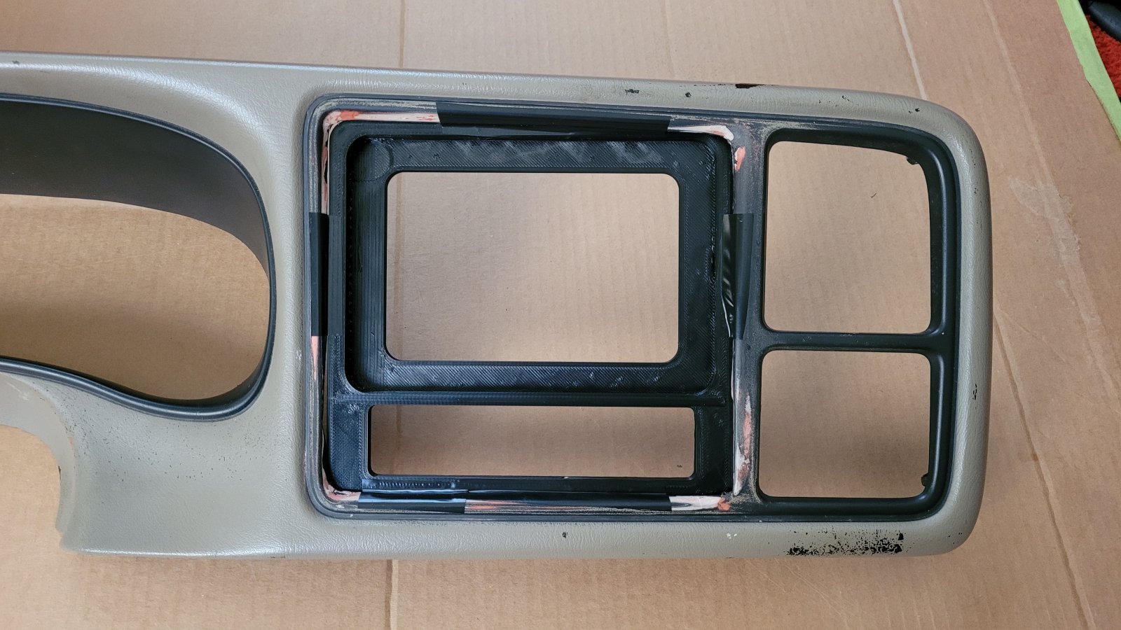

I have an 02 bezel around here somewhere. I'll tray and take pics of the differeces.

In the case of The bezel style differences that will end up making no difference the entire area "inside being all the black colored area has to be removed literally leaves the outer edge a shell . 12.4 inch removes all the black plus some of the gray in order too fit the acrylic slider kit .
Same scenario Steve Meade did for his.... if you watch his install on YouTube . The consoles I do like the squared off look on the Escalade style . I might even go one better and build me one from 1/2" birch wood . And make a new climate panel a radio face area that will sit higher and angled the way I need it and maybe add a center subwoofer and use my stainless l.e.d cup holders i have around. 100 $ materials 4 days work vs 350$ new console ...it's a toss up .

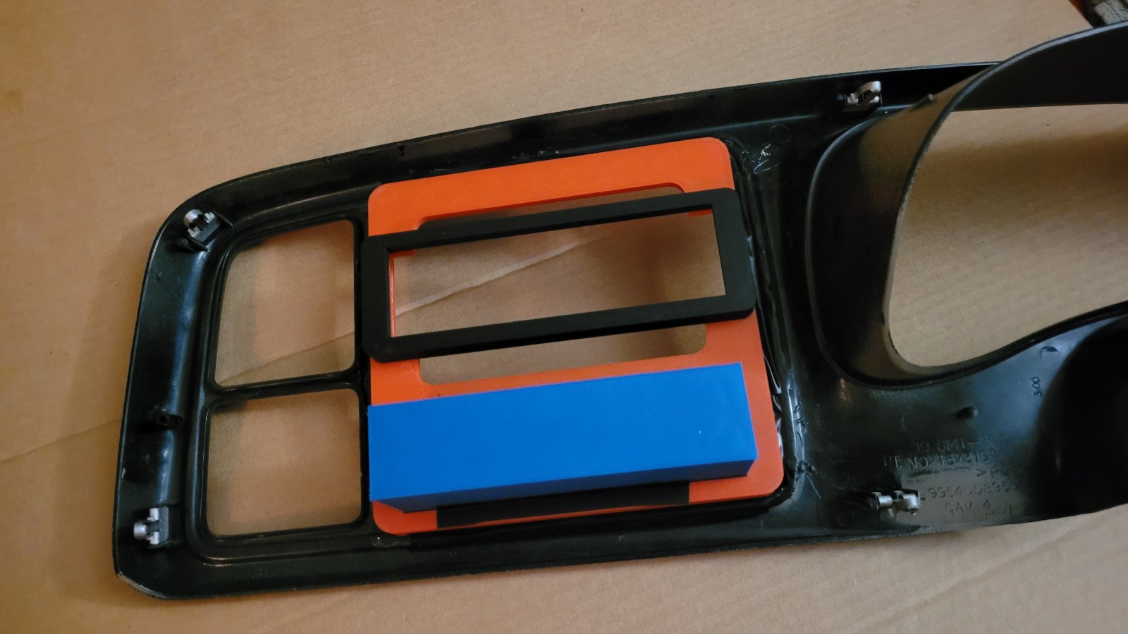

Reprinted a couple parts and this is just mock up. The black piece allows me to put a cdplayer there and the blue is simply a pocket. (00-03 SUV)
