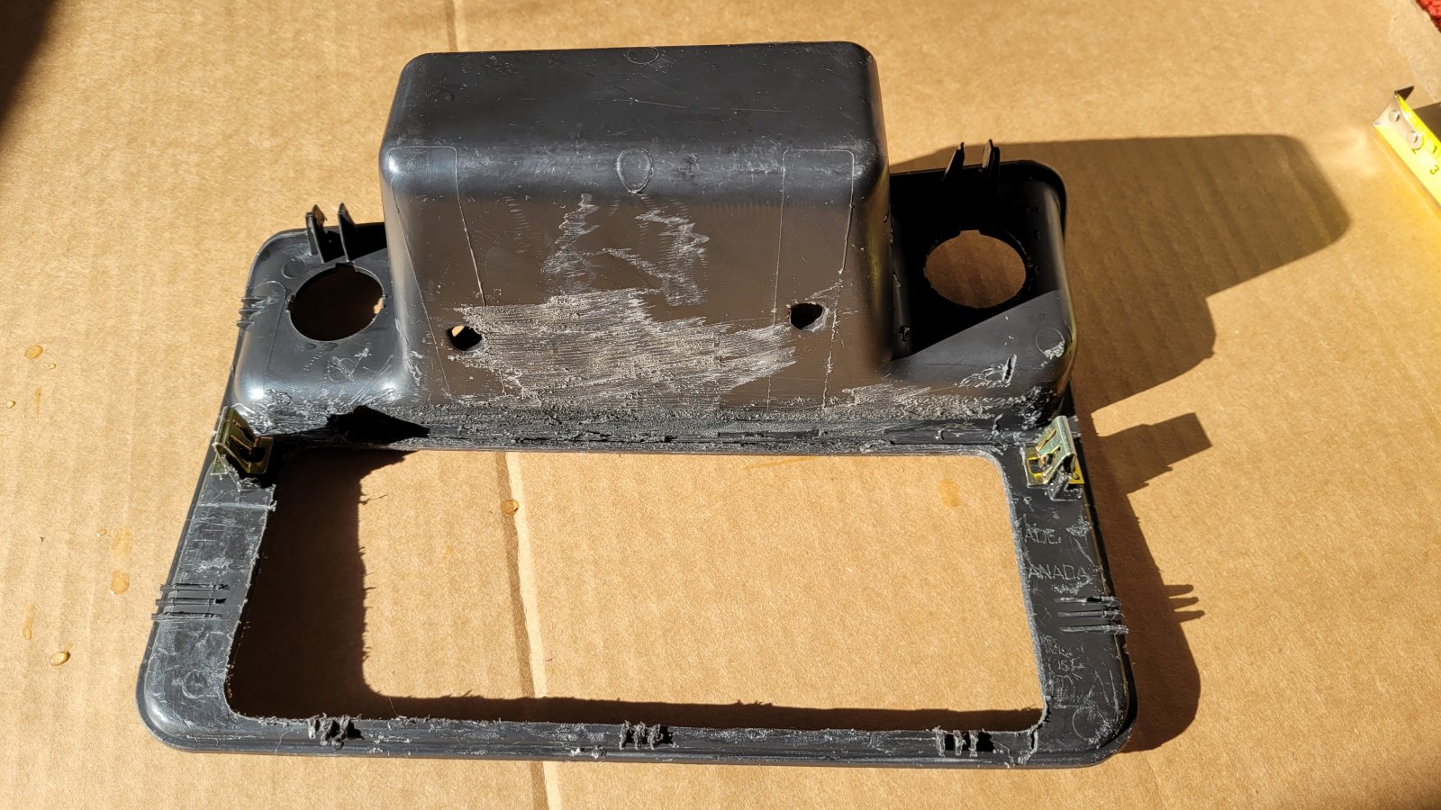

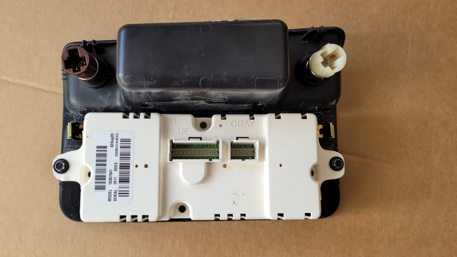

I 3d printed a bracket to hold the ac bracket in place. I'll post a pic of it in a Lil while.

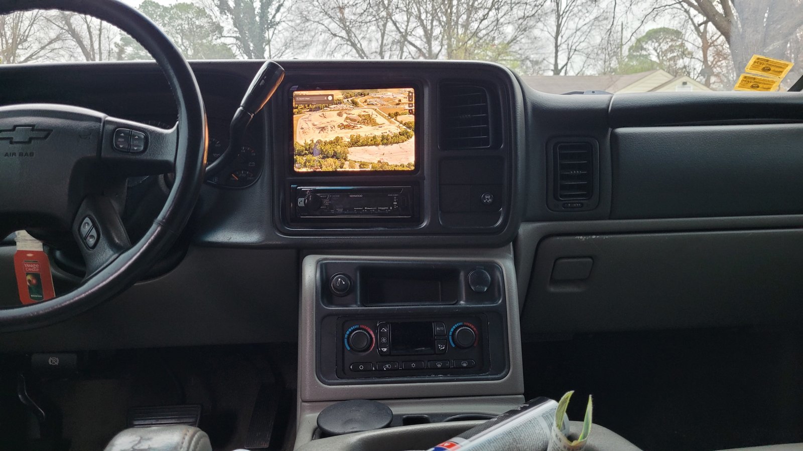

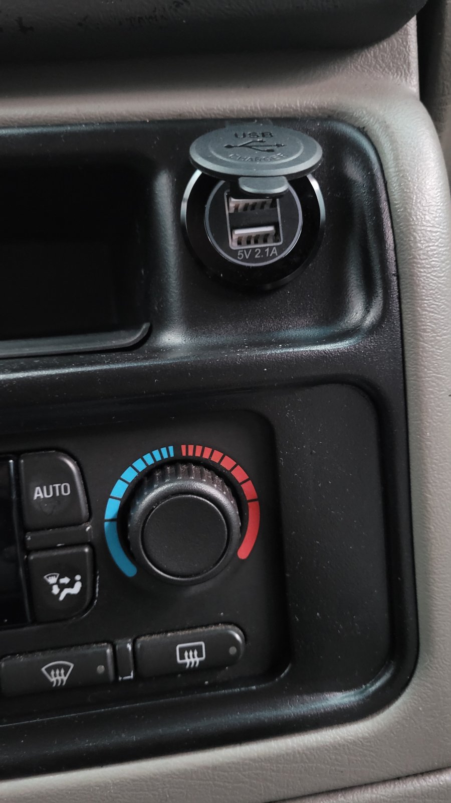

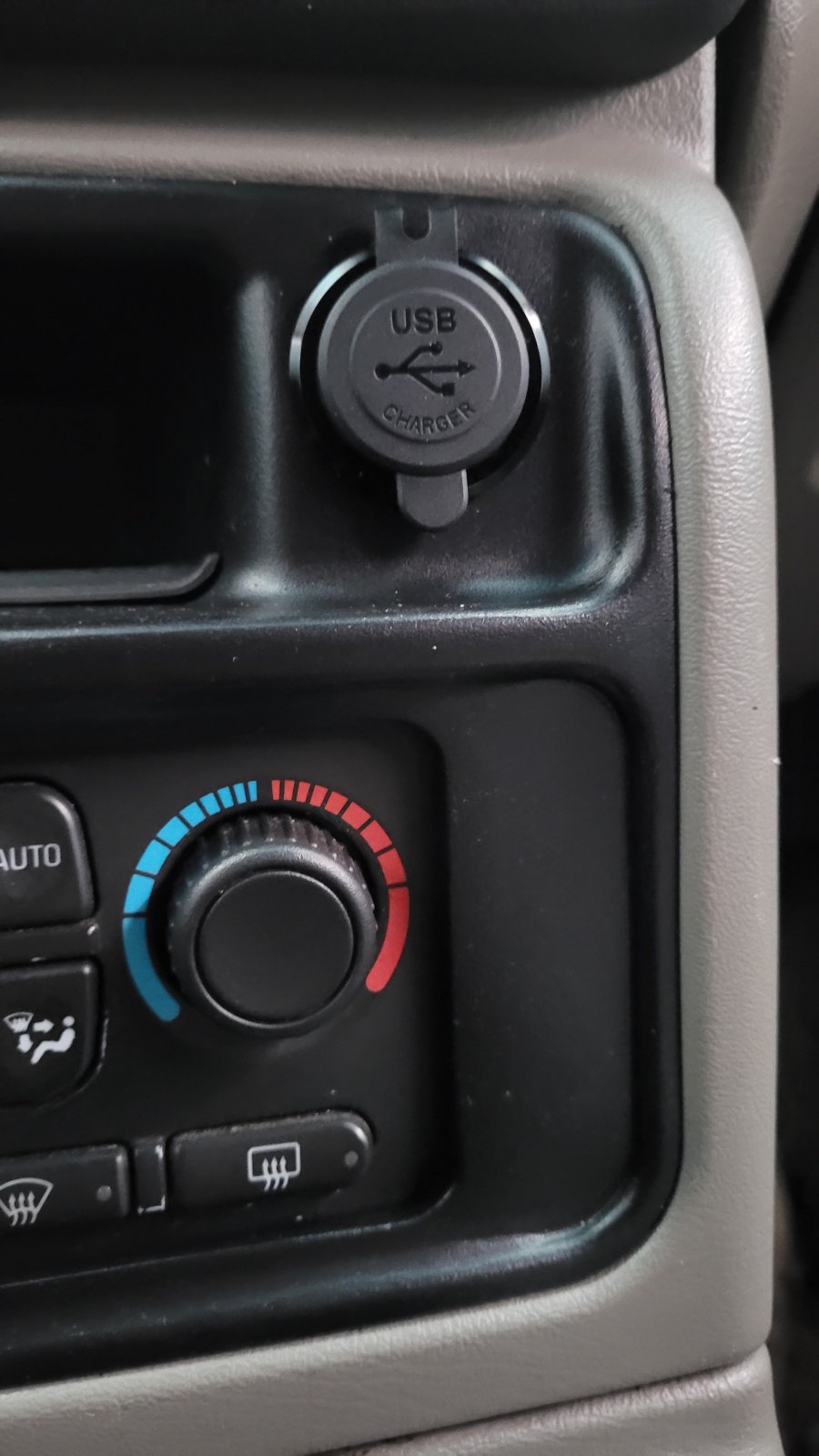

I did away with the old charging port and installed a dual USB one. The black paint on both the dash bezel and the lower ax bracket is just PlastiDip for the time being.
By all means, let me know what you guys think.

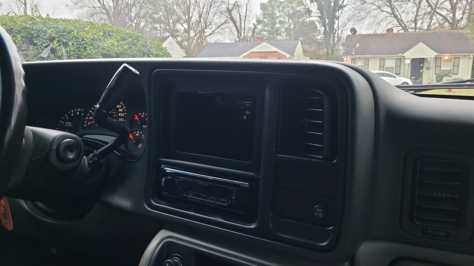

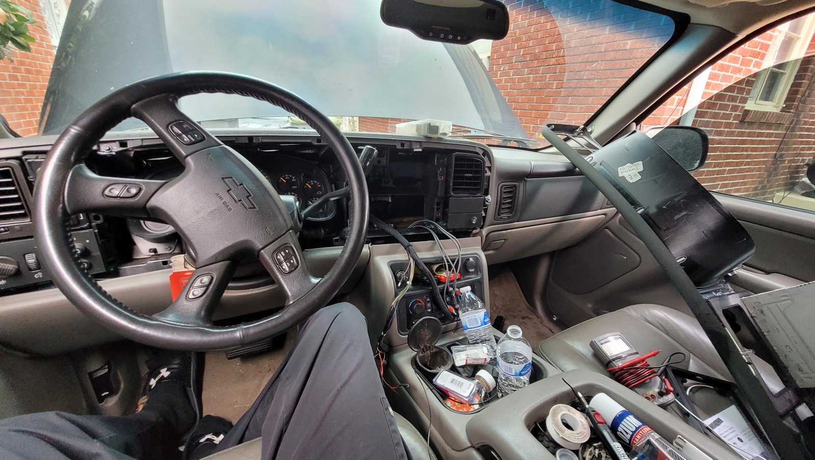

That looks great. So what will the tablet be used for? To stream music? Videos? I like it!
I drive trucks so I use this one in both vehicles. It's mainly for nav and entertainment purposes. But I also draw and edit videos etc so I can be used in that way as well. I just didn't want the "trouble" of a double din (as if this were any easier lol). I appreciate it though and feel free to send your dash bezels my way lol. I'm working on one for the 2000-03 tahoes too (they have a shorter bezel that doesn't allow a lower cd player space)

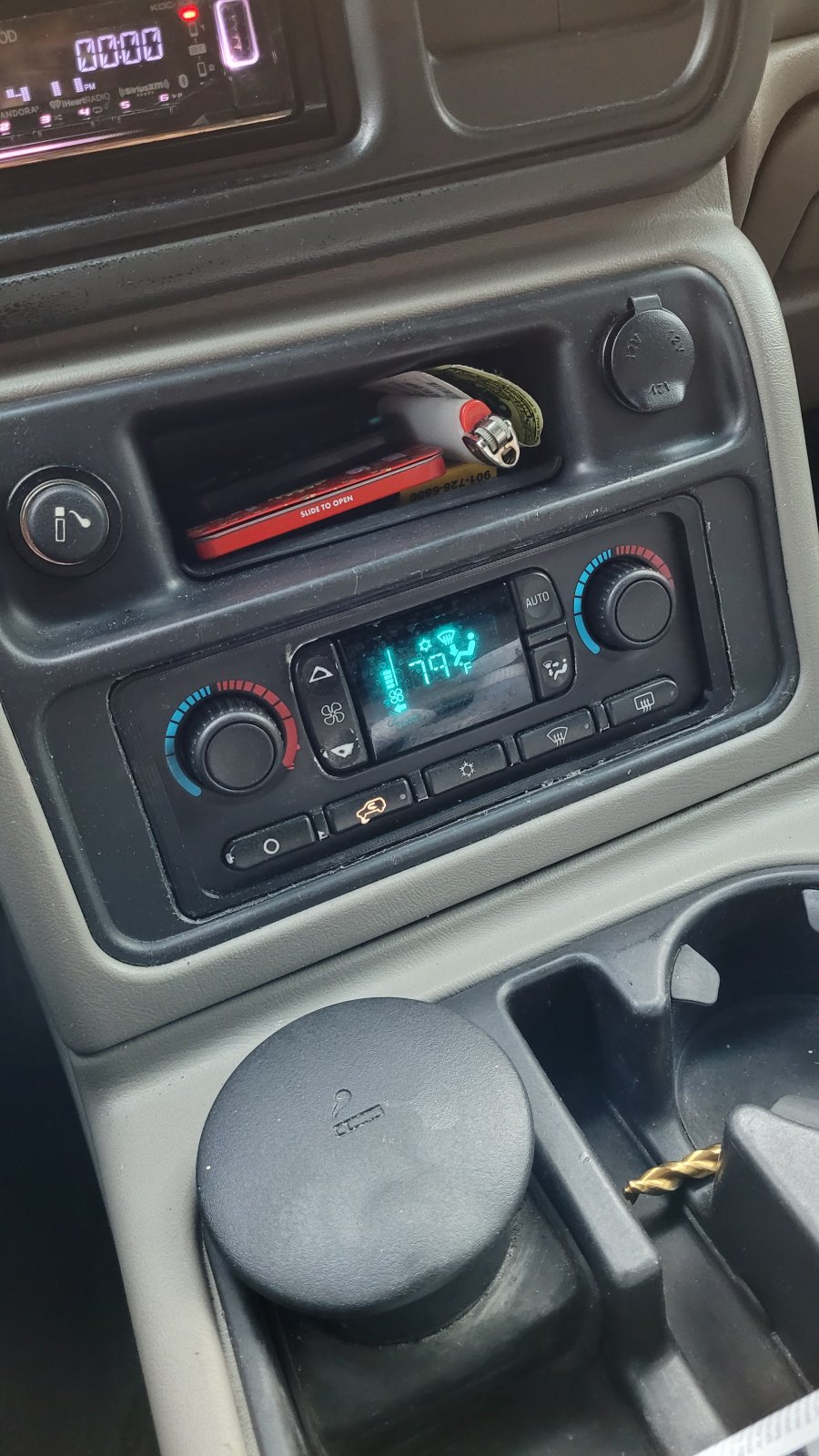

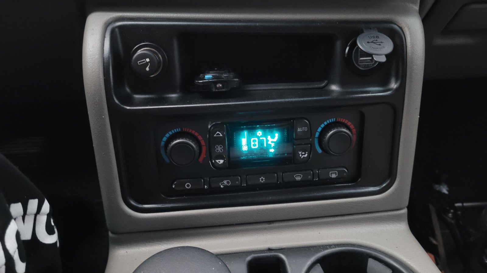

As far as I've seen, the 99-03 dash bezel is actually shorter (top to bottom) by maybe an inch or so. I can put a 2000 Chevy bezel on my 06 no problem, it just won't sit like it should with the 06 center console. I moved the ac controls to the lower pocket of the center console so that I could put my cd player there.
Can you post any pics of the tablet or kit in front of the dash?
If by console you mean the whole center part (armrest, cup holders, lower pockets and cig lighters) then yes I believe you can swap the 06 style in there. The ac control is a different story. I don't know if you can go from a 2000 to a 2004. I don't know if the plugs are even the same.
All of the ac controls regardless of year were in the same place, under the factory radio. (I think)

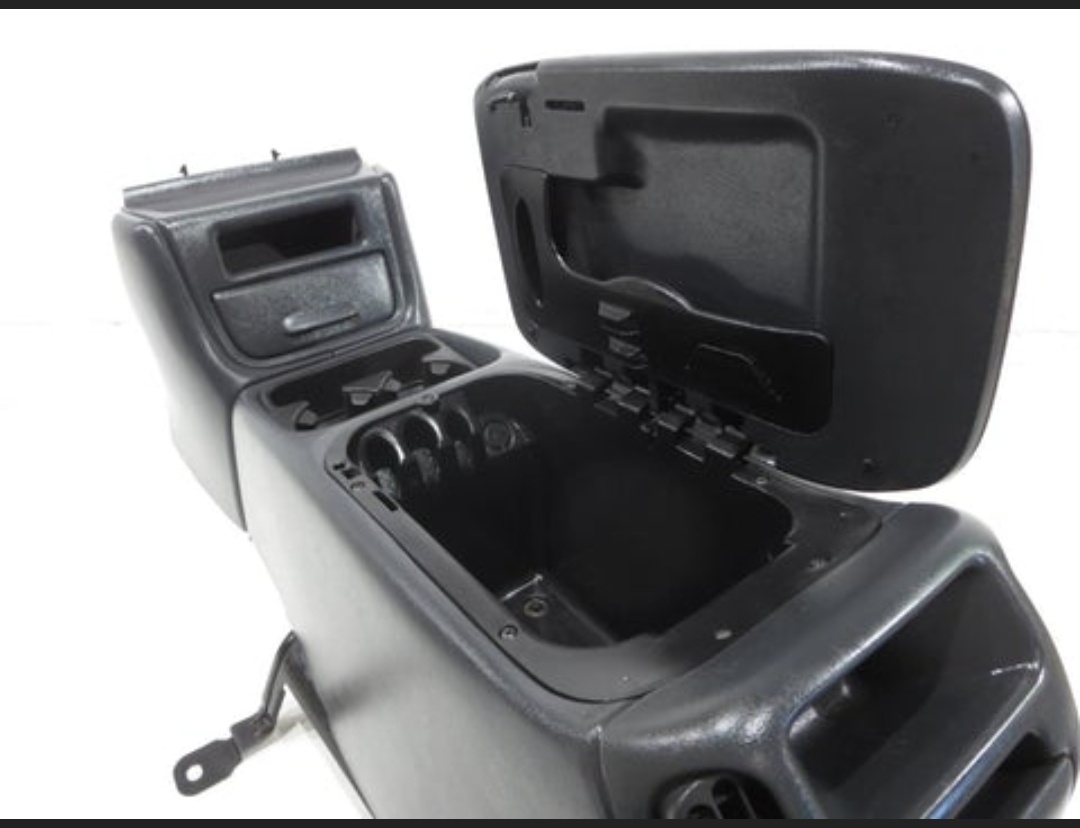

I'm pretty sure I'm just gonna have to lower mine from the bezel down into my factory console area ...in which I've listed a pic of 99-02 style ... and just cut out the dimensions and recess from behind the OEM climate panel . And then below that cut out spot for my single din cage . I can make any type of brackets from the backside and Plasti weld .
If the 03-06 or 04-06 style "ENTIRE Console isn't gonna seam correctly or contour and fit flush too the dash I'm my 01' it isn't gonna look right on top of the issue with the 03-06 style climate panel not being compatible with my plugs .
Below is 99-02 like I have . If you look at the pocket and the flip door that can be cut out easily and fitted with the climate panel and a radio . It just would been easier to swap too the style that had the HVAC opening in the console .

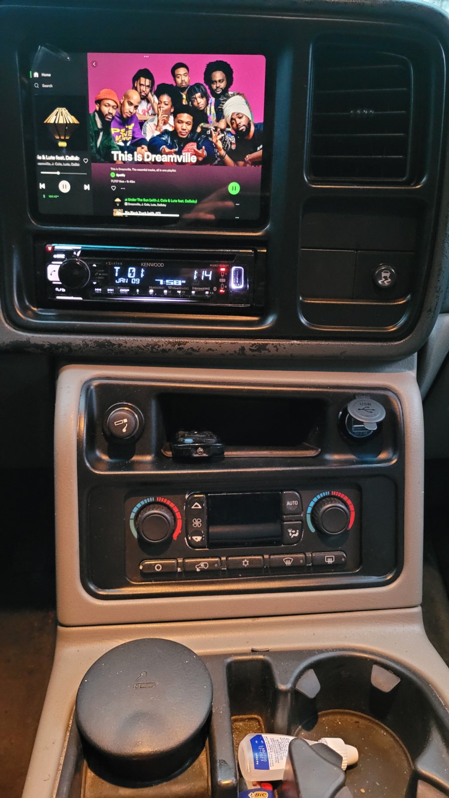

This is just how I did my 10.2" ipad in my s10. I relocated the climate panel up and flush mount behind the tablet and fabbed the Radio below in the factory location for the climate panel.

I've seen people move the HVAC and cdplayer down to that spot before and I looks decent. I think it would look better using an 03-06 escalade center console like this
Mine used to look like this
If you look at both pics, notice the plastic lip above the center pocket section. If you use the 2000-03 dash bezel, then more of that lip will be exposed versus an 04-06 bezel. I personally like the 04-06 center console, I feel more can be done with it. In your case tho, with a 12.4 in pad, you'd do best moving both down to the bottom and if at all possible, try and find an 04-05 dash bezel for the extra lower room.
It's hard to tell the difference until you swap from the older to newer. Do you see the slight differences.

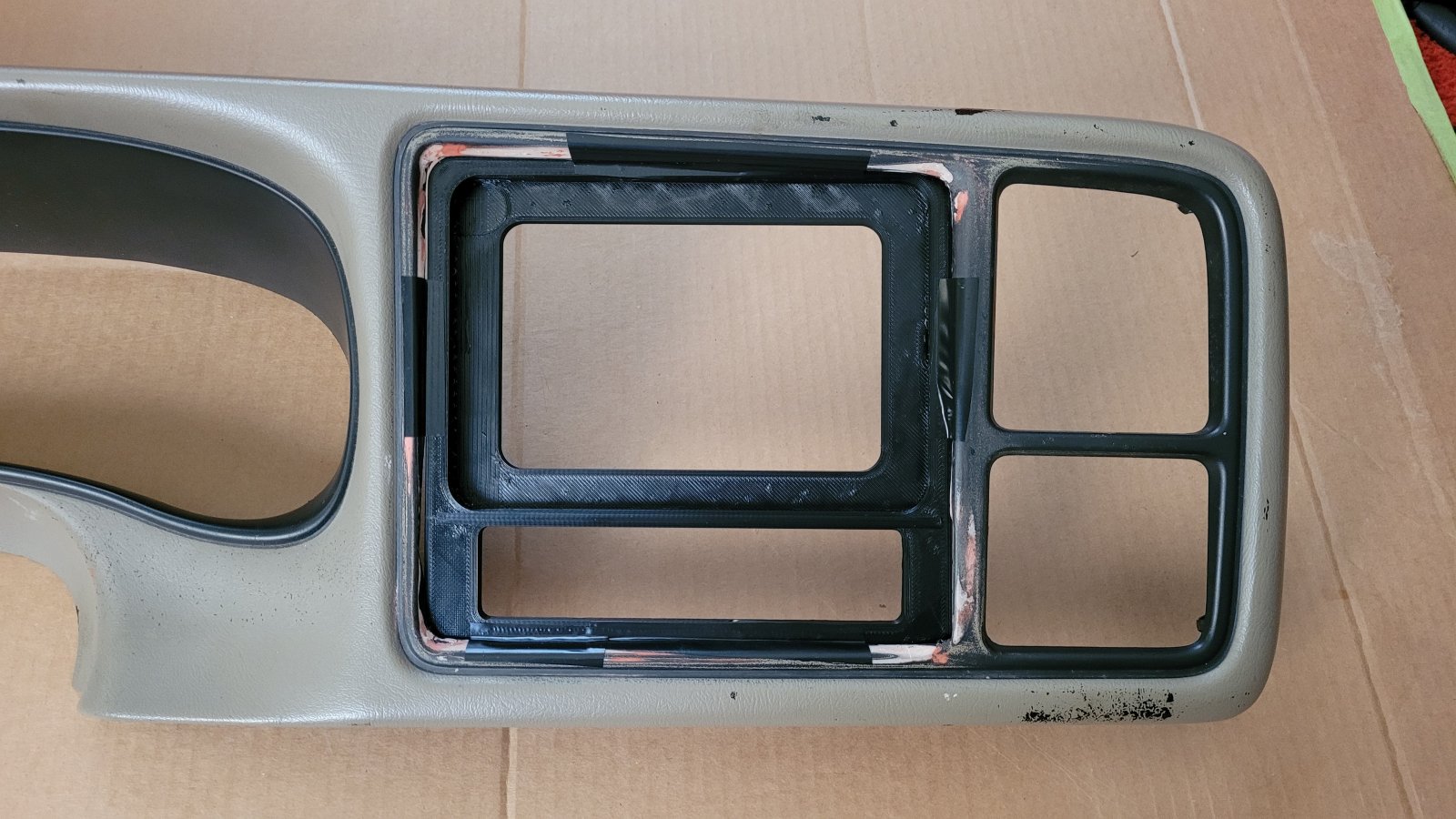

Reprinted a couple parts and this is just mock up. The black piece allows me to put a cdplayer there and the blue is simply a pocket. (00-03 SUV)
