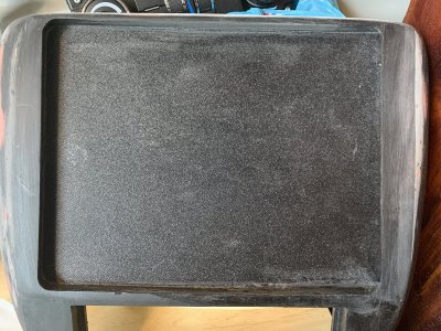

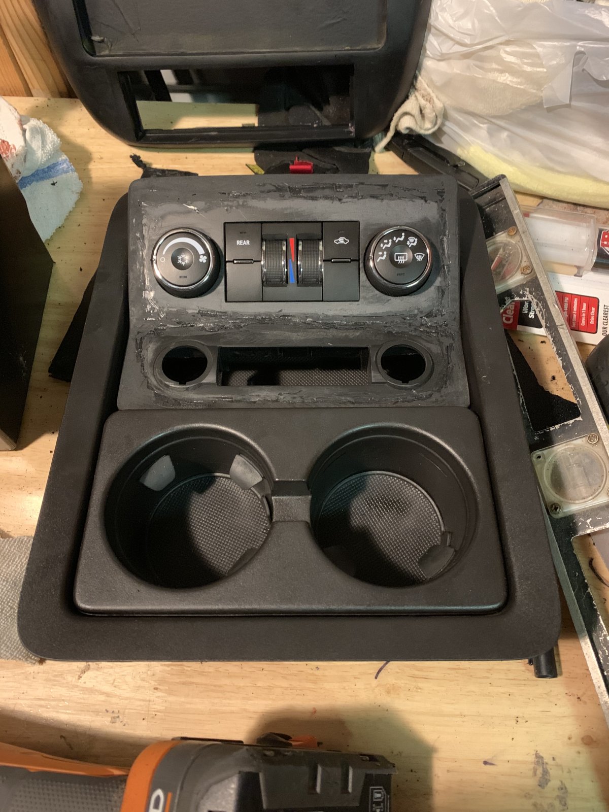

65CDA734-B661-4F2A-B359-AB06220819FF.jpeg 93A5D16B-289B-4321-B928-1CFD60C23958.jpeg 1D46D73C-9908-47C4-998C-FE1E2B539BFB.jpeg 3CB98CB1-0DCA-4B3E-A7FA-2A27FAB4A9AC.jpeg 71139A50-9F1F-43FB-8D88-78334BD4E5EA.jpeg thought I’d share my version of the iPad dash. It’s still a work in progress; let’s see if I can figure out how to post pics of my progress..... lol

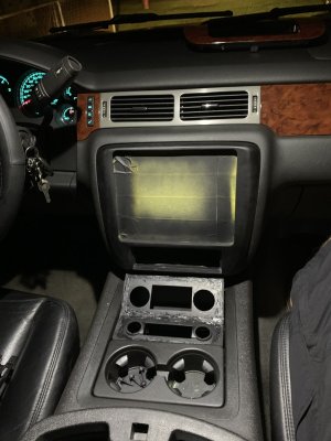

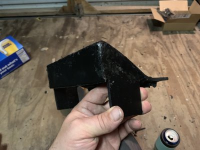

This is as far as of gotten as of now. Once I finish getting all the pieces nice and smooth I’ll be getting that wrapped in matte black vinyl. Also going to do all of the rest of the interior trim pieces in black matte. I don’t really care for the wood grain look, and I really don’t understand why they put those couple of brushed silver pieces in there either. I think all of that will look much better in matte black all matching. 68431EA6-E4A1-4837-8512-443AAF14E399.jpeg D1E2726B-98E0-4DCD-88AB-9F373053FCE2.jpeg 7303718C-E0EB-4D2F-865C-D32B22C3EFCB.jpeg 7989EBFB-EE31-4CF2-8C22-A0C3E4A1543A.jpeg 0FB19156-93A2-4F19-9513-469B4AB2268F.jpeg

Very nice work and fabrication! Looking forward to the finished product. Good luck!

Thanks y’all!!! It’s taking a while to get it done with work/life, but I’m getting there. I’m not extremely happy about having to cut all the A/C control wires to extend them, but it is what it is. I tried to find some kind of extension harness with no luck.

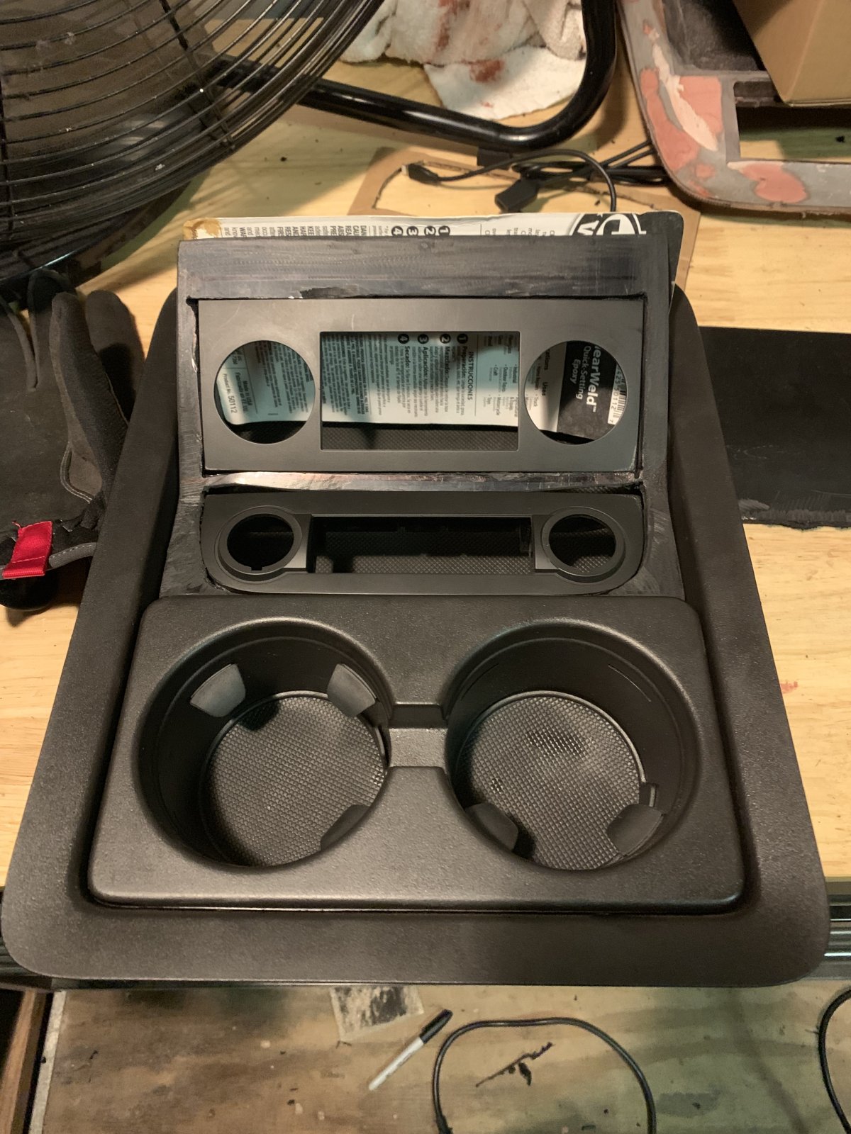

image.jpg Getting a little more done today.....
SPL Cartel bass knob will go in for the subs coming soon. 2 SA12’s in a ported box behind the 3rd row. I wanta get this dash done first before moving to that. I think dual batteries/big 3 and components will come before the subs. Wiring for the amp/subs will be done at the same time I do the batteries/big 3. image.jpg

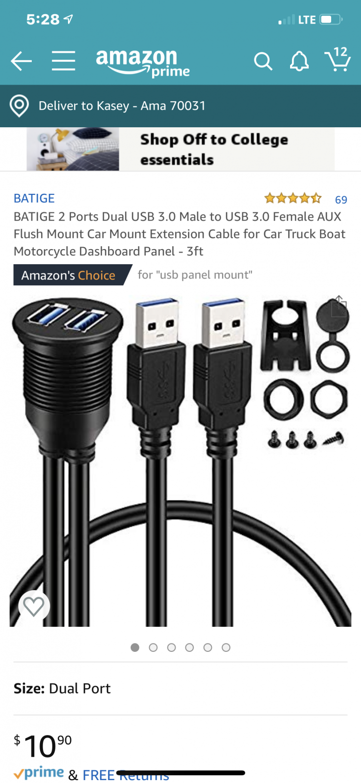

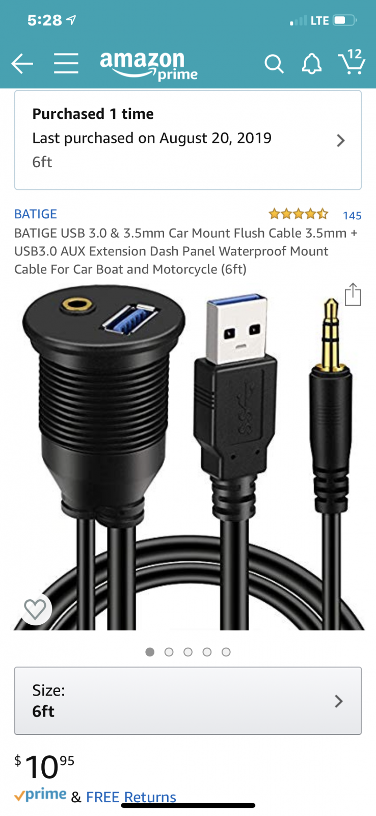

Headunit will be Pioneer DEH-80PRS. Components will be hertz Mille 1650. iPad will hook up with charge cable in the dock to the rear usb on the headunit. Steering wheel controls will work. The other USB port and rca in on the back of the headunit27F3C31E-00D9-4E73-B37B-1BE740C0D6D4.png D62949CB-F6DD-439C-94F8-CAB1A031C218.png will tie to a usb and aux port which will be in the console.... I’ll attach a pic of both of the ports that will be in the console portion.
The iPad gets power from the headunit and is jailbroken and set to where when it loses power it auto locks, and then when it receives power it Auto Unlock’s and resumes whatever it was doing when it locked. So basically when I start the truck it will be open and ready/playing music. When the truck stops the music stops and the iPad locks and turns off.

Headunit will be mounted directly under the iPad. Notice the single din cutout slot on the dash bezel under the iPad?
