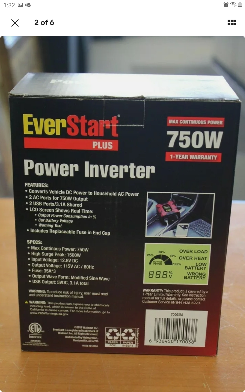

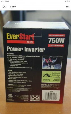

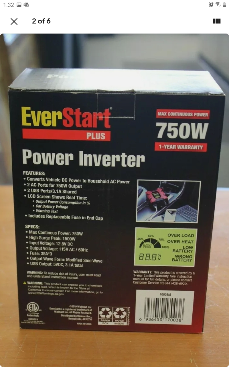

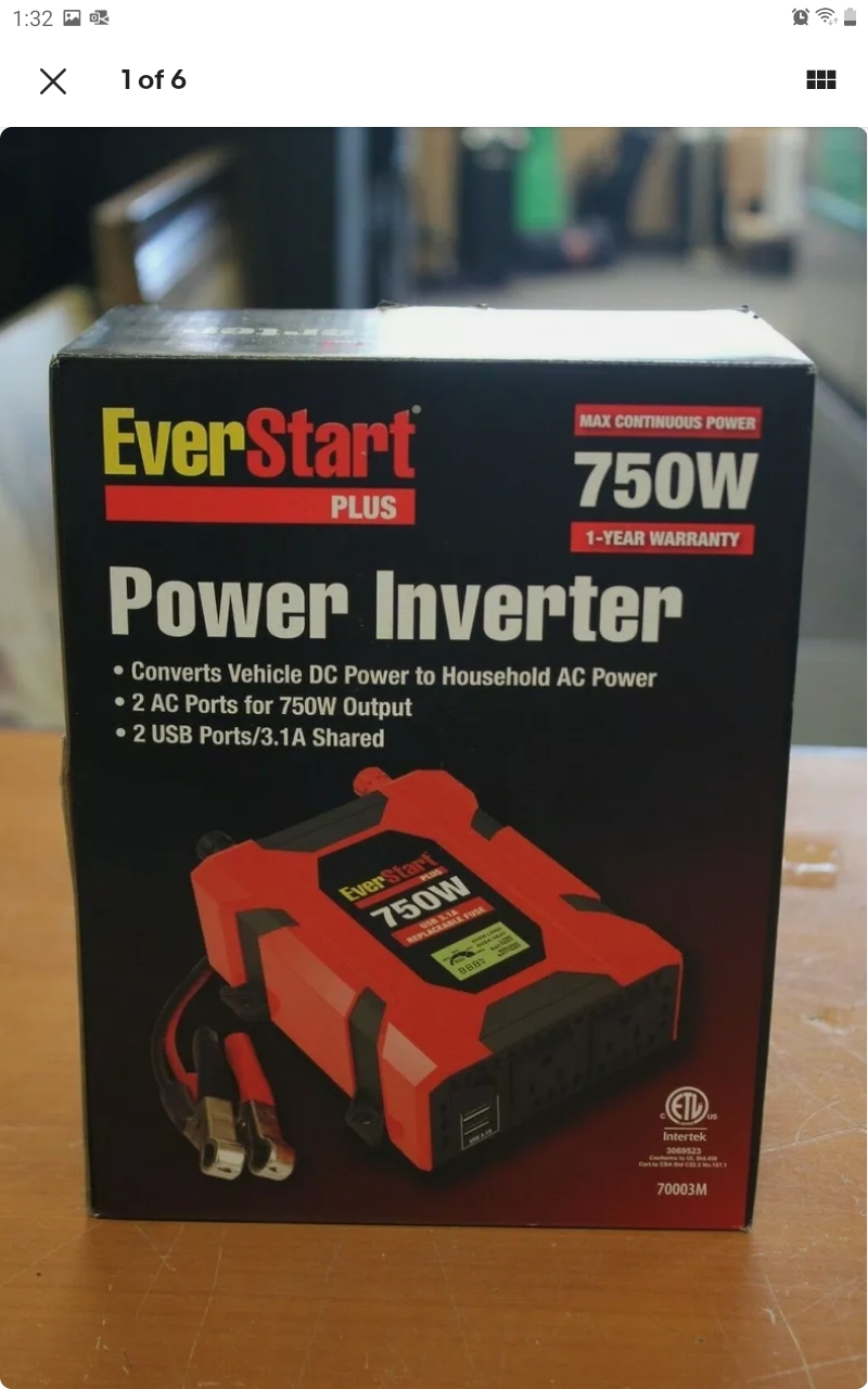

This is the one I have.

It claims 750W max continuous power. So if you are going to connect things to it that will pull that much power, you will need a 60 amp fuse, otherwise you'll be blowing fuses when everything else should able to handle it. If you are just occasionally connecting a laptop or similar things that are much lower power, then you wouldn't have any problems with a smaller fuse.

I'm going to install the 60am fuse then. Thx
