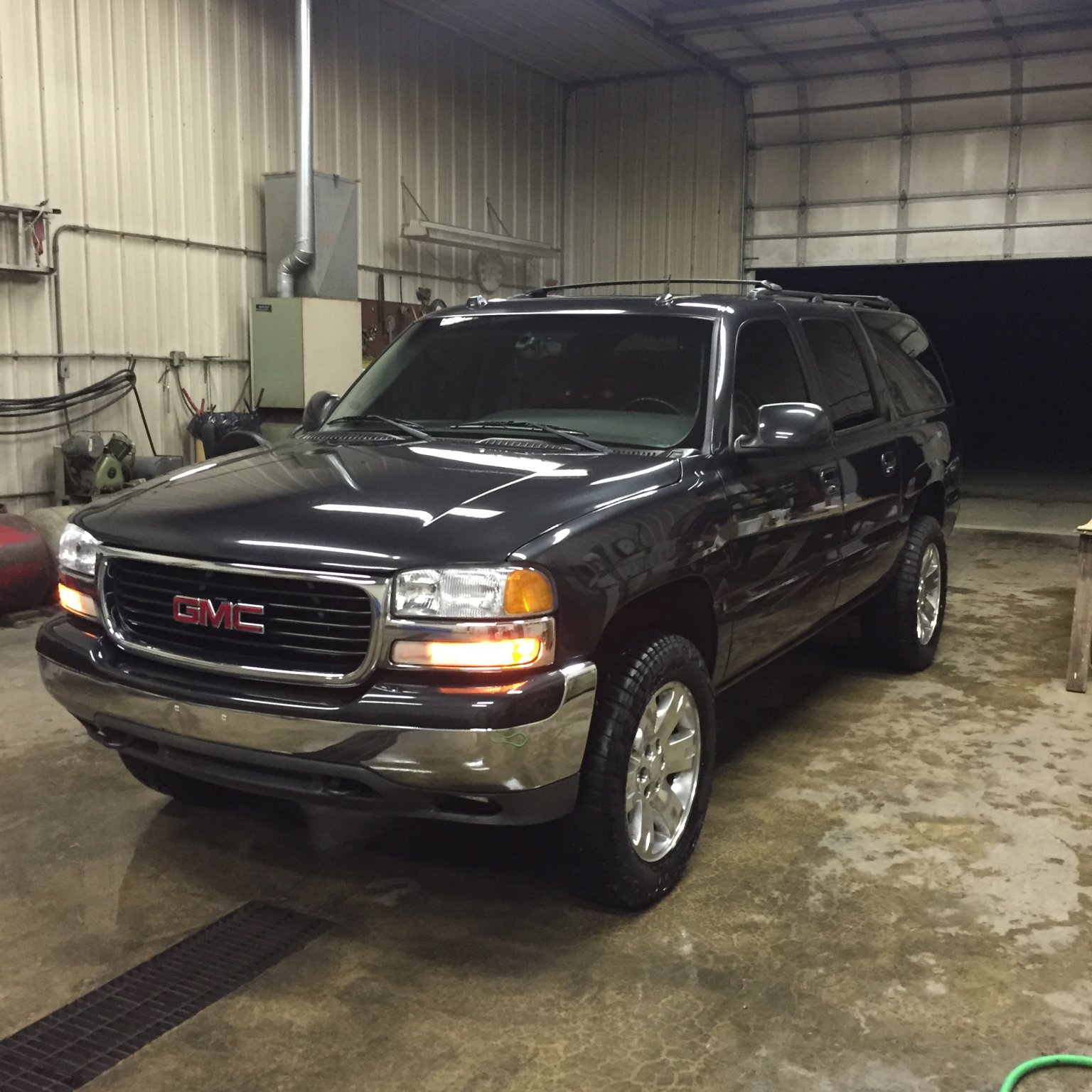

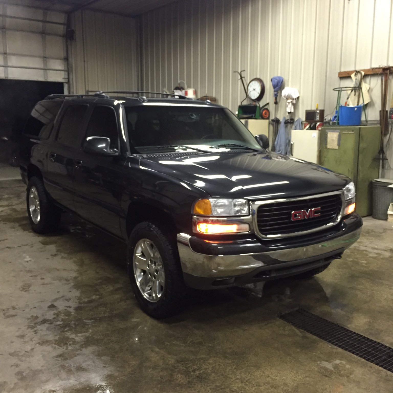

After what seemed like an eternity of waiting, I've finally got the wheels and tires on. I'm very happy with the look. Also, I'm debating on spacers... but idk.
View media item 26285
View media item 26286
Looks great!!! I'd go with 1.5" or 1.75" spacers. Here's mine with 1.5"

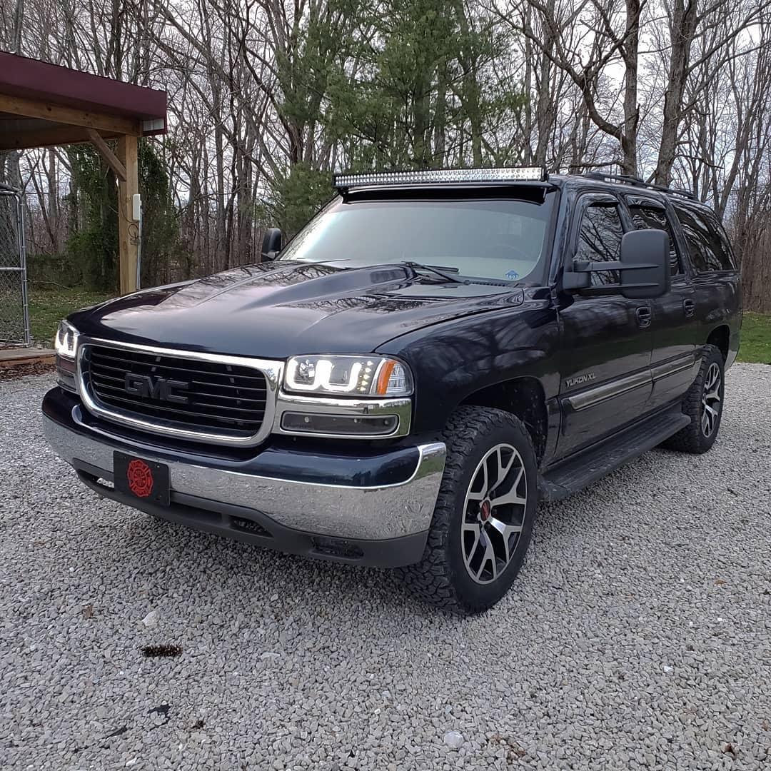

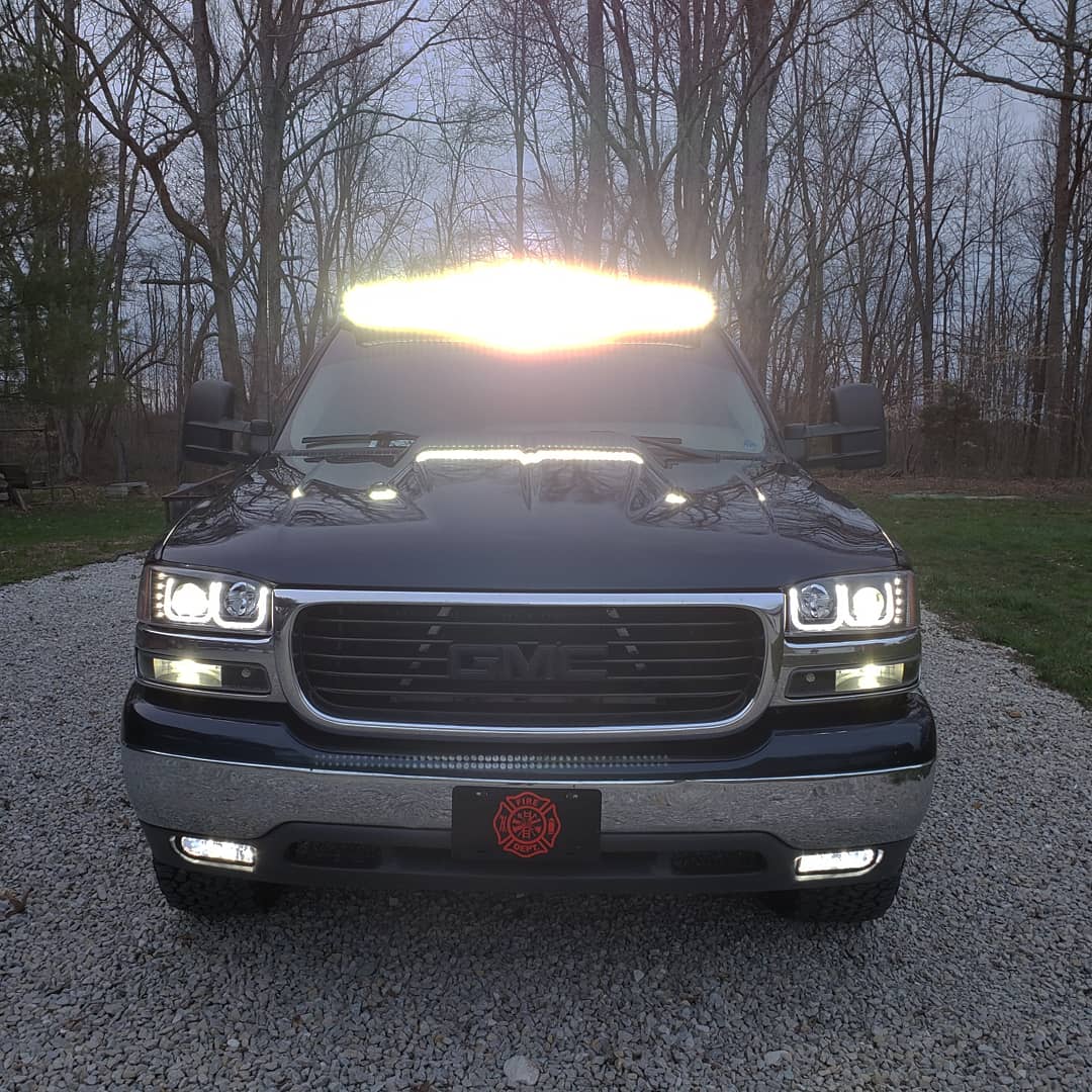

Its been forever since I've posted an update, so here's a more current picture. I've added a 52 inch curved lightbar, and added a custom toggle in the dash for that. I've also ditched the halos and went with a U-Bar style headlight. I replaced my shit bulbs (low/high/fog) with led bulbs from headlight experts which made a huge difference in visibility, however leave a lot to be desired for the $300 I spent for the kit.
I'm also going to replace the fog lights entirely with 7inch led bars on each side. I'm going to wire them in with standard wiring so I can use my existing button. I've done the 6-high mod so I'll be able to run them regardless of what beam I'm using. I already have the lightbars and wiring adapters for a smooth plug and play install, I'm just waiting for this damn rain/snow to stop and a day off. IMG_20180331_200903_857.jpg
