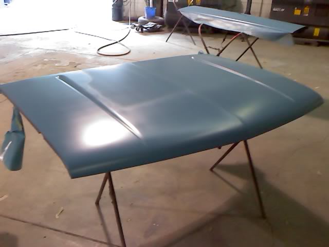

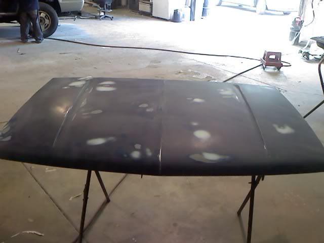

FINALLY GOT EVERYTHING TOGETHER AND BROUGHT IT INTO THE SHOP AND STARTED MY TEAR DOWN AND BODYWORK HERES PICS AS I GO. PROBALLY WONT BE DONE UNTIL THE END OF THE MONTH

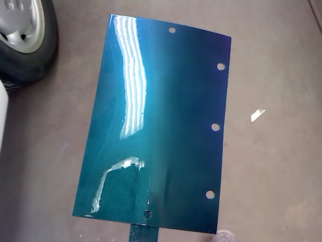

CHAMELEON PAINT :)
SHAVED ROOF RACK
PAINTING REAR/FRONT BUMPER AND ALL HANDLES/MIRRORS
RIGHT AFTER PAINT MY HOMIE IS DOING THE SEATS/HEADLINER/DOORS,PILLARS,SUB BOX AND AMP RACK ALL IN BLUE LEATHER AND BLUE SUEDE

lets just say, thank god i paint myself and i found the SICKEST price on the paint. and they spilled like 3 ounces when they shipped it to me and i took pics of the box with paint on it and they are sending me a whole nother gallon kit for free hahahahaha :)

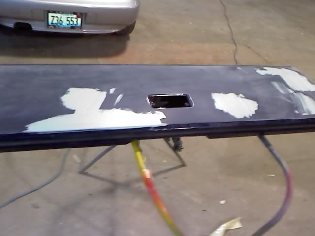

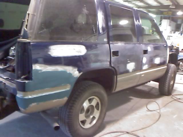

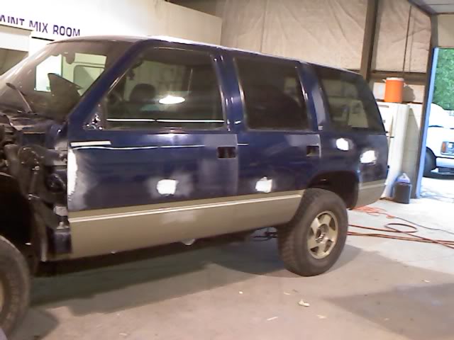

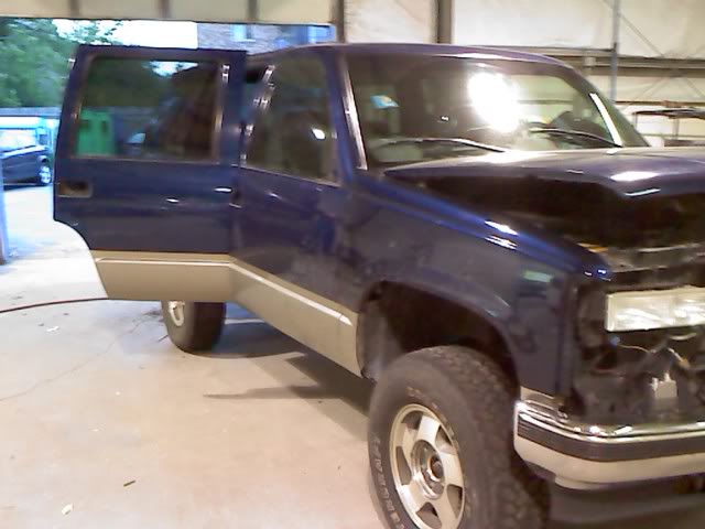

but all body work is being done by me because the bodymen are lazy and like to use the d.a. sander and i want my shit strait as it was brand new on the lot so im hand blocking the whole truck. i had my body man shave the roof rack and do one big crease besides that its all done by me personally
heres more updates from today comin together pretty good so far
and if ur wondering why the primer is blue its because i tint the last coat as a guide coat for blocking

i only shaved the roof rack and the front bumper moulding and license plate holes, i got too much into the truck and dont feel like buying poppers for the doors plus its going forsale when its done anyhow
but no im painting the whole truck i just was getting the bodywork and what im blocking in primer
and the colors above is all the same card just different angles and the purple actually looks very nice and vibrant in the sun thats why i liked it :) but the main color is the teal blue
also im painting all the door handles to go for that new look and also painting around my new grill and just leaving the center bars chrome the only chrome on the truck will be the rims and the center of the grill everything else is getting painted

well im pickin up a 2 door 81 impala that im doing a fullblown lowrider and gonna look for a 07' bodystyle tahoe at the auctions till i find one good price then do that up
i pretty much finish my projects then sell them then on to the next one, i like to just customize cars once im done its like i dont want it anymore lol
