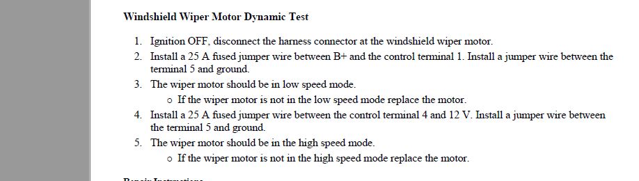

my first guess would be a bad motor, you could confirm with a tech2, if you don't have access to a tech2 a shop is going to charge you anywhere from $80-110 to diagnose the problem, a new wiper motor is about $150. you may get lucky and get a shop/dealer to apply the diagnostic fee to the repair which would include extra labor for removing the rear plastic trim on the rear hatch to get access the motor, you could save some money and take the plastic cover off your self to access the motor,
if you want to test the motor yourself, this the procedure to test the motor for functionality, if the motor works during the test then the front multiswitch may be defective instead

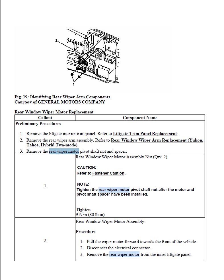

if you test the motor yourself and find it defective this is the procedure to replace it
1. power rear wiper arm to middle of the window position, the remove the nut cap and nut, remove arm and clean the knurls
2. after that refer to the picture I have uploaded
3.
Rear Window Wiper Arm Assembly
Procedure
1. Electrically PARK the rear wiper motor.
2. Place the arm onto the pivot shaft while holding the wiper arm
tab firmly into the park ramp pocket.
3. Secure the nut.
4. Perform a wet wipe and inspect for return to parked position
A
