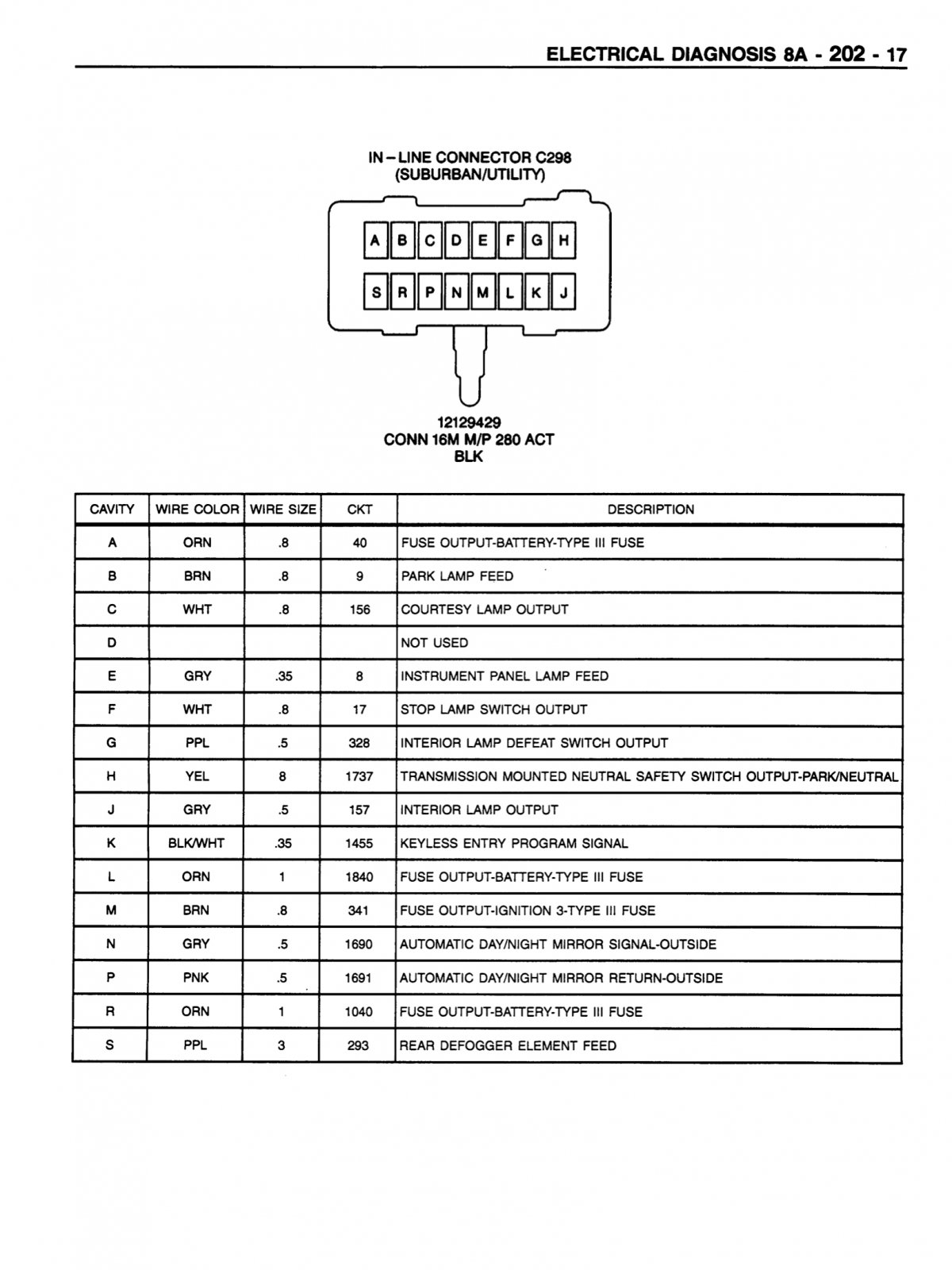

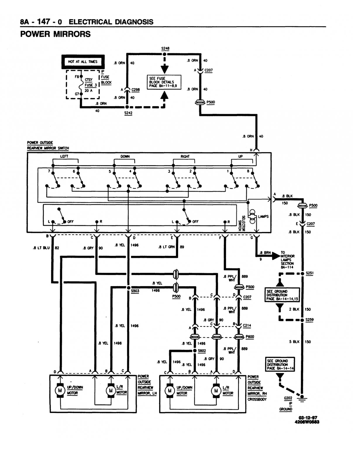

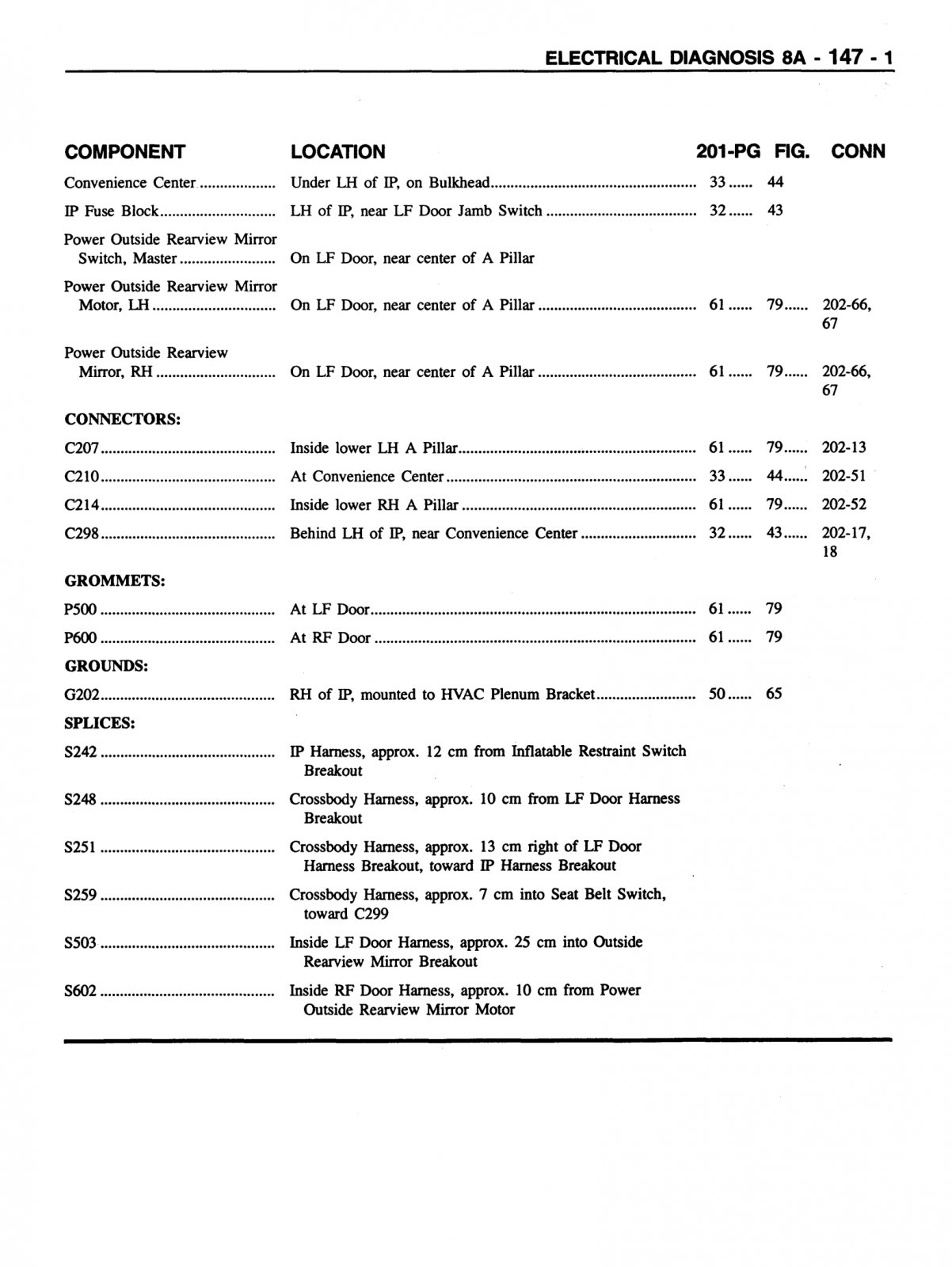

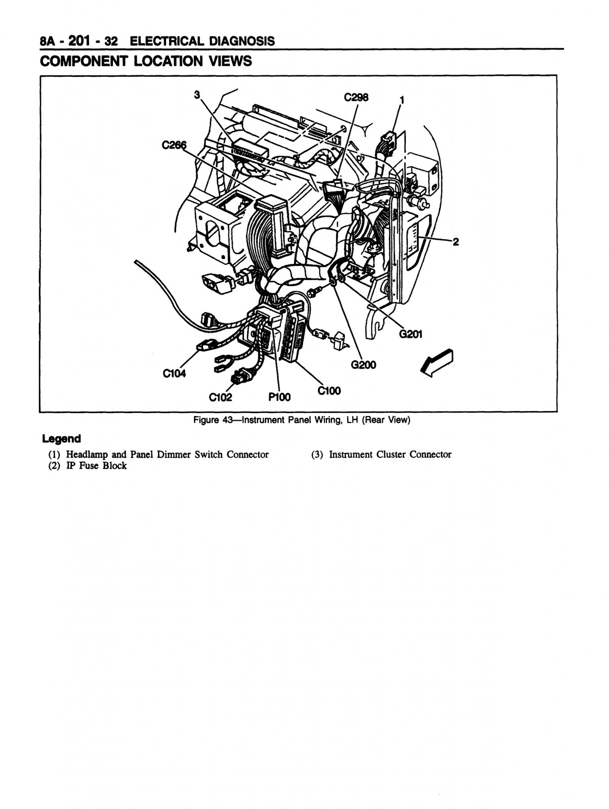

The GM manuals can be downloaded here and have all of the electrical diagrams:
Interior lights and power mirrors are on the same circuit, they split at splice 242. Assuming you have power to fuse #3, maybe the previous owner tapped into a hot wire for radio memory and screwed it up.
