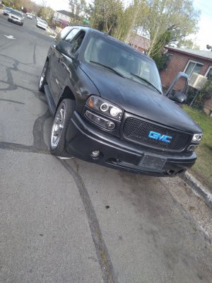

Everything was working fine now I have no power windows no power locks no radio gas thermostat battery oil pressure or transmission temperature gauge what is here your dome lights don't work but the map lights do I've checked all fuses and relays I have power to the driver side window switches driver side power mirror still works passenger side does not
Diagnostic port does not work
Information center says driver unknown and when I turn the vehicle back off I sometimes get odd codes numbers or just random pixels
04 Denali XL
I've been troubleshooting this for a day-and-a-half any advice would be greatly appreciated I do have an after-market radio that I've completely removed and continue to have the same
