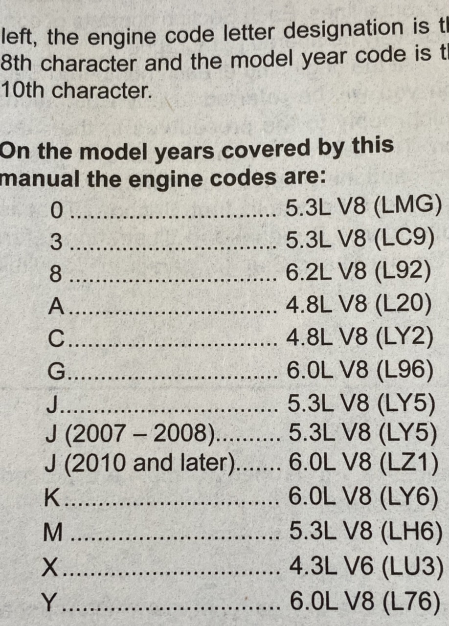

These codes only applies to 2007-2014 model years.
Count in 8 from the left and that will give you the engine code.
And 10th in is model year.

Yes, but my 8th digit is "F" which isn't on your list. My 10th digit is "C" I think it's an old list.
Sent from my SM-G930V using Tapatalk
doesn't cover L94 "F", the torque specs you listed the other day are off some, I know some of the oil pan bolts alone take a lot more torque than what was listed and brake caliper brackets for another
Yeah...I was just looking into it more closely and found that it’s not a good table. Will definitely not be using it. ;)
