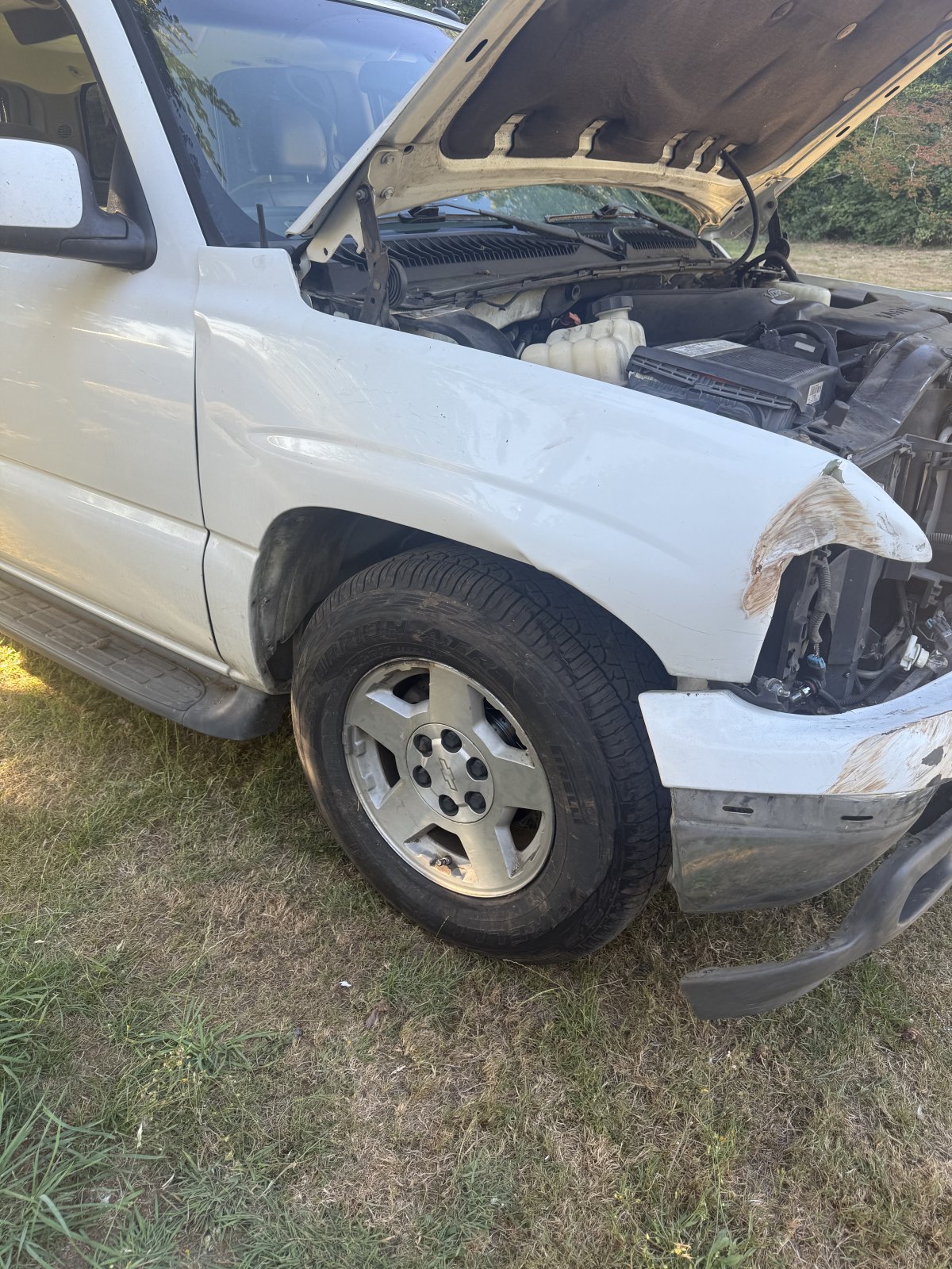

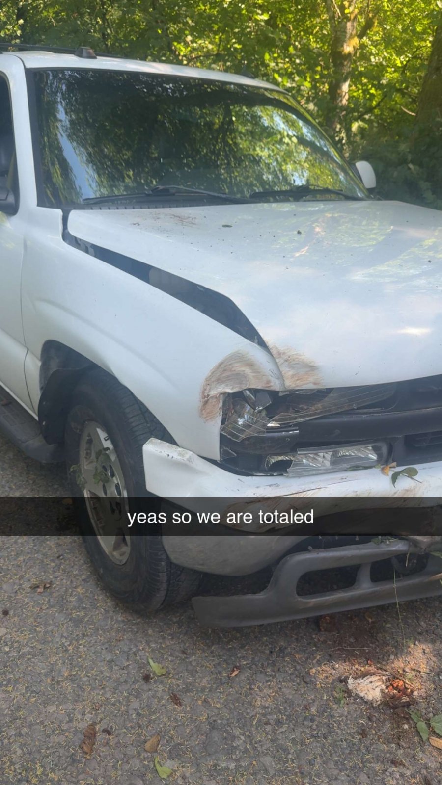

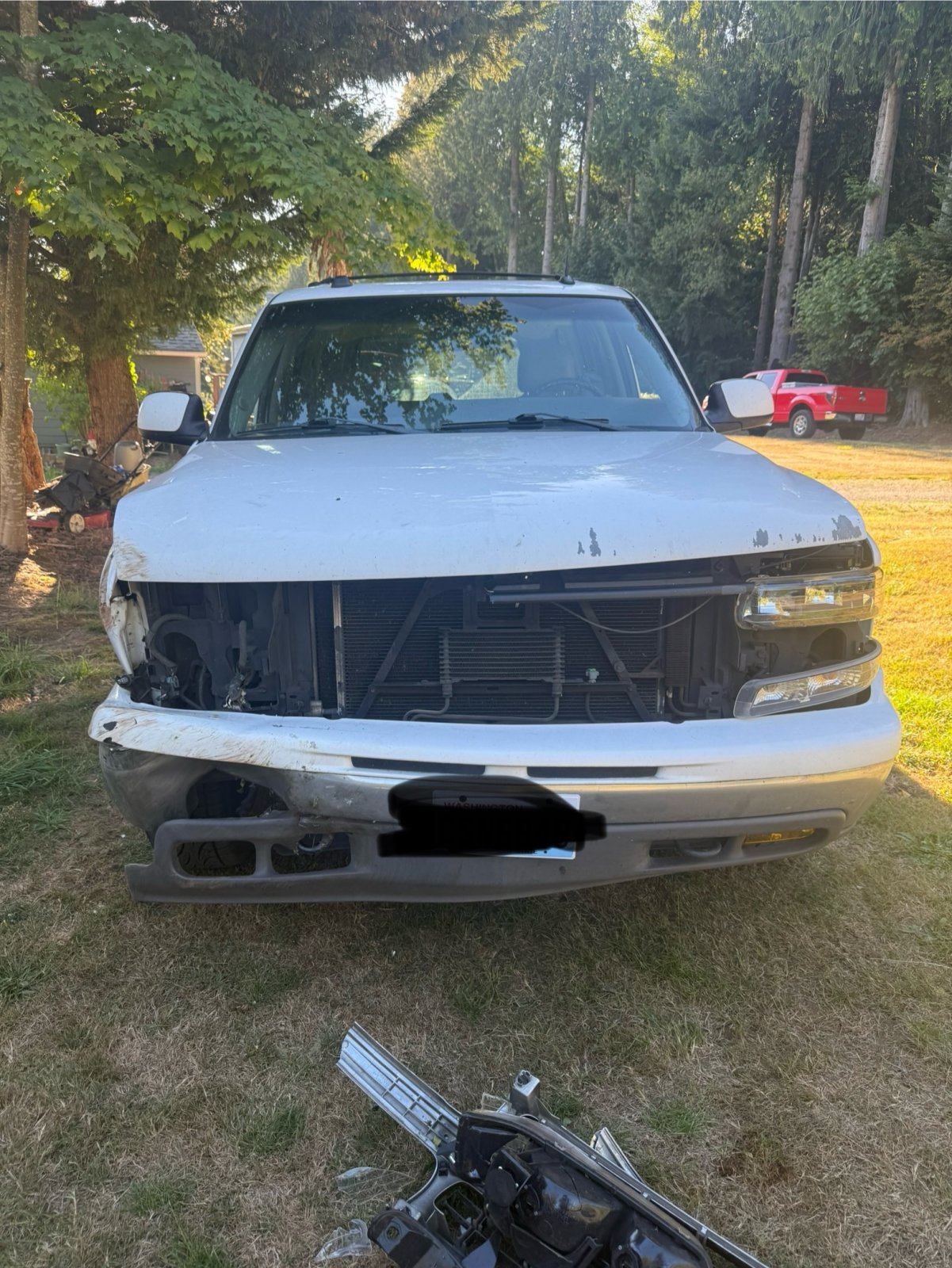

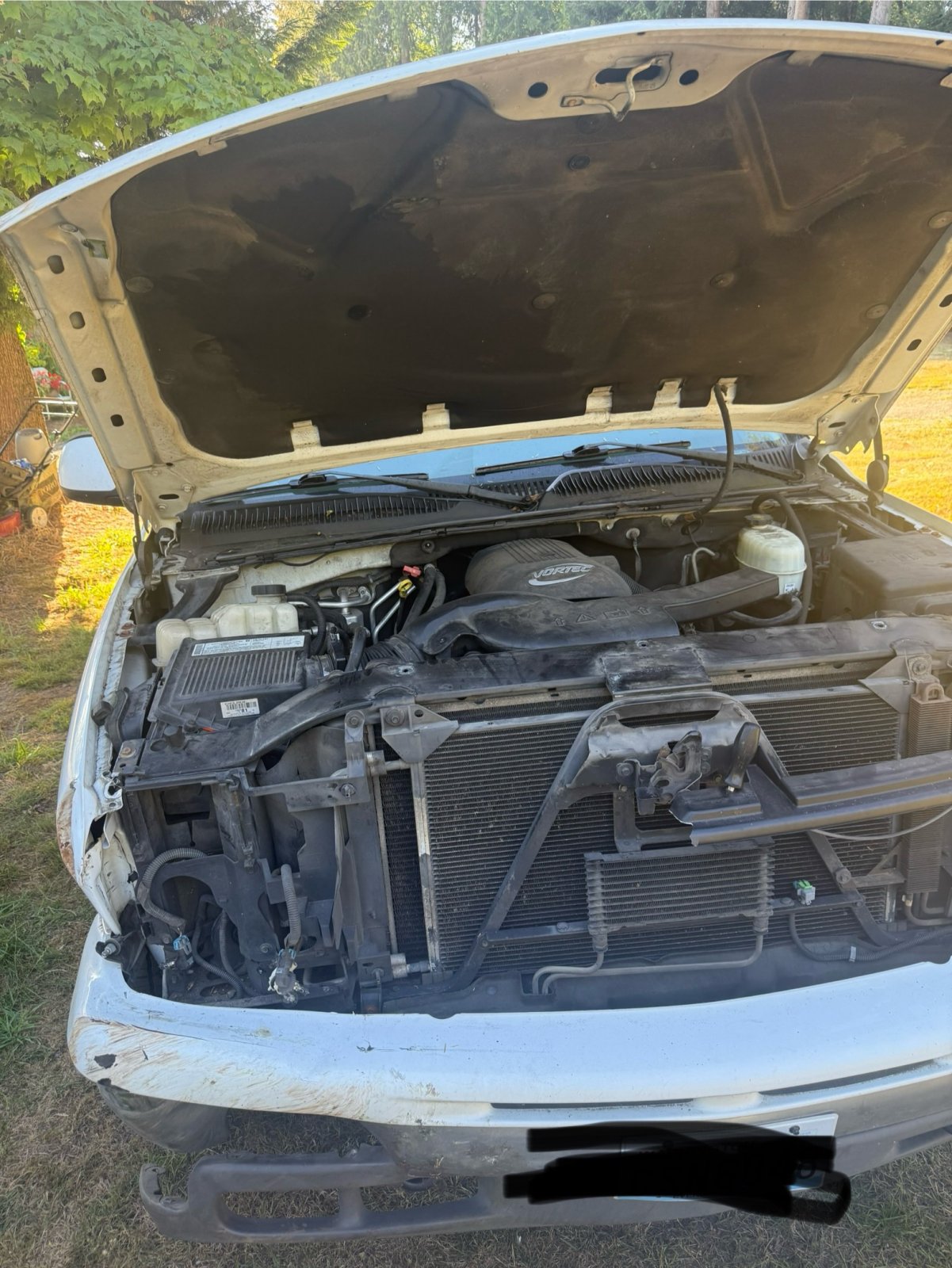

I had a frontal collision with a tree on a gravel driveway going 30-35 if i remember correctly and the front of my tahoe is messed up towards passenger fender, headlights shattered and airbag went off on steering wheel, luckily it drives but i need replacement parts for exterior and i want to know what parts and interchangeable from say a similar year silverado or yukon, and similar gmc models i would need a new bumper, fender, grill, and steering wheel, and hood but that’s all i can think of at the moment. Picture attached but doesn’t show much
edit; not totaled like image says it was just my first impression.
i’m lookin for interchangeable parts for facebook part outs as i don’t have money to order new, so im looking to get insight on what i can actually pick parts off of
edit; added pictures that show complete damage

The lower valance will be different because of fog light shape, if you source a Z71. The rest, IIRC, are interchangeable. Other members will chime in.

I found a z71 part out near me that has a bumper, fender, and all the works i need. Would using the bumper from it mean i sacrifice for lights or is it just a different fit?
