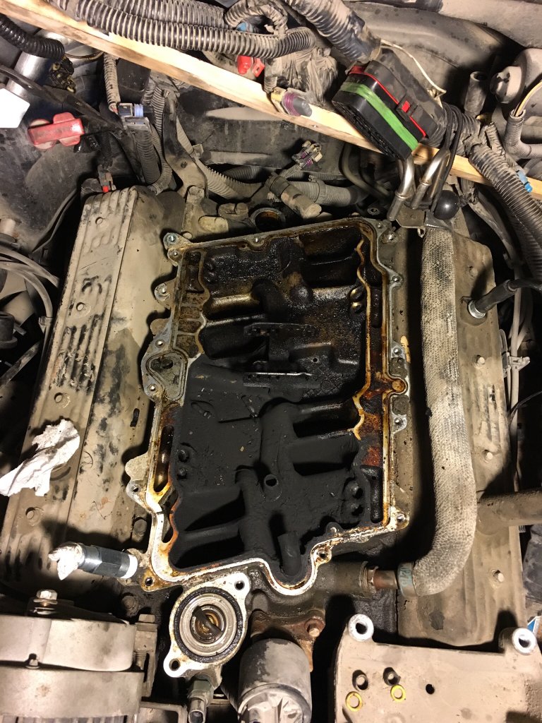

I think I'm doing pretty good. However I have a couple issues. This is it's current state. I'm going to be replacing spider injectors, plugs, wires, and distributor... And everything else that breaks along the way.
Current issues:
-what is the best obd2 program for checking retard for the new distributor?
-How the heck are you supposed to get the ac brace out of the way?
-what the heck is part number 23 called? Mine snapped like a dry twig.
Thanks.

For the CMP retard, I used a BAFX model 34t5 OBD Bluetooth adapter and CarGaugePro or DashCommand android app. I couldn't find one that worked with and iPad (the one advertised by Palmer Performance definitely did not ) so I bought a cheap RCA android tablet from Walmart. For the DashCommand, you have to buy the extra extended PIDs package for your year model.
After flopping the compressor over, you have to loosen the bolts that hold the bracket on and pry it forward to allow the lower intake to be removed. It doesn't have to come out much, but will shift enough. Here's a video that may help, he does the compressor bracket at around 7:00...
You may have done it right, but when the compressor is folded over make sure you remove the AC hoses from the clamp at the alternator. I didn't, snapped a hose and my refrigerant said goodbye.
The vacuum line (23) looks like the one that goes over to the solenoid on the firewall. This controls the heater valve, so when you select the AC temperature dial to "max" it closes the heater valve and shuts off coolant flow to the heater core for better cooling. You could probably get some vacuum line and make it work, just route it away from any direct heat. Or, just splice the breaks together with it.
When you swap the injectors, don't forget the two little o-rings that go on the fuel lines at the firewall.
Hope this helps.

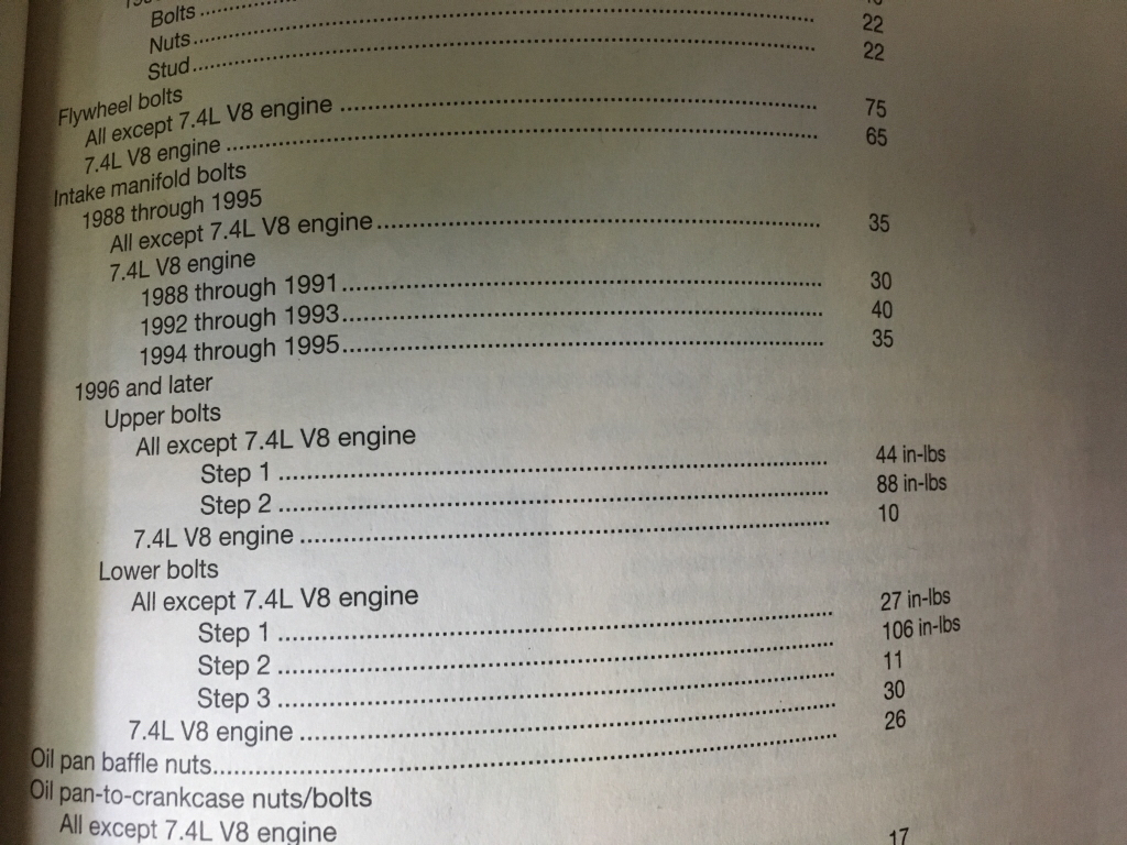

Do you have the torque specs for upper and lower intakes?
U
Mar 12, 2017
37
My Haynes manual has them. I think. Not sure about this upper and lower unless they are talking about the plenum and intake.

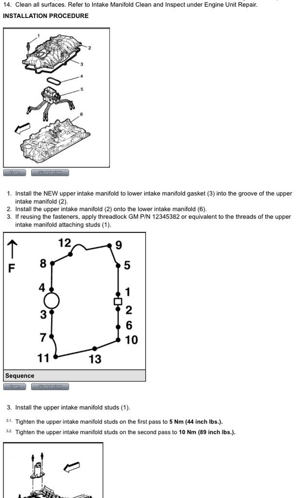

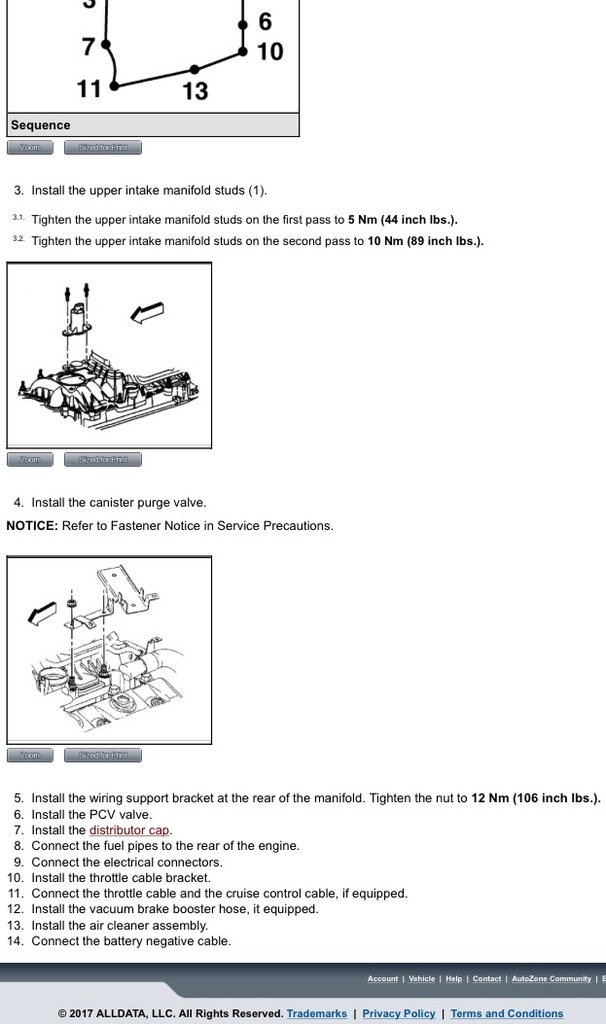

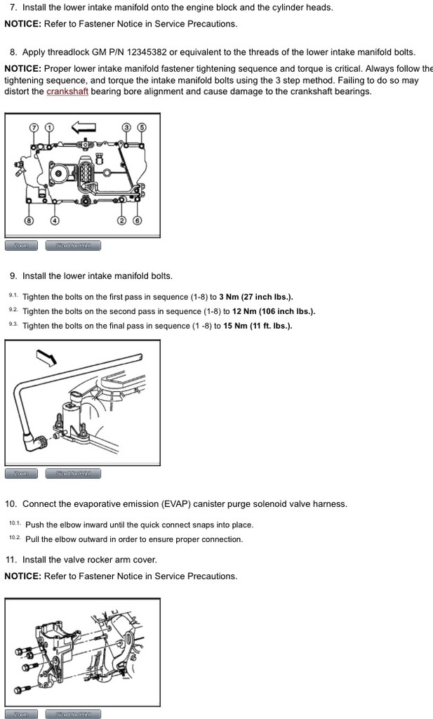

Here are the torque patterns and tightening sequences...
Lower intake
Upper intake
Note that the evap purge solenoid is also 89 in-lbs and requires the thread sealant like the other manifold studs...
Lower intake
Upper intake
Fantastic!
