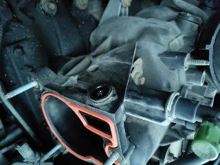

Im wanting to know is there a way i can repair this/ put a fitting in for this? Anyway else dealt with this ? Please help. I want to avoid having to buy a whole new intake manifold. Its a 2004 yukon denali xl V8 engine. There is a hole where the pcv hose was supposed to go on the nipple. I seen others put a fitting on it.
Try a few junkyards near you. Plenty of LS motors laying around. Should cost anywhere from $50-$100, depending if it's complete (injectors, fuel rail etc)or not. They're not known to crack like Ford intakes.

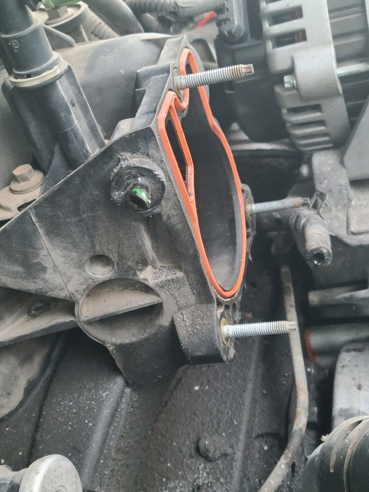

Here is a pic of the nipple that's off but now there is just a hole

Probably cut the stub off flush and thread the hole 1/8 NPT and then screw brass nipple into the manifold. Make sure the nipple is the corret size to fit what ever goes on the nipple.
Yea its just a hole there now
Exactly. You may not be able to get the exact size nipple but you should be able to get close enough and use a band clamp if needed.

Yea we bought a hose barb and had to cut the end shorter...n got jb weld plastic supposed to do glue it in there today. What exactly does that hose do that goes in there?
